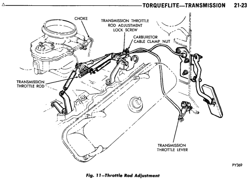

This might help you.
I always start with the pin on the carb at the back of the slot. I like a little firmer and higher rpm shift so I usually end up preloading the linkage a bit at the pin.
