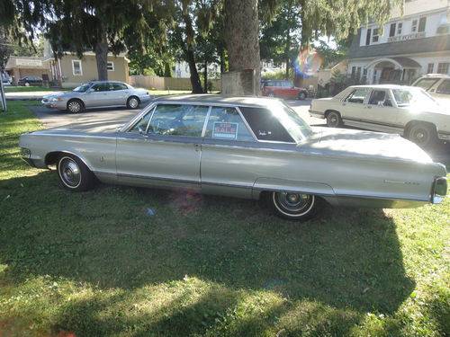

Is this silver overspray or just light reflection on the radiator ?
I'm pretty sure I'm going to want this car, any chance you giving up that contact info? Kidding of course but man I can't wait to see some more of it!
Oh man what a beautiful car, once again confirmed, I am a slab guy!
I'm not, but yeah I'll agree that car is definitely a looker, very nice indeed! That side profile shot is magnificent.
I've seen it a thousand times but each time I see a 2 door with that one loooooooooooong rear quarter stamping, it boggles my mind.
Yes , it does ........whats the length of the quarter ? 10 ft?

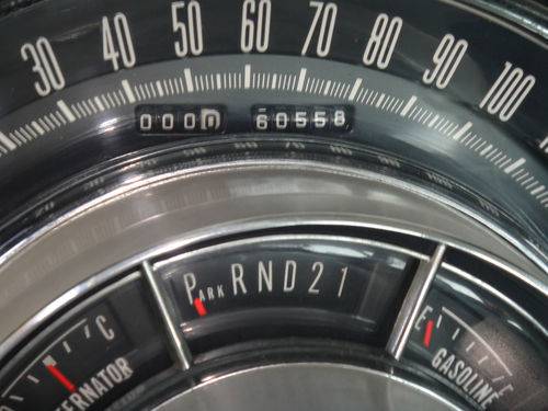

Don't want to start a rucus or burst your bubble, but the misalignment of the digits in the odometer picture, tells me that car has rolled the odo over at least once. So unless your seller has maintenace receipts that track the mileage of the car, as good as this car looks in the pictures, I would proceed on the basis of the car having 160k on it and not 60.

I have heard that story for years, but only repeated from person to person over at toolbox or cup or coffee. Does anyone have any documented proof concerning the odometer, or is this just an old wives tale. I have seen odometers that looked like that for as long as I can remember, even when the cars were new. In fact I haave owned cars that were perfectly straight at 10000 miles, crooked at 12000 miles then straight again at 13000.... By the way, the rear quarter is 102 inches from the back of the door to the end over the back bumper.

I would disagree. The odo reads 60xxx. So the leading 6 has just moved into position when the car rolled over 59999. When it turns 61000 the 6 will likely nudge into line. That how just about every mechanical odometer in any car I owned behaved.
