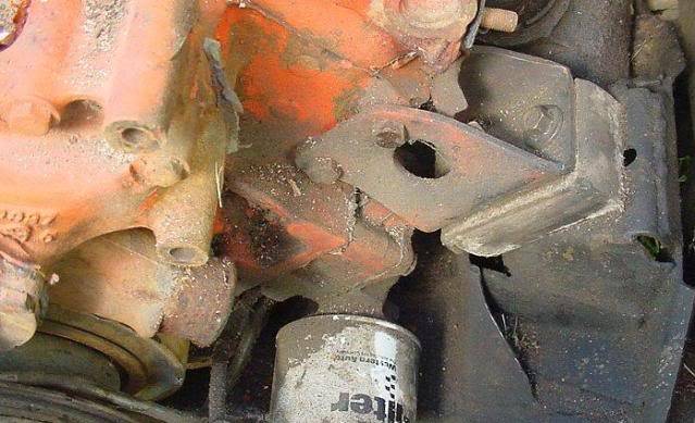

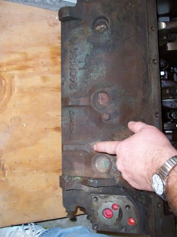

Both mounts might have to be fabricated. On the BB '65's they were VERY similar to the BB Dart mount in that they bolt to the front ear AND around to the front of the block where the boss is tapped for two bolts. Some BB block don't have this boss cast into the block. You would have to check yours. To make mounts that bolt to the factory ears would be extremely difficult due to the location of the steering box.
I am not totally sure if the front sub frame was the same from the SB to BB so i hope someone chimes in.
The '65 was a one year only in where the steering box is and other things were located making it very tough to know if other year C-body parts interchange.
I have a BB '65 with a 361 if you would like pics. ( BTW that pic above is from a Dart and not my '65 )

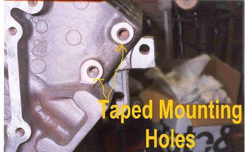

Found a pic of the Tapped holes.
Also learned the the back ear was cut off on the BB darts to clear the steering box. . I will have to look at my car and check.
Also the '65 C body drivers BB mount was the one used on the BB darts (not hemi), no word on the passenger side.
