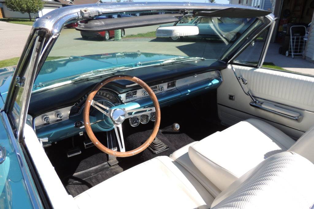

@300rag .. is your '65 a console car too? ads say all 65 300's had consoles - right or wrong?
Looks like the actual shifter knob that made it to the cars is different in the ads.
And there's this "performance gauge" .. my old Newp has the console but I thought that gauge was a clock. apparently not. BTW, anybody with good steering wheel .. mines had better days.
sorry boss .. "getting old" here. forgot you had a 4 speed ... and for good measure i can't read either: "1965 Chrysler 300 convertible 413/4 speed" :-)
seriously cool car!

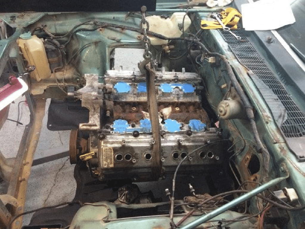

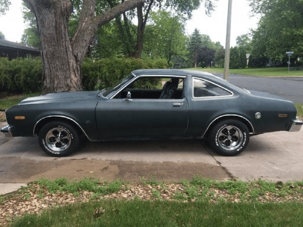

5.7 Hemi Swap in 79 Aspen 4 speed
other than the guy who basically grafted a Mirada/Modern Hemi car together (BIG job, well done), didnt see anybody going more "pedestrian" with their FMJ Hemi swa- .. cept this one.
Dunno how it turned out though
still limping along on this one.
went with front disc brakes (69-72 vintage). fixed driver seat. everything but the clock seems to work. paint cannot buff out, still working on some metal patches ... looking for "Chrysler" block letters between the tailights tho...

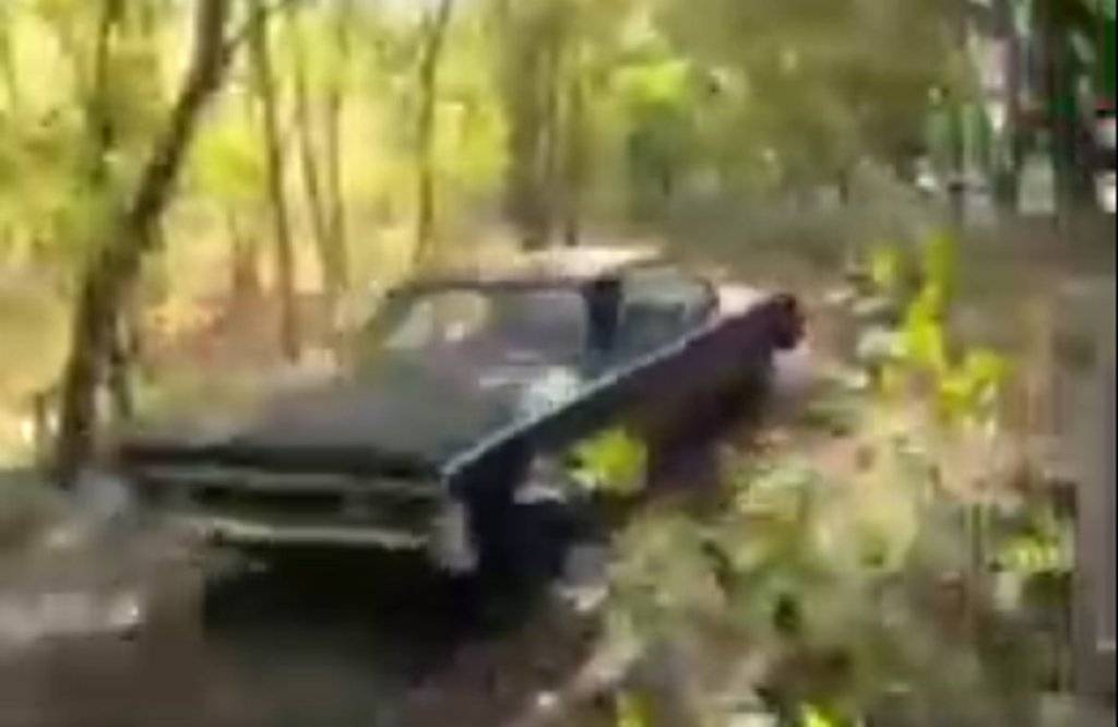

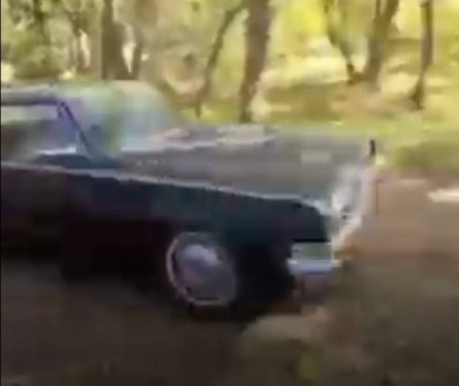

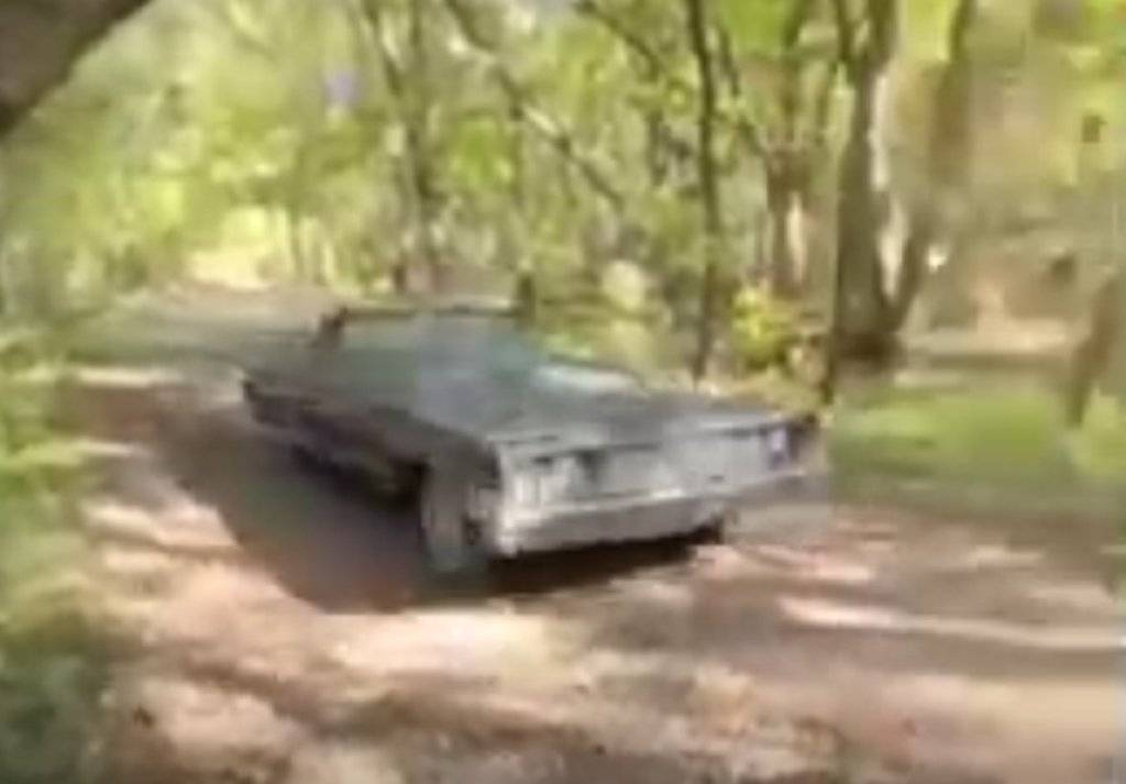

got the 383-4V running pretty good (poor quality MP4 of it running around un-registrered on my buddy's "back forty" on a shakedown run -- 40 mph is all we can do back there). Should be ready for primetime next summer.

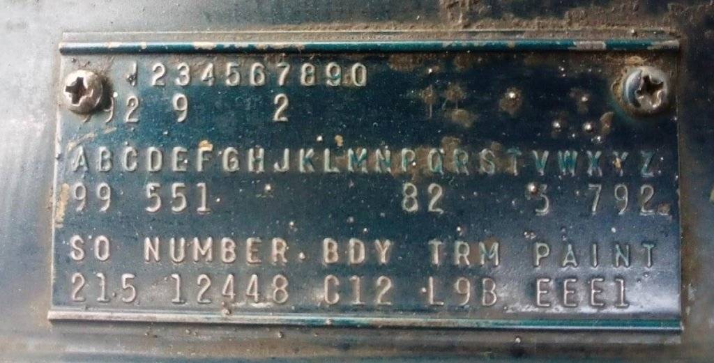

I have decoded this one accurately I believe .. but curious to know what any of you think about ONE thing: what engine do you decode was in this old '65 Newp at build date (Feb 1965)?
appreciate anyone's help on the engine decode you come up with... thanks in advance in any event.

Good Evening
The second line of the fender tag (A-Z)
AB=99 Standard Engine w/PCV System (383 -2V)
I see that your car was scheduled for 15 Feb. Mine was scheduled 01 Feb.

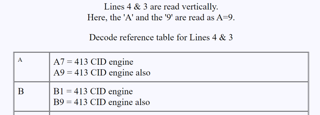

What do you guys make of this ... d '65 300L tag decoded as an example of how to read the '65 data plates.
Same AB 99 means 413 .. how do we know that engine from this plate vs. 383 from '65 Newp plate?
source: 1965 Chrysler Data Tag
