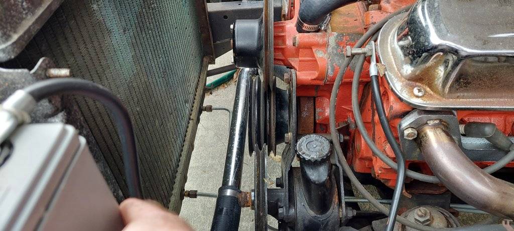

I now have pulleys that  fit, but nothing lines up.
All I can suggest is that you need to get the entire pulley setup from a car with the same engine and options - LA small block with power steering.
Crank, alternator brackets, power steering, water pump with fan spacer. EVERYTHING, ALL FROM THE SAME CAR.
You're dealing with mismatching from different years and options. You're going down the rabbit hole, and you may never surface.

So, you now have pulleys that do not interfere with each other. If you can align the four pulleys, you can be "in business". Looking at the photos, I cannot give exact suggestions, but here goes some home brew engineering!
Your WP pulley could be aligned by using a shim or shims between the hub and the pulley to move it out to align with the next groove in the crank pulley. Then the alternator pulley can be aligned by using the necessary sleeves on the necessary length bolt. Those sleeves can be made from 3/8" black iron pipe. The PS pump can probably be aligned in a similar manner.

Okay, so.
The other PS pump that doesn't fit this bracket lines up with the water pump pulley.
This PS pump lines up with the crank pulley.
This alternator lines up with this crank pulley.
So, last incorrect portion is the water pump pulley. could just shim this one out so alternator is its own belt from the inner crank groove and the water pump and PS pump share the middle groove.

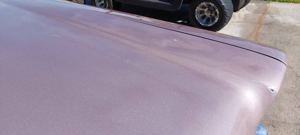

Not great, that's gone through to the coat underneath which is a completely different shade of mauve. I don't think the guy mixed the paint before spraying it.

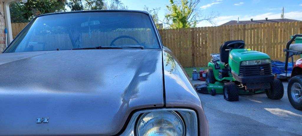

Gee, that paint was put on badly.

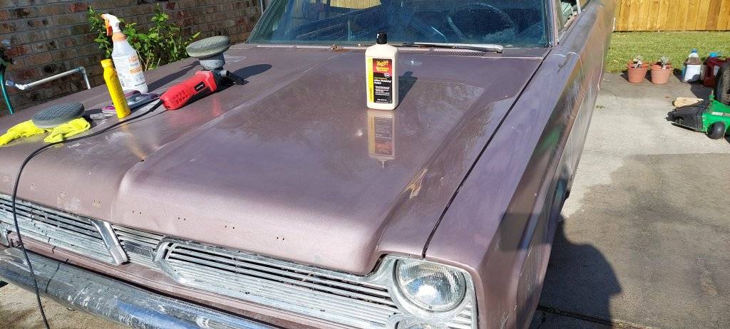

Decided to see if it would hold a gloss, makes the car look a little more cared for.
It's not one single, solid color though. Someone didn't know how to paint metallic paint.
If you machine polish metalic single stage paint you will get ghosting or tiger stripping.

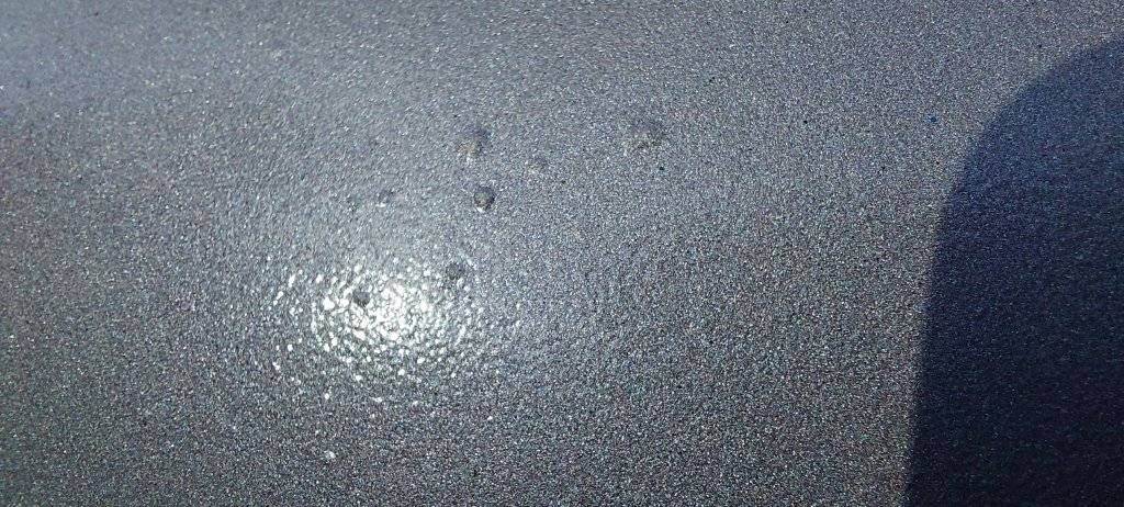

This had all manner of artifacts in and had the texture of a golf ball.
Anything is better than it was.
