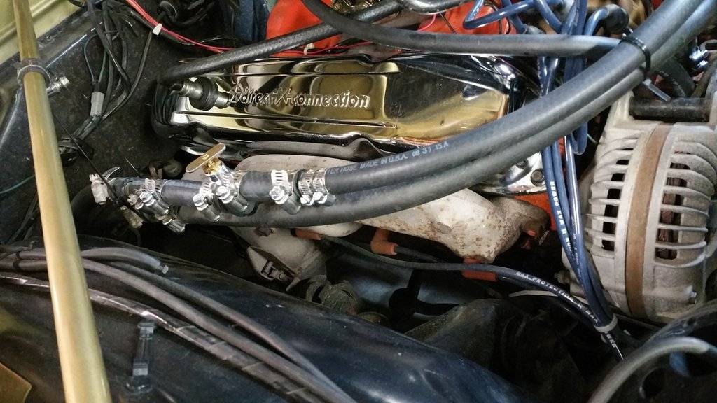

My '66 NY'er has a problem with the heat being on always. The temp control lever moves like it isnt connected to anything. Is the heat temp controlled by a valve on the heat hose lines or is it a door that blocks off the heater core?
There is a homemade valve on the heater hoses near the motor but that is stuck open.
Am i better off using block offs at the water pump or is it a door i can move or wire shut?

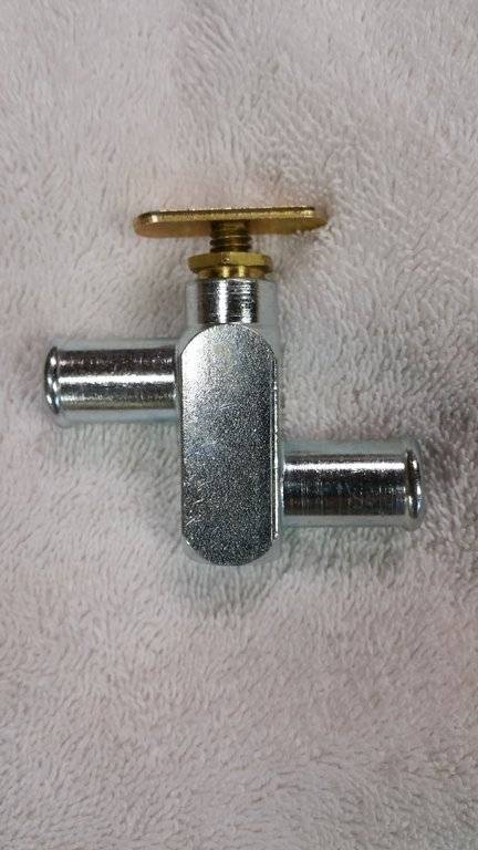

I use one of these under the hood to manually turn on or off the heater core at least for now.
My valve was missing completely when I got the car.
If you use them once in a while they are fine. If you don't ever use it it will eventually freeze up. At least one I used years ago on my Omni glhs did freeze up. I have never had one leak. The one on my Fury works fine. Get a couple just to have a spare as they are cheap enough. They work good.

Gorgeous isn't it? It was temporary that I cobbled together to get the heat off last year. Haven't gotten around to finding the correct vacuum controlled valve. I then found out they are hard to find. Anyone got one for sale?
Thanks for that but mine is vacuum operated. I have no linkage and it is supposed to be under the hood on the passenger fender well. If you look at my pic next to the manual valve is a plugged vacuum line. That is what controls it.

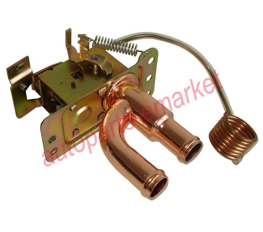

I'm not exactly sure where it mounts at on a 66, but on my 68 the valve is mounted in the firewall on the passenger side below the blower motor. The heater hose goes to it first and then loops up to the heater core. The cable that operates it runs across the top of the heater box to the area above the passengers right foot inside where it controls the valve.
Like this I believe. Inlets and outlets are different sized heater hose and I had to get adapters to cobble it together. You can see the vacuum line going to the valve.

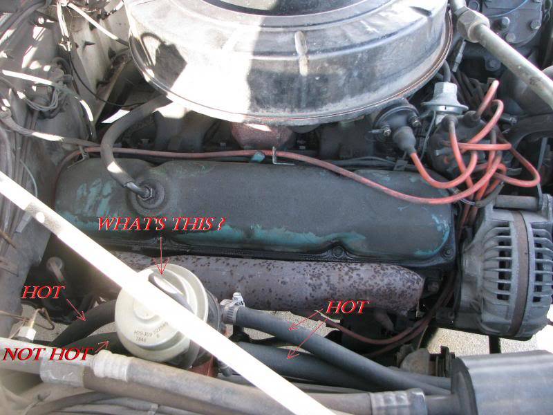

69+ had heater valves mounted on the inner fender.
Pre-69 had heater valves nounted on the lower passenger side of the firewall.
It was controlled by a cable from the dash control that ran to a lever on top of the heater box and then to the heater valve.
The heater valve functioned mostly as an On/Off valve and the lever on top of the heater box that moved a door that modulated the heat.

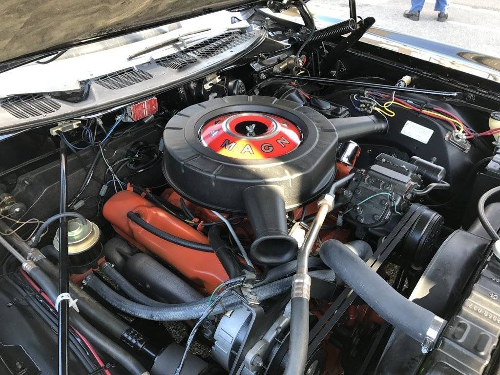

Maybe I am misunderstanding you Stan . Mine is a 69 and had AC unless you are talking about the OP's car which is a 66.
My '66 Newport factory a/c car is as the picture, on the firewall behind the rh exhaust manifold area, same as my 67 Newport, also. Probably the same for '65-'68 factory a/c cars. My '70 Monaco has a vacuum operated valve near the rh fender brace area, as the '69 picture generally indicates. The originals had a big vacuum area on top with the hoses going through a redish lower area.
When I replaced it with one of the smaller reservoir models, at certain vacuum levels the vacuum control in the dash would vibrate as long as the particular vac level was happening. A slight move to more or less heat normally stopped the sound. The smaller vacuum area of the aftermarket valve was apparently the culprit as the larger one had enough damping area to prevent the resonance.
With ANYTHING with rubber seals, always seek out NEW rather than NOS, for the best longevity. The '55 Chevy used a similar valve as the '65-'68 Chryslers did, seems like. The capillary tube was supposed to be "an automatic adjustment" so you wouldn't need to keep moving the lever for "more" or "less" heat for a given valve position, as I understand it.
