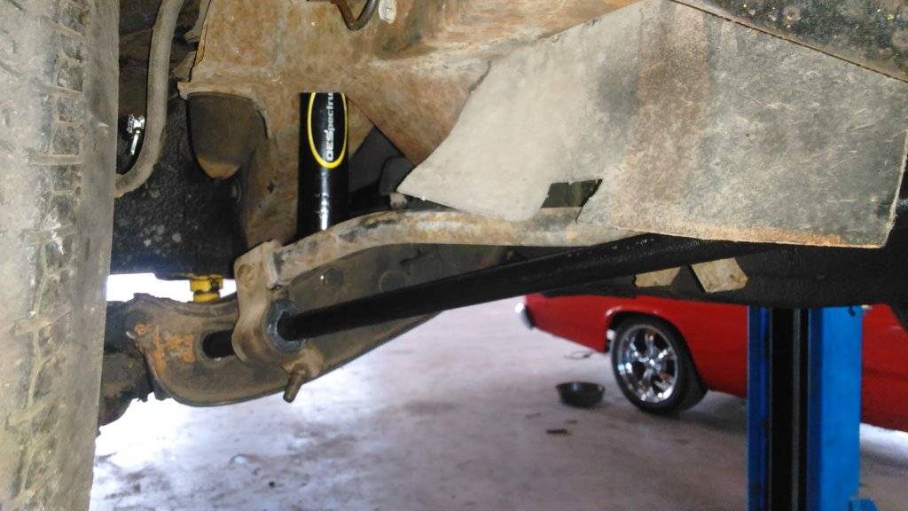

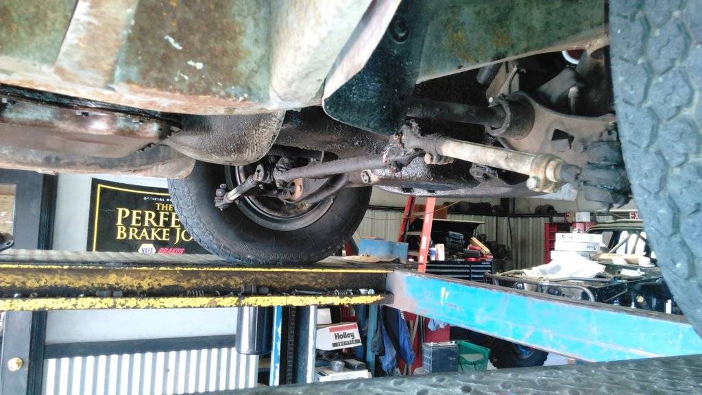

Strut rod and bushings, lower control arm, bushings, sway bar bushings
Got more trust to treat.
Also got new brake drums and rh studs/nuts all around. Car stops much better. Master cylinder conversion next!

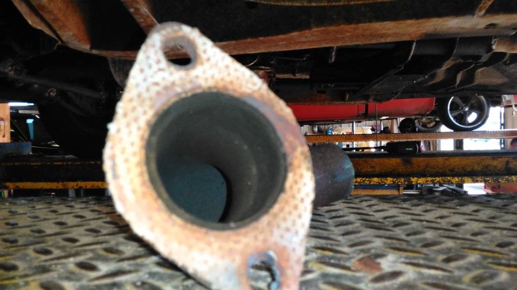

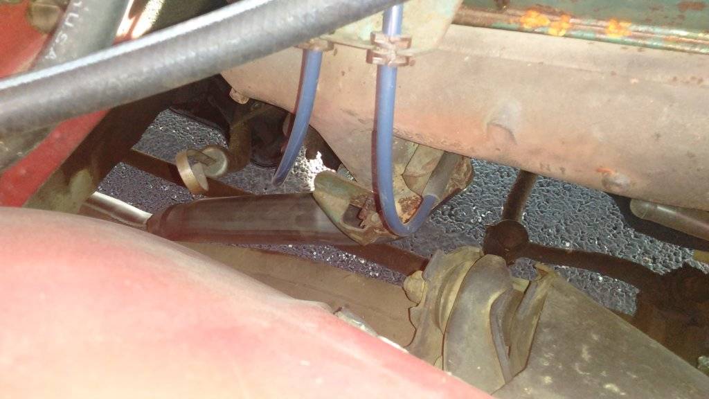

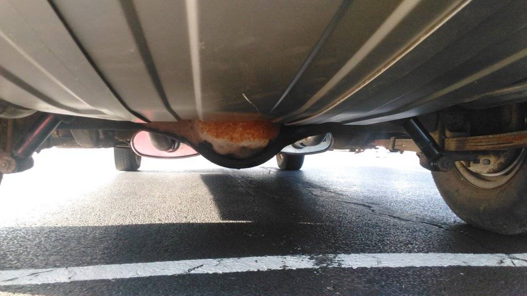

Went to the exhaust shop yesterday to get new duals on the car.
Stopped by this morning, installer recommended I get new flanges and he can build a better system. I agreed.
He was also cool enough to let me shoot some photos of the underside. Lots of work needed.
Old, original flanges...
Some misc photos. Looks like lots of rust to remove and encapsulate.

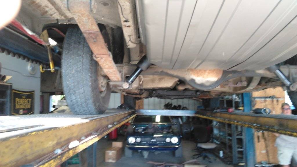

Needs a good pressure washing and some transmission work.

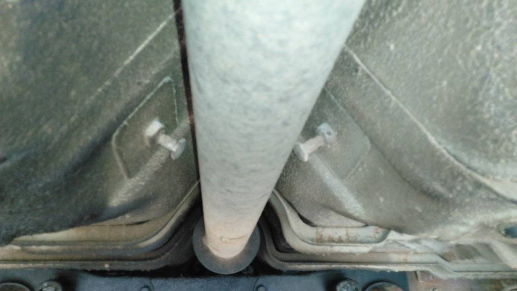

I don't know why the seat belt bolts are installed upside down except to fill the holes. I removed them so I can put in new belts. Discovering this later with the car on pavement would have been a real bad deal. I am happy I don't have to drill and weld in mounts.
After a week we got duals!
Nice and quiet with just the right amount of rumble. No drone!

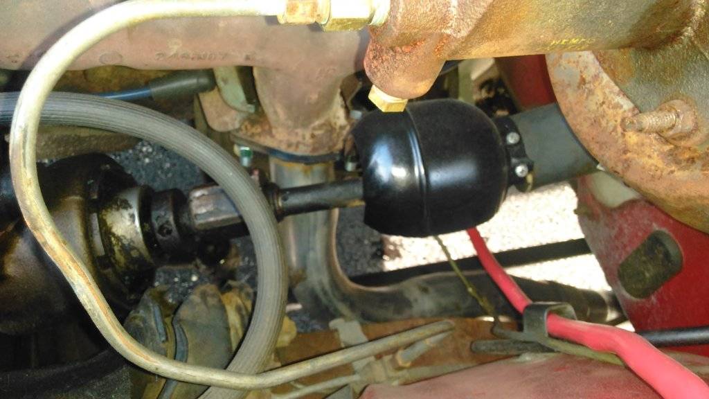

Don't worry the wires clear the pipe by several inches, as does the torsion bar.
Very happy with the results. The inside is so quiet now...and the unleaded gas smell is gone.
Very Nice! I've been thinking about going back with the stock manifolds but the choke flap is totally lunched on my setup....
Don't need it, unless you plan on driving during the winter months.
Told the the fella to cut it out of there. Make it gone. My temp gauge is running lower so I'm guessing there was some slight blockage.

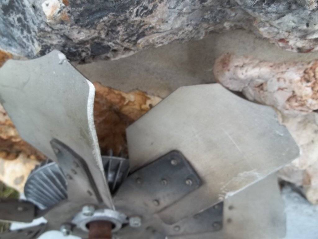

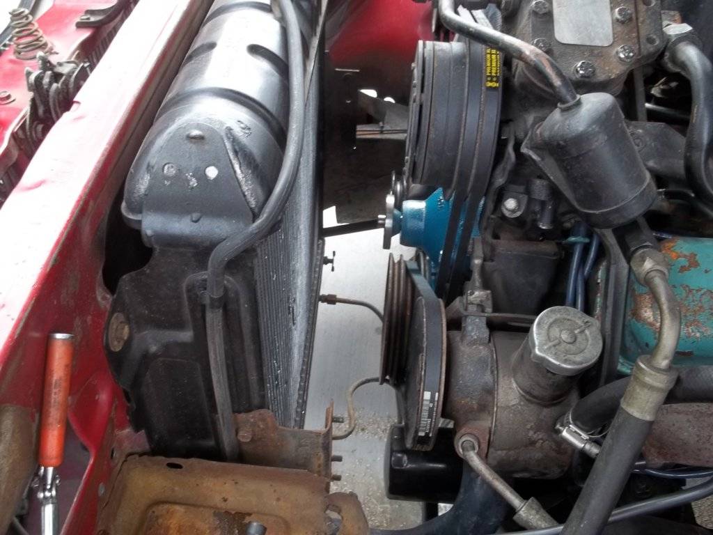

Today was busy thrash session on Red.
I needed to replace the damaged cooling fan.

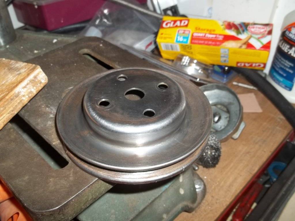

Started by removing the Shroud and fan. The pulley and shroud got dunked in a vat of degreaser, along with the A/C coil bracket and it's attending compressor bracket.

The old wheel barrow makes a good makeshift solvent tank.

Lower shroud coated with Rust bullet and a quick coat of Ford semi gloss black. The upper shroud will be painted tomorrow I hope.

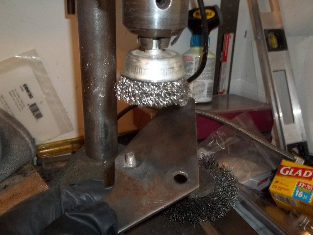

After degreasing, all parts were sprayed with brake cleaner and then wire brushed. Rinsed again with a shot of brake cleaner, then primed and painted with Duplicolor semi gloss black

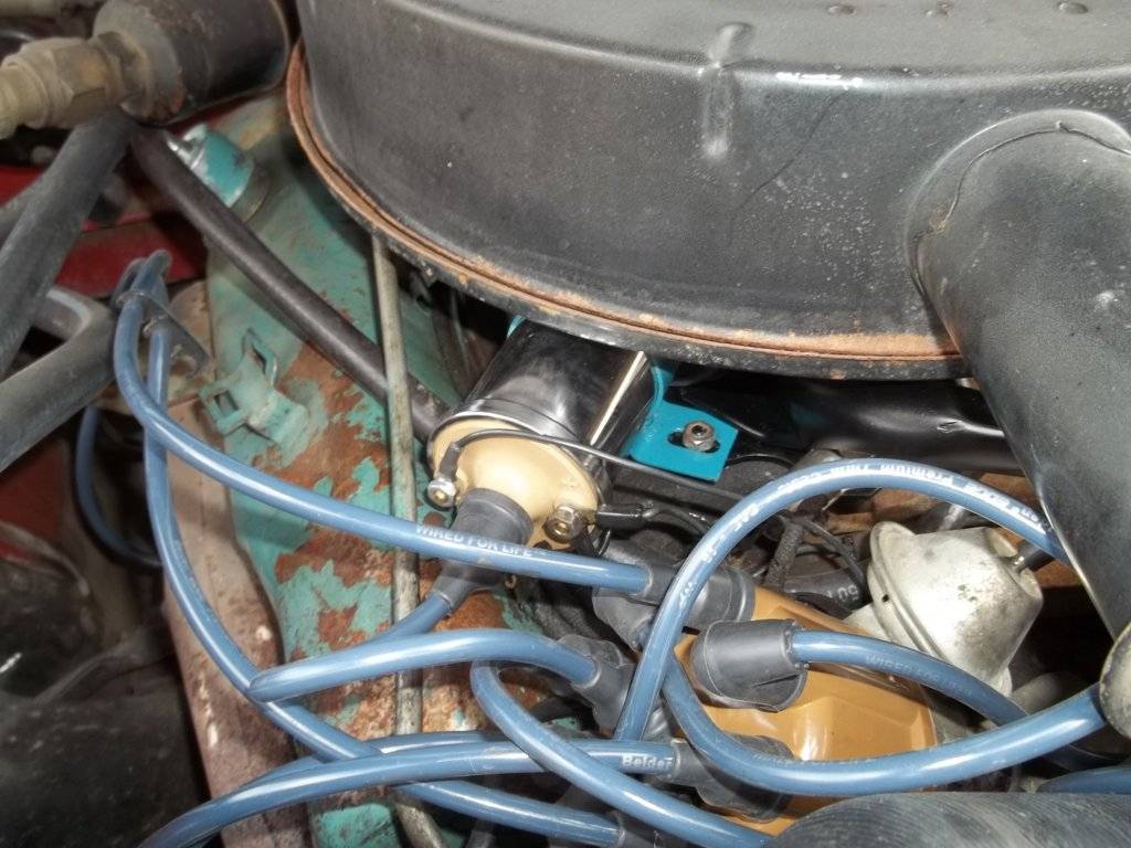

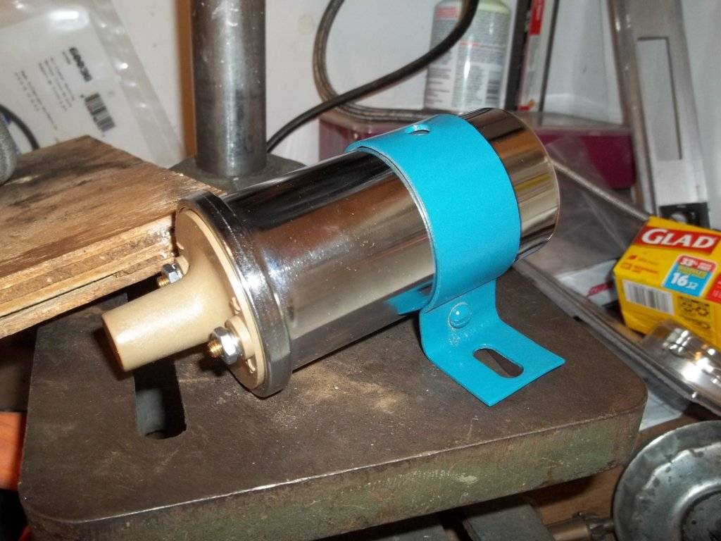

The original coil was just about dead. Leaking oil and a weak orange spark. The bracket was painted Turquoise. Why...?
Bazinga! Echlin chrome hi po coil
Coil bracket and compressor support were washed, degreased, wire brushed, degreased, and primed and painted semi gloss black.

Ran out of time and had to put things together enough for a cruise. New Derale 18 inch fan worked great with the heat index around 101 degrees.
The new coil, snug as a bug. Car seems to start better with it.

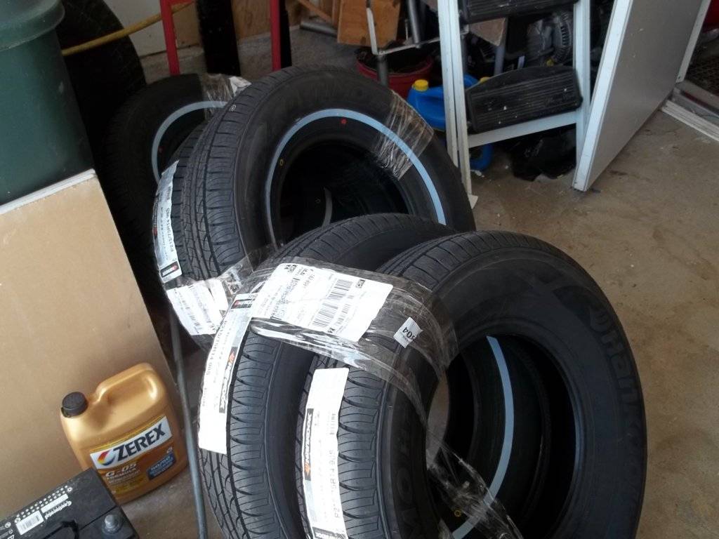

I had to make a VERY adult decision earlier in the week and decided the car was just a bit too "rough" to warrant the polished slots and a set of bigger meats in the rear. Some other work needed to be done first.
I found a good price on 215/75/14 wsw Hankooks on Amazon and ordered in 5 of them. Yes, even the spare will be tossed.
Fedex delivered them today.
The local Pep Boys will install them next week. This takes care of 99% of the serious safety issues the car started with.

Strut rod bushings...Replaced
Lower control arm bushings....Replaced
Sway bar bushings...Replaced
Brake drums..brake shoes look new but drums are thin...Drums replaced, front bearings re packed. Adjuster kits added to rear to replace missing parts Emergency brake cables lubed and tested.

Some good ideas there...wheelbarrow solvent tank and wire brush on a drill press looks like, ive always used a hand drill..p.i.a. Coming along great.
Always wear safety glasses and gloves...shop apron is recommended. If bristles decide to fly out, everything is almost eye level!
I use a different types of brushes depending on what and where I need to get at.
New Hankook H724 tires installed.
Her great ride got a whole lot better.
