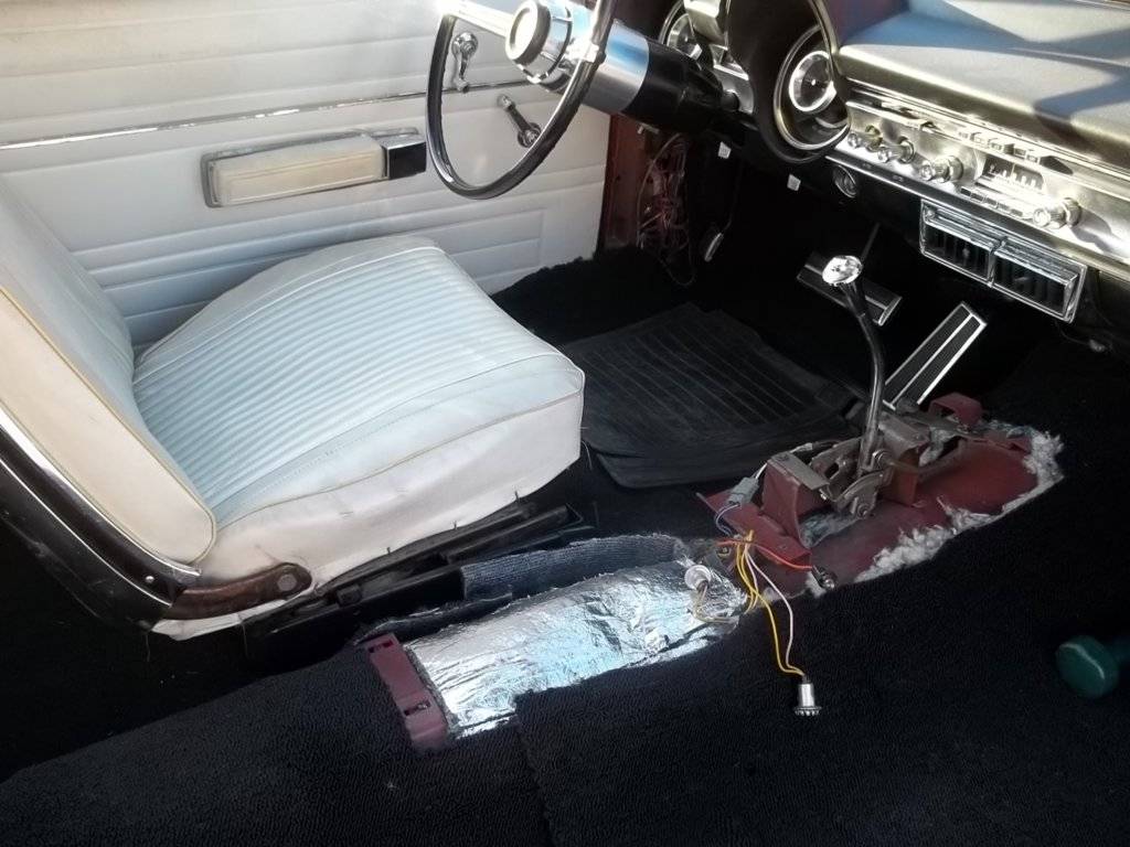

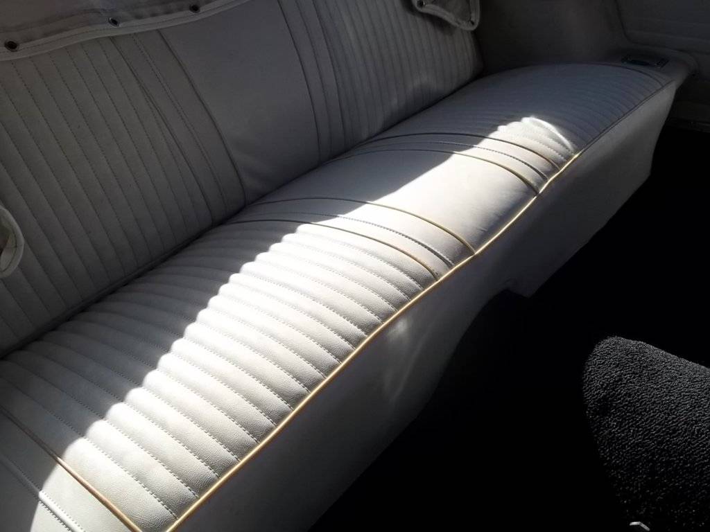

Today I managed to get the rear seat in, trying some insulation under the seat as part of the process.
I have enough insulation left to put a 2nd layer over the center area.

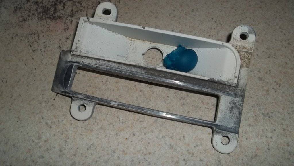

While things were apart, I replaced the map light bulb. And cleaned all the nasty stains off the area no doubt from smoke.

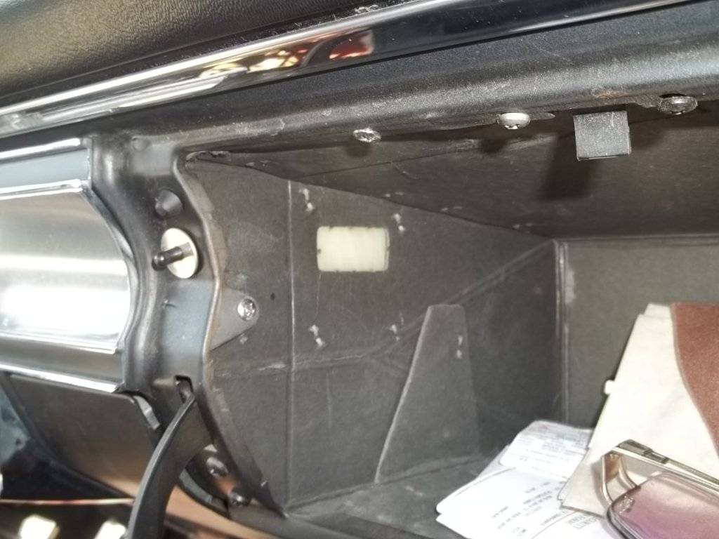

Do I have to take the dash apart to replace the glove box lamp?

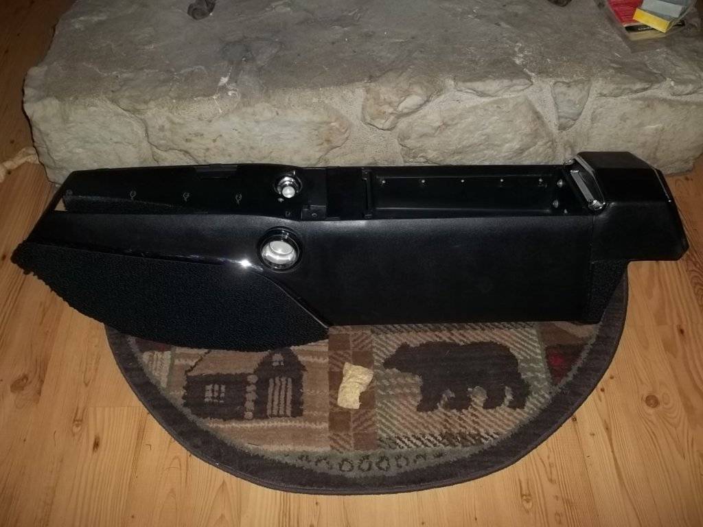

The carpet pieces for the console arrived today and they look great! Time to get started.

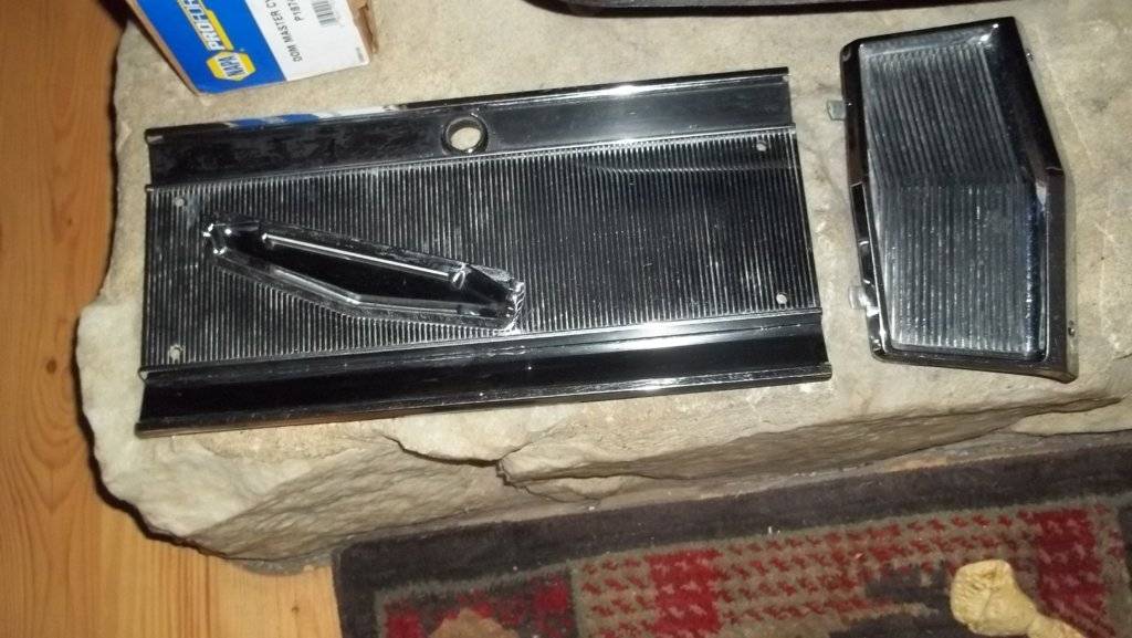

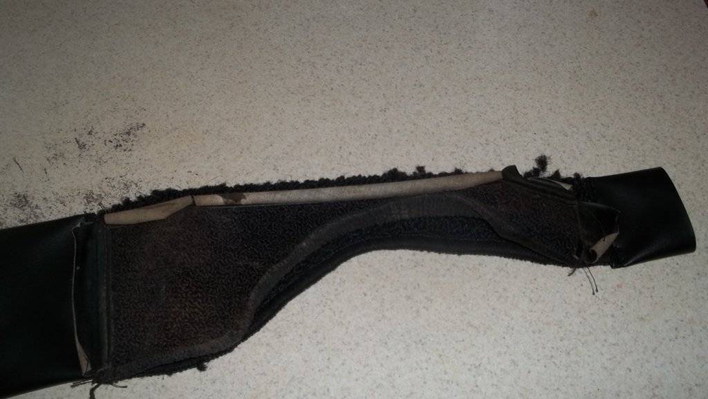

Between honey do projects and such I was able to disembowel the console. Two bags of fasteners later I had all the main pieces strewn throughout the house.
Here's the bad and the ugly...
These two got dunked in very hot soapy water The black painted trim around the shifter had been covered by some cheesy stick on wood grain that had peeled back over time leaving a nasty sticky mess. Goo gone and acetone barely touched it!
Hot water and a stiff bristled brush got the residue off but also took some of the paint. I hope lacquer thinner will remove the remaining paint and I will re-spray it.

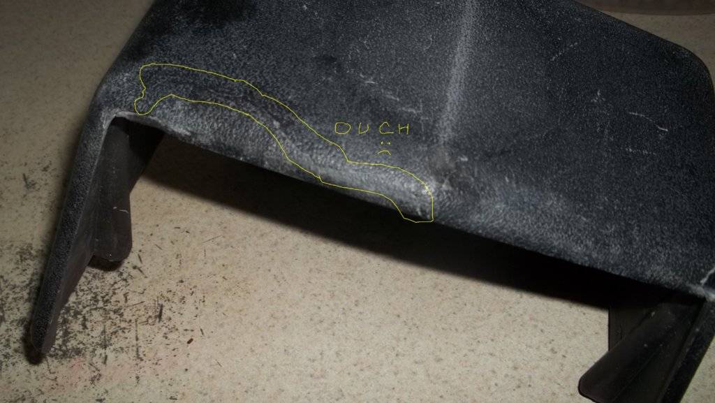

At this point I'm not completely impressed with ACC. While the console sides look accurate, the end piece isn't close.
Original on top of replacement.
I have to dunk the front console piece yet to get the residue off.

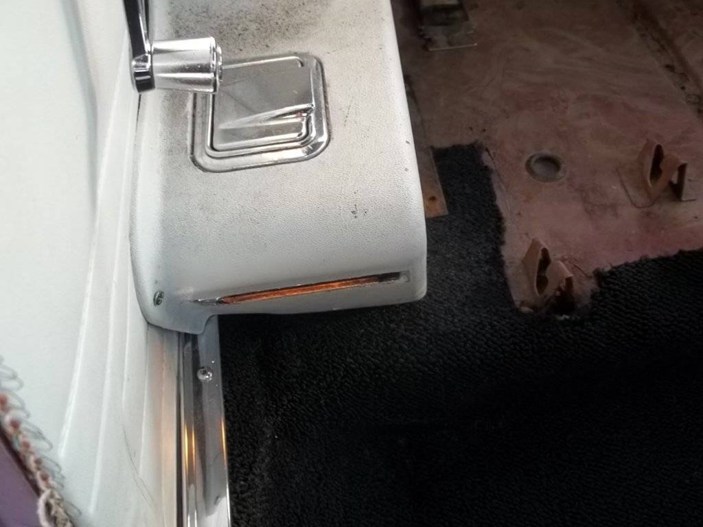

A good day for me today. Got the passenger seat in.
Trimmed the carpet back up front around the kick panels and put in the dimmer switch grommet
Worked on cleaning and rebuilding the console. Started gluing the carpet on the piece of tin for the rear of the console.
After being a bit impressed, my opinion of the console carpet has changed
Carpet for console sides is cut poorly. Drivers side is too short and passenger side wasn't deep enough. I already showed you how off the rear piece is.

You don’t need to remove the dashboard but the glove box door and insert
Don’t be surprised if the insert breaks
They are available on line for about $35
The original insert is as perfect as it can be. So I'll forgo that project for another time, or never. :)

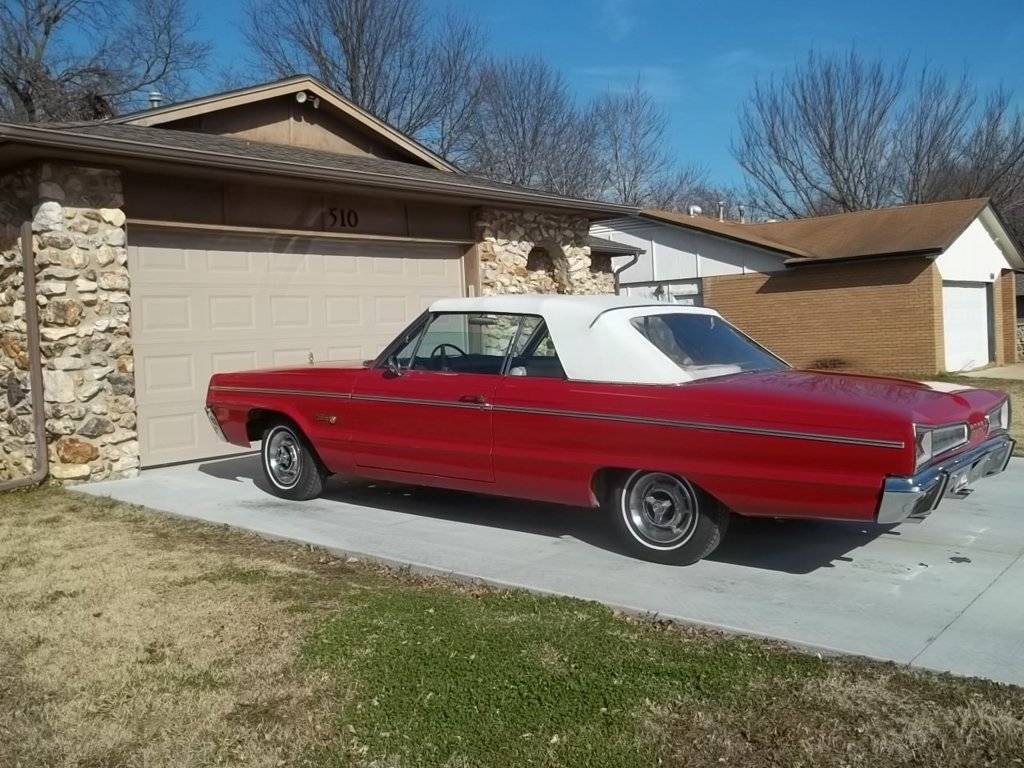

The Thanksgiving storms finally passed and I brought Mz Ruby home for the weekend.

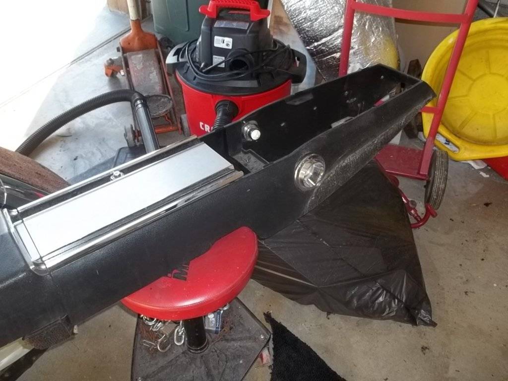

The final trims were made on the carpet.
Kick panels were screwed into place.
The rear piece of the console was painted semi gloss black. I think it needs more gloss The cracks had been epoxied and the carpet glued to its plate and trimmed.
I washed off the dust and crud and shot a couple of photos.
I hope everyone had a good Thanksgiving!
The console base is ready to install.

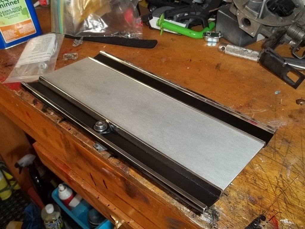

Today, I finished painting the console door. I should be able to install tomorrow.

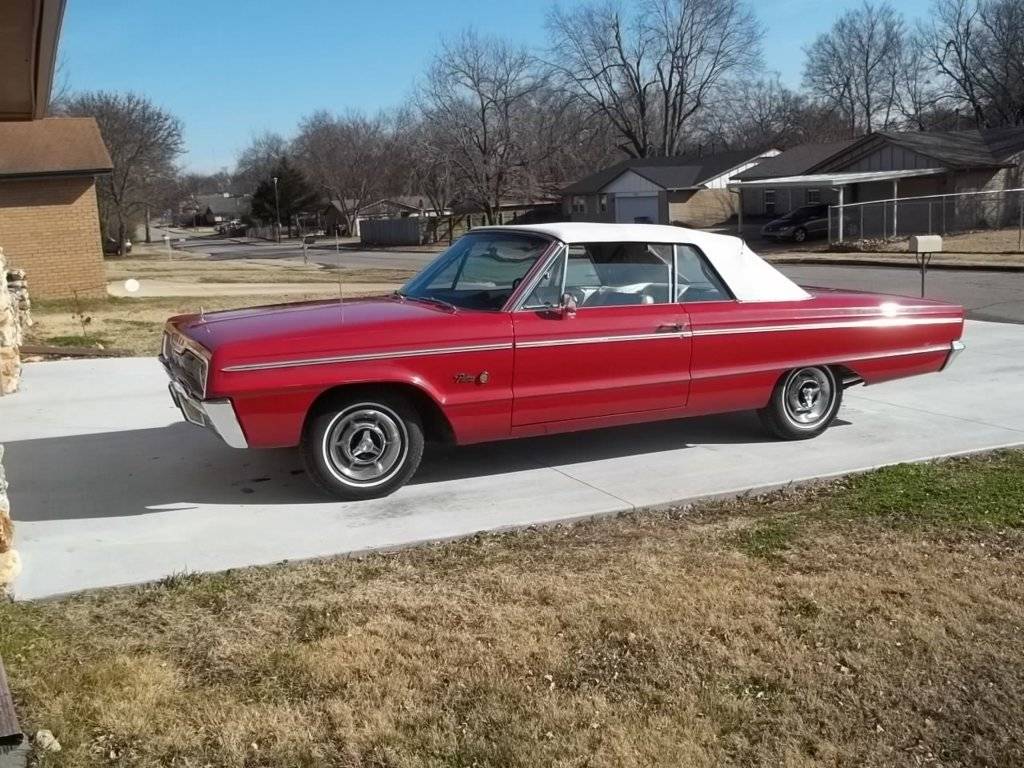

I'd had the battery out because we'd had several mornings below freezing, and the battery spent time in my heated work area.
Today I put the battery in and brought her home for a spell. As always, I snapped a couple of photos. It really is hard to take a bad photo of her, even with the crappy paint.
The wet spots under the car are from my truck. Poor Mr. Drip! He was clean for about 8 months...
