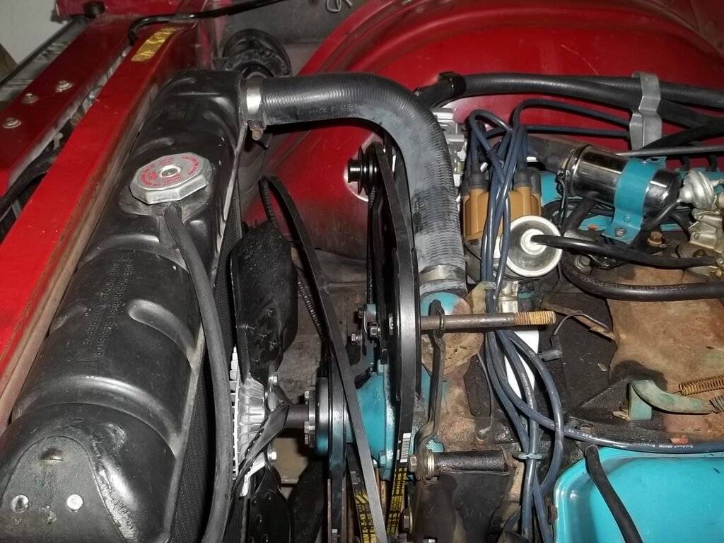

Recently I removed most of the A/C plumbing, but I was able to get serious.
So the A/c compressor went bye-bye and I'm fabricating a delete pulley bracket. This allows me, as time allows, to replace the thermostat and remove and repaint the intake manifold
I used one of the original compressor brackets, turning it around mounting it outside the steering pump bracket and made a 2nd bracket to stiffen things up.
Pics are of the mockup, then the bracket in place.
Tomorrow I'll fabricate a a spacer and get a proper bolt and such.
