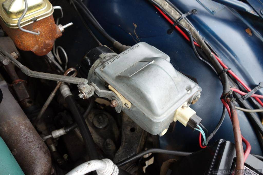

Hi all, i have been working to get my auto pilot working on the 67 Imperial however, i have had no luck, i have rewired it to she shop manual and tested the power swich and brake switch both work fine, i have tested my rewire and i get power to all that i should when i should under the hood. i have had problems with my drive unit, upon disassembly i found a broken gear, the motor had a burned out coil, and the switch and relay contacts had burnt out causing the plastic housing to melt a little. i have repaired the gear, rewound the motor and repaired the switch and relay housing and contacts, all of these work perfectly now, the thing i am now stuck on is the internal wiring of the unit, does anyone know of a repair manual or have any pictures of a unit with the cover off?
any help will be hugely appreciated
attached is a picture of the type of unit i have.
many thanks
Matt

It is such a pain, its a beautifuly designed piece of kit. if you have felt feedback in the pedal i shouldnt think there is much wrong with yours, maybe dirty contacts? or i did have issues with my motor being stiff after i rebuilt it and it sometimes needed a hand to start spinning (maybe a bump in the road could do this?) i disassembled it again applied grease to the armiture where it passes the bearings and made sure the aft bearing was ligned up as central as possible when installed.
