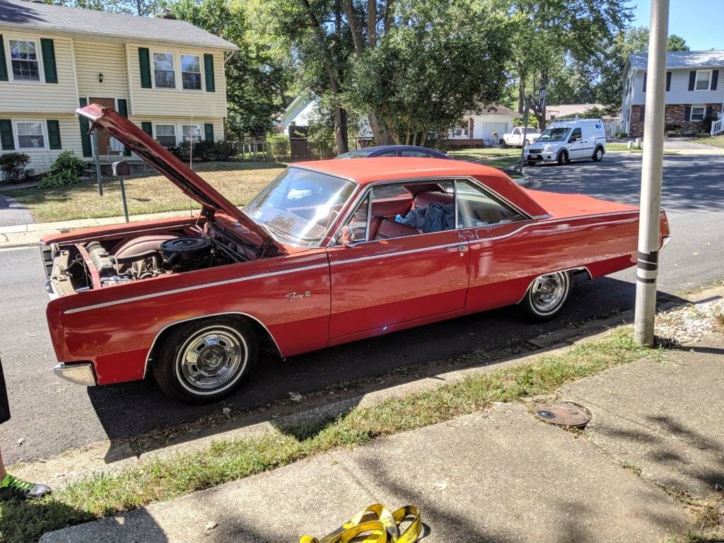

    Howdy folks. I have been lurking in the background of this forum for quite a while. Now I'm about to start being a part of it.
    I have a 1967 Plymouth Fury III, 318, with 71,000 miles. It hasn't been driven in 4 years and probably hasn't been started in about 3. My plans are to take the engine out and have it overhauled. My engine builder is an 80 year old friend who still runs his auto shop every day.

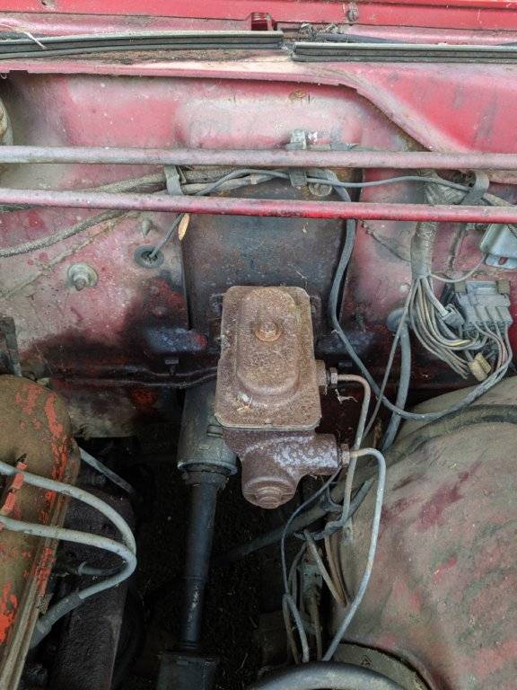

    While the engine is out I would like to do the Disc brake swap. As you can see in my picture the current master cylinder is leaking down the firewall and the pedal currently goes to the floor. When I take the top of the MC, it's the rear of the two compartments that's drained out. While I have it apart I figured I might as well do the brakes. If anyone has a power booster and master cylinder that is compatible with the disc brake swap please let me know.
    Also while the engine is out I will be detailing the engine bay. Once I get the car up and running I will get the body work and interior done. I would like to stop and go first, then worry about looking good. I hate to just see the car sitting, I want to get it running good again. I will try to keep the forum updated as I do things.
    The car is currently at my father's house, as I live in a townhouse. This evening I was able to take off the radiator, alternator, power steering pump, and fan. I plan to pull the engine on the 29th, if not before.

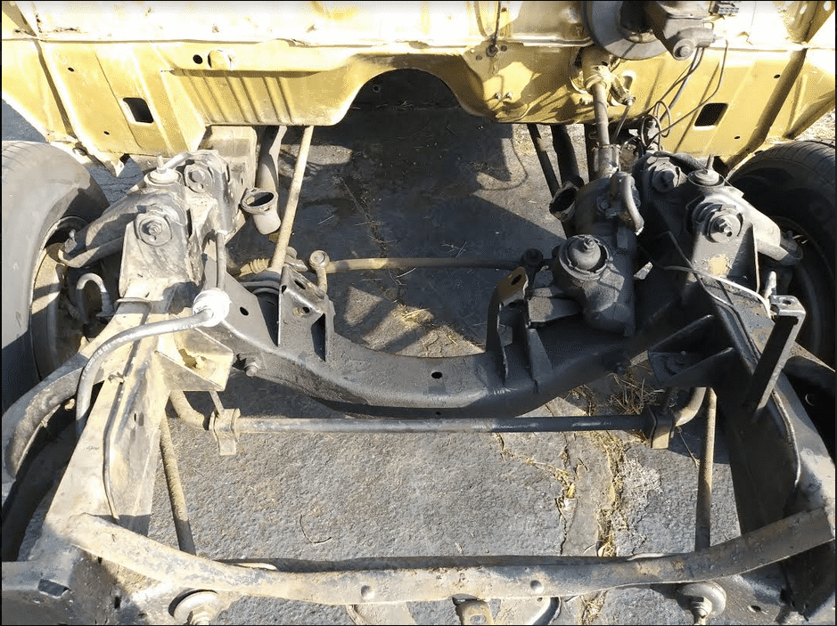

    Be the perfect time to go thru the suspension also. Control arm bushings, ball joints and steering linkages as necessary etc. That's a very nice looking Fury. I like that roofline.

    The power disc brakes that were stock for this car were the dual piston caliper type that were a PIA. They are hard to find parts for at this point, so I would not recommend that type of conversion. With a 318 stocker, you probably do not need discs anyway. The standard power brake booster for drum brakes is still available and might be a better choice if you need more braking action. Your current brakes are leaking and probably do not stop well but properly maintained you should find them more than adequate with the drum booster. Nice car, by the way.

    I have a 69 Fury III with a 440 and still run drum brakes although they are power assisted.

    I did get a quote from Laura at Springs n Things. I will most likely order the front end rebuild kit and rear leaf springs.
    Does the power brake booster make the much of a difference? Maybe I could just replace my non-power one and see how that is. That way I'm not opening up a bigger can of worms with the disc brake conversion.

    A properly working power brake booster will give you significantly better braking. The conversion is pretty much a bolt on. You will need to scavenge a salvage yard to find the mounting bracket for the power brake booster as it is different than the one used on standard brakes. Master cylinders are the same.
