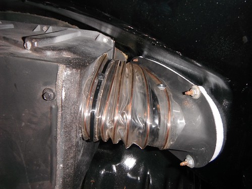

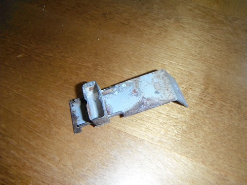

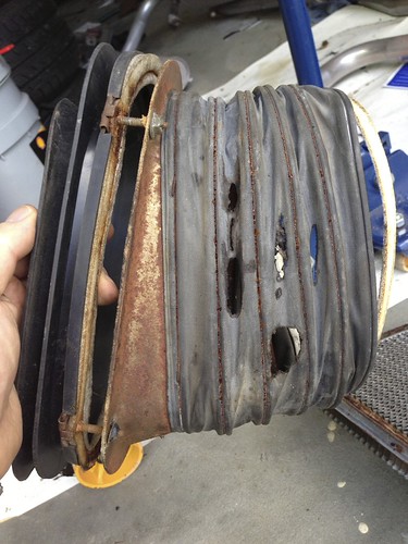

This was in pretty bad shape, I could not find any good replacement part.
So I decided to use some farming equipment...
And the place where it goes:

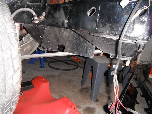

New splash guards by Detroit Muscle Technologies in their place:

Never seen that stuff (city slicker here).
Where do you get that and what is it called so I know where to look for it.
It is so called "dust pipe", made for dust extraction like sawdust or for hay.
I got it from local hardware store. It is plastic and round, but can
be shaped to oval because the copper thread that goes inside the plastic.

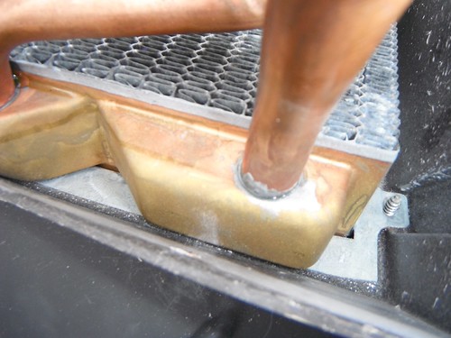

Next thing to hit me was the green fluid in the car floor coming from heater box. I double checked the hose connections, but it was clear it came from the brand new heater core. Got the box out:
And found the guilty one, this tube was loosen and caused the leak:
