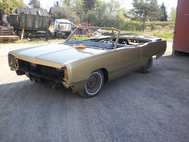

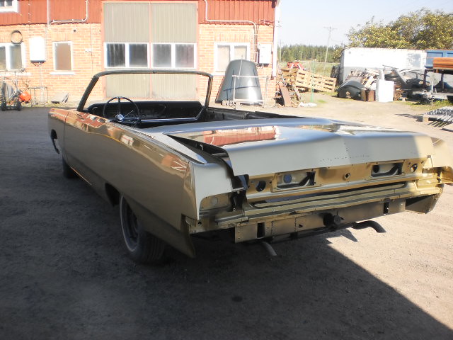

GUESS WHAT, THE CAR IS PAINTED :yaayy:
Well actually it has been painted for a few weeks now, just been too busy putting it together.

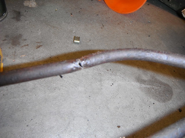

Well, pretty soon it started to smoke from the exhaust and there was a lot of red fluid on
the floor....

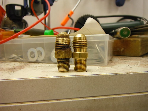

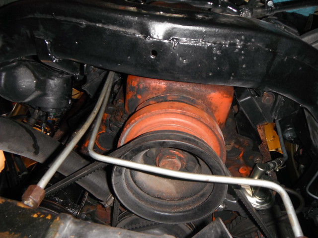

The other transmission cooler line had a hole in it:
So I had to redo also those (probably the only line that was NOT done yet ):
Then when putting the other line into its place, I noticed that the flare nut was not straight. Took it
off and noticed that I had managed to destroy the threads on the fitting... :BangHead: And those fittings
are not easy to find from Finland. There was one place, should be in post today. But if the flare nut
is bad too, then I have a problem. Those nuts are nowhere to be found in Finland. Already
found one set in Ebay in Canada for 20$, I ordered that set just in case.

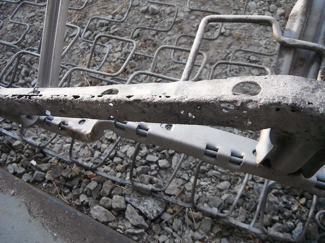

I have had plenty to do. I've been working with the interior, especially seats. The back seat frame
was a bit rusted, and required some new sheet metal:

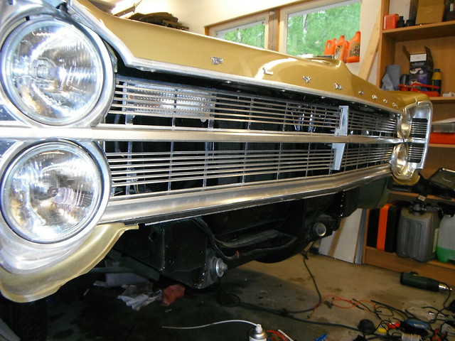

All the wiring has been done and everything works as they should. The frontend
looks like Fury again:

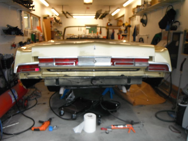

And back too:

The thread in lower part is more cone in the original and I do not dare to screw the new one in as I have the originals coming.

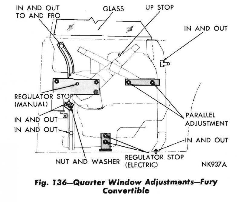

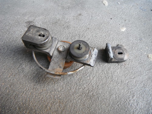

The biggest challenge so far seems to be the quarter windows, is there anyone who could help on that? It totally jams in the middle and if you go over that with force, it will end to this part failure :(
It might help IF I would first read the FSM and then try... :crybaby2:
The left hand side tracks are on the wrong side, I manage to mix them up.
Well, the positive thing is that tomorrow I shall get them ready :)
(if of course that broken part's glue holds...)

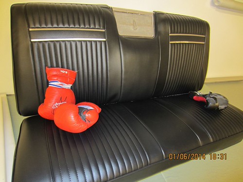

Rear seats ended up like this:
The car is really coming together jippek. Looks great! How does your new ACC carpet look?
