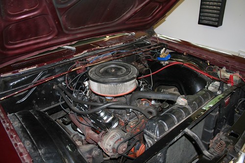

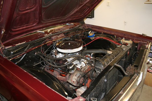

I bought the Fury from the man who had imported it from the US. The paint job was terrible if you looked closer, from far away it was bearable. The engine was running, but not too well. The seller had tuned the ignition so that I was able to drive the car home, but I could not keep the roof in place (it was closer to 0 celsius degrees) during the drive because of the gasoline fumes...
So first I had to fix the ignition. I decided to go from point to pointless, since it would be a lot easier to tune and get running. Unfortunately I did not take any pictures of that... So this is how the engine compartment looked like in the beginning (after the ignition fix):

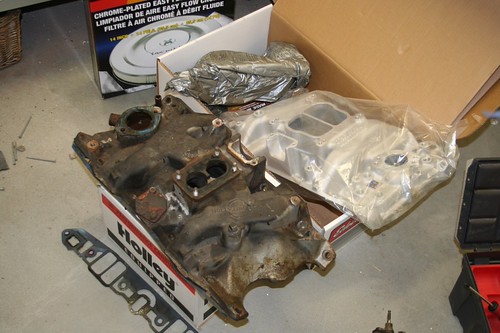

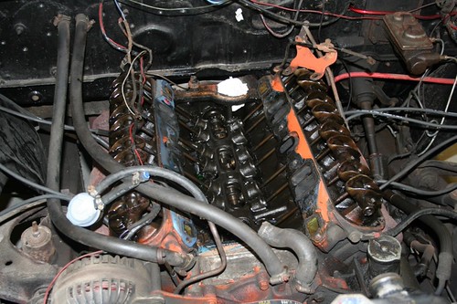

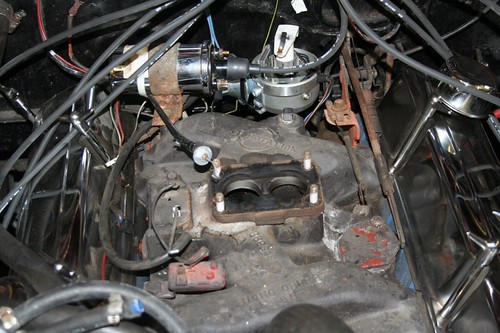

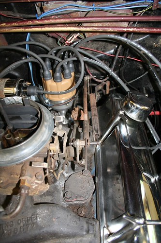

Because the response to throttle was not satisfactory, I went crazy and bought new 4-bbl Holley with new air cleaner and Edelbrock intake manifold:
And some installation pictures:
Some difference:

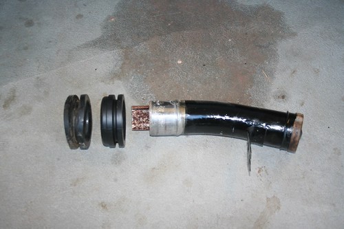

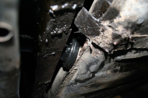

Now the engine was running very smoothly. Almost next day the gas tank started to leak and the reason was very worn filler neck grommet:
After fixing that, the tank started to leak from under the straps from 2 different locations, which I took care with chemical metal. Pretty clear that the tank got itself on the "list".
Some difference:
Looks like you had everything apart, why not do the cam swap too if you were looking for more get up and go?
Well actually the engine seen in the pictures has moulding year 1974. I just bought another engine with moulding year 1967 --> this will be a matching numbers then. But that will be in couple of years, since that engine will be put to pieces and renewed totally :)

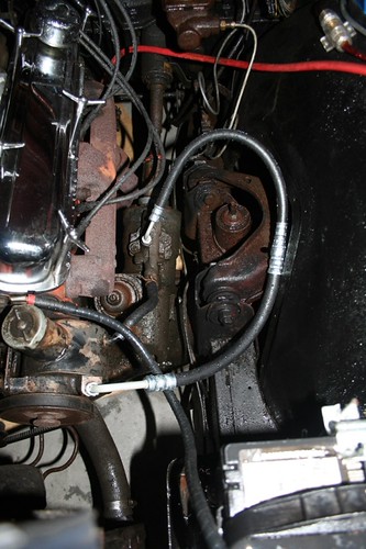

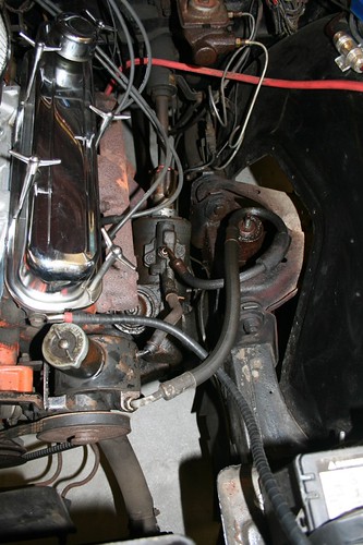

The power steering pressure hose was leaking too, so it was time to change that as well.

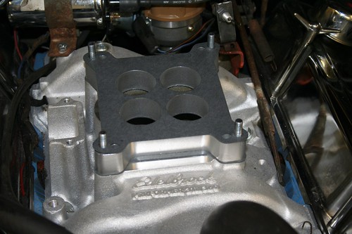

The new intake manifold and carburetor had a small challenge with engine heating up. Every time I stopped somewhere, the engine heated the carburetor so hot that all gas was evaporated away and the starting lasted several seconds. To fix that I bought this aluminum piece between the manifold and carburetor:

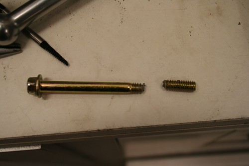

I was also tuning the Holley with alternative secondary diaphgram springs and jets. While I was changing the jet, I had small accident, luckily there are a lot of used holleys out there... Don't tighten too much...

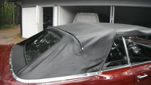

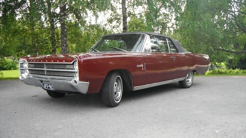

The top was not in that good shape and I bought some boat cover treatment material and now the top shined. However the top got into the list as well as you can see from the picture --> new top ordered already.

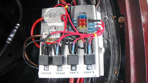

Later in the summer while I was cruising in the dark and needed to use high beam --> quite soon the lights started to blink like a christmas tree. After investigation I realized that in the original there is a heat resistor in the light switch. And as the new light bulps are something like 75W and 100W, the heat resistor starts to break the circuit quite quickly. So it was time to build a relay based lighting. Unfortunately I also noticed that the headlights were made in India... not too original.

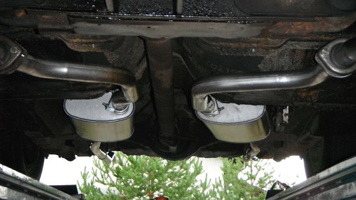

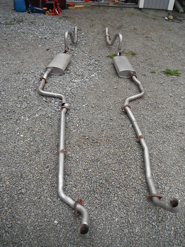

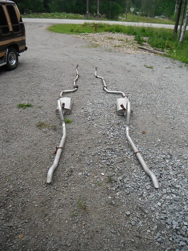

Of course the next challenge started with the exhaust silencer, it started to leak more and more. This model is equipped with one common exhaust pipe, but I decided to renew the whole exhaust system with dual pipes.
I ordered the whole thing from Martelius. Unfortunately they did not have the exact model existing, but they did the first draft based on some other C-body. It was not a perfect match yet and I decided to cruise down to their shop and within couple of hours it was installed and bend to correct angles. This system is totally done without any welding, just bending and attaching pipes.
Some pictures
Here it is assembled on the ground:
And installed under the car:
Damn seeing c body exhaust system sitting on the ground by itself really shows just how long these cars are.
