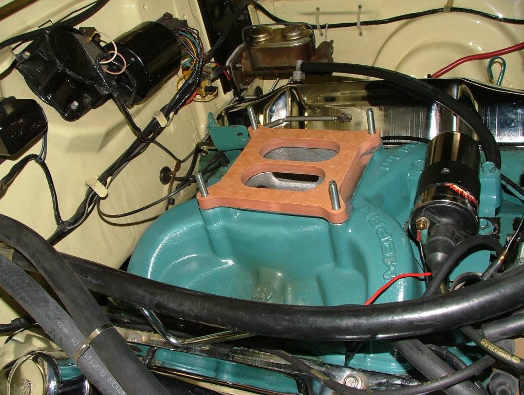

Anybody use a 1/2 wood carb spacer with the stock carb and air cleaner on a 1968 new yorker in-order to help with heat? I appreciate any helpful comments.

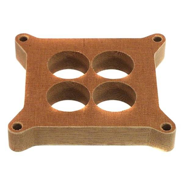

Think your looking at one of these:
Canton Racing 85-150 - Phenolic Carburetor Spacer
That's what I bought, when you say it didn't fit, could you be more specific? thanks-you
