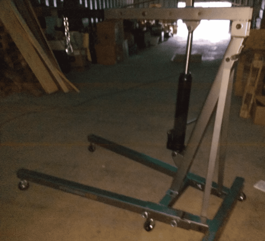

On the tool front, just put this guy together...(2 ton capacity)
These come in handy for more than just lifting engines.
Oh I know. For instance, when I swapped the engine in my MR2 I borrowed one to lift the hind-end of the car (the engine comes out the bottom) :D

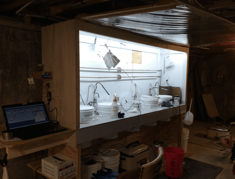

Here is my mostly-operational "workstation"
the five buckets up top are Flash Copper, Acid Copper, Bright Nickel, Chrome, and Zincate. So far I have used the first 4. Zincate is for plating Aluminum which I haven't done yet. Down below are rinse buckets and an old electric roaster for heating the de-greaser. The bucket temps are maintained by an arrangement of sensors, heaters, and SSR's connected to a Arduino microcontroller which is interfaced to the laptop. So I can adjust the temps down to the degree and it holds them very stable.

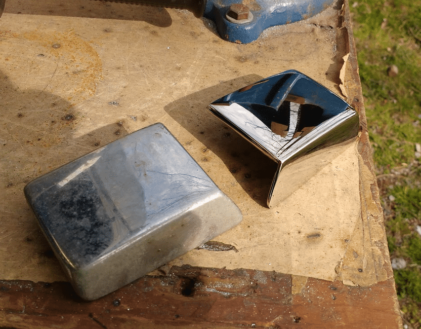

I did a few steel pieces first to get the hang of things (exhaust tips for the 300 and a heat shield on my MR2) then dove right into the pot metal. And man, what an ***-kicking I got from that. I worked with an inside door handle because I figured I can still buy new repos of those so if I screwed it up, no big deal. I started out with one that was pretty nasty.
I could go into detail about my trials and tribulations if you want, but I'd put that in a separate thread. Suffice it to say, I had to start over on this handle probably a 1/2 dozen times (maybe more) before I learned how to handle this wicked stuff. Basically what would happen is I'd have it looking nice and clean, I'd do the bright copper and then the acid copper. Then when I'd come back to it a day later, there would be bubbles under the plate. So it all has to be blasted/sanded back off! ARGH

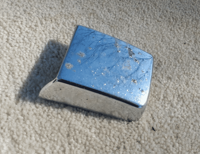

BUT, my persistence paid off. Eventually I got to where I got a good copper plate on it. Then to the buffing. It was very satisfying to see the satiny copper become lustrous and shinny. Mind you, that took some time to get that technique down too. Then to the nickel, which is a very easy and forgiving plate to work with. Below is the end result next to another untouched example.
Mind you, this is not yet chrome plated. I have tried the chrome a couple times on some scrap pieces and the plate did not come out right, so I want to get that down before I subject these nice pieces to it. Really, the nickel looks beautiful on its own, but I've read that it will loose it luster and need to be polished, whereas the chrome topcoat prevents that.

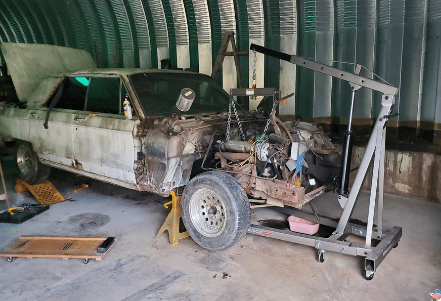

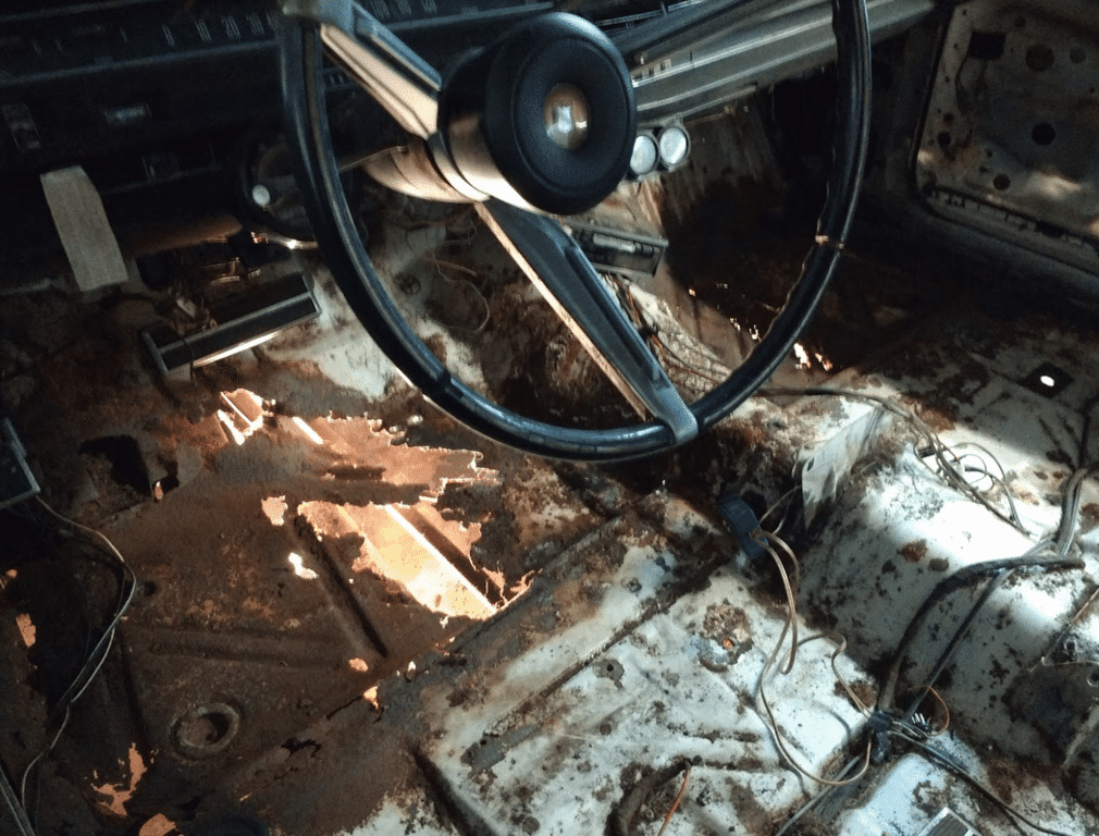

Now that it's getting warmer I really want to work on the New Yorker but I'm trying to stay disciplined and get this other stuff done first. But I couldn't post an update without doing something so last night I unfastened the throttle pedal and removed the last of the disgusting remains of the carpet so I could get a good look at just how bad the floor pan is up front. The Flintstones comes to mind :eek:. It was definitely not this bad when I parked it 30 years ago.

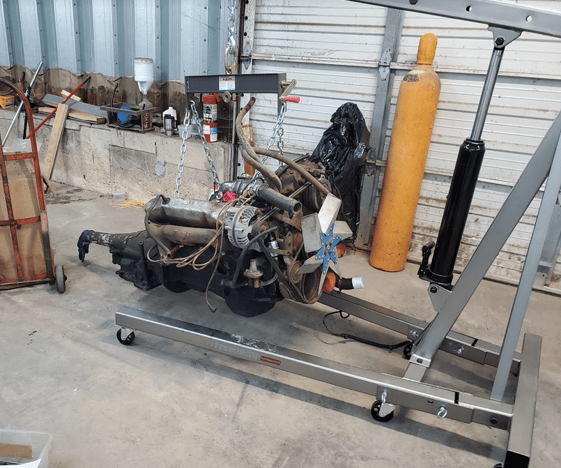

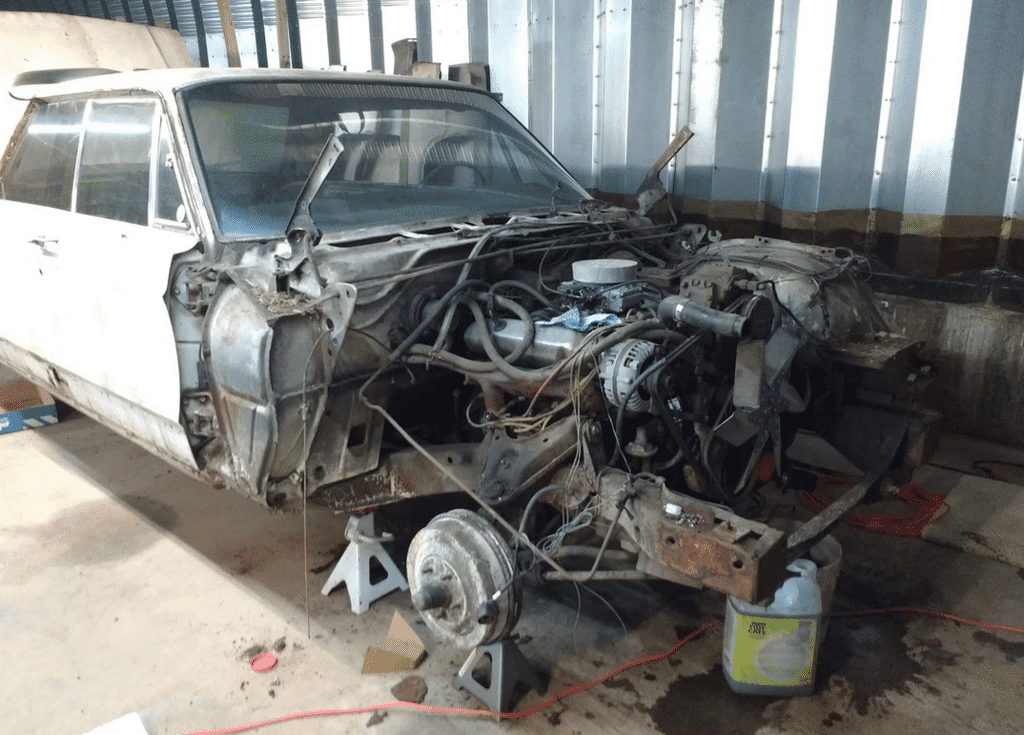

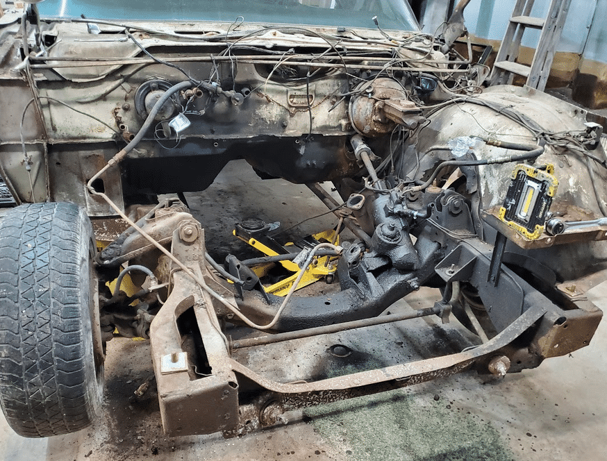

I've been consumed with many other projects lately, but I have been working towards removing the engine and trans. Since I'm going to take them out together, I backed off the torsion bar adjusters as was recommended in another thread. One of them came out reasonably easy with an impact gun. The other one was a huge PITA. Impact gun wouldn't touch it. I had to row on it with a ratchet and 3ft pipe. I probably spent an hour on it and I don't have it totally backed out but I think it's close enough. Just have to remove the transmission mount now before I can start lifting, but I was too tired after all that rowing to do it today.
Since the engine in the New Yorker runs, I'm thinking of dropping it into the Newport so can drive it around and make sure it doesn't have any major issues. The Newport has a 440 which doesn't run, so I'd get that one rebuilt.
