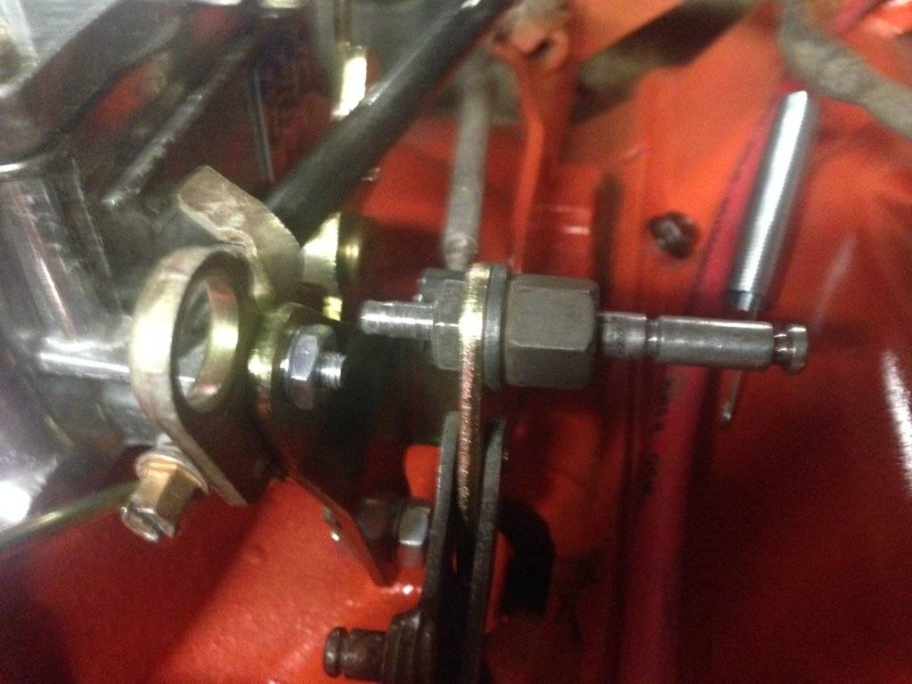

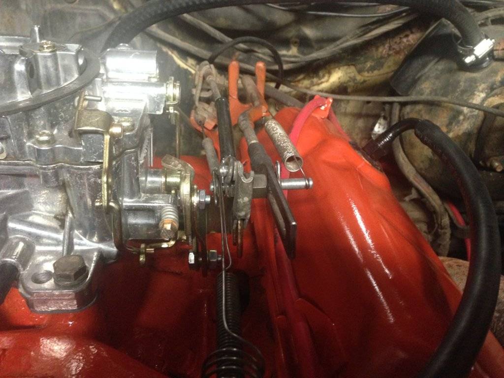

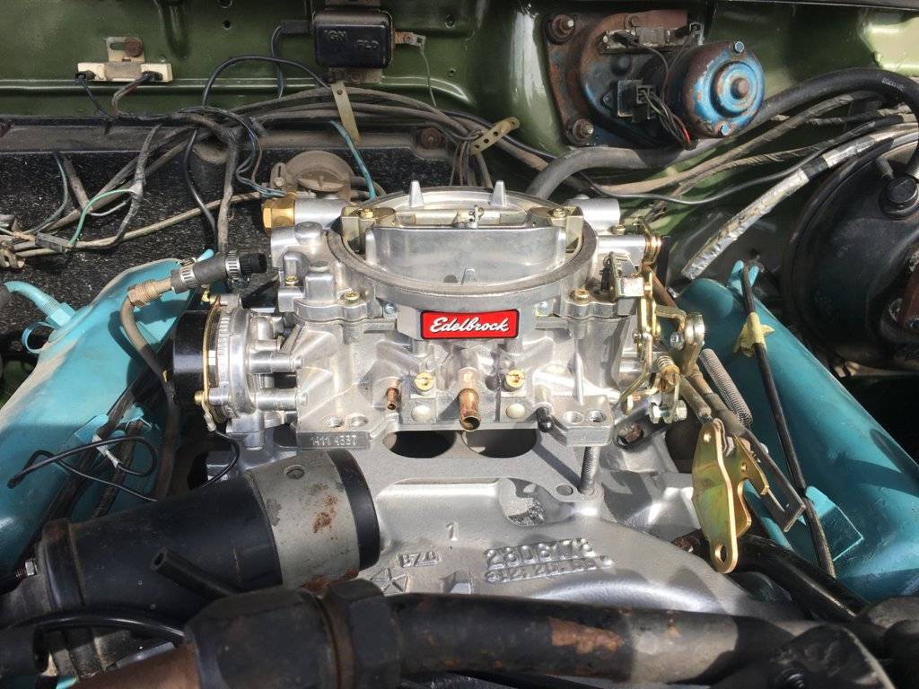

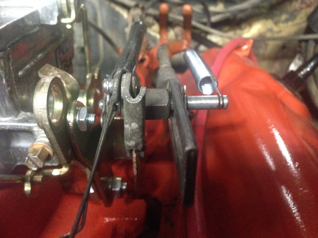

hello, i have a problem with my 750 edelbrock carb in my 69 300.
does anybody know, where i can get the right adapter bracket, where kickdown and so on is mounted, that fits?
thanks for answers
Right from Edelbrock. Summit Racing, Jegs, Mancini’s etc..
You didn’t state if those pics were yours or pics you grabbed to show what you need. If that’s your 1411 and you got the linkage kit you should have what you need. I’d also suggest a 1/2” phenolic spacer between the carb and intake.

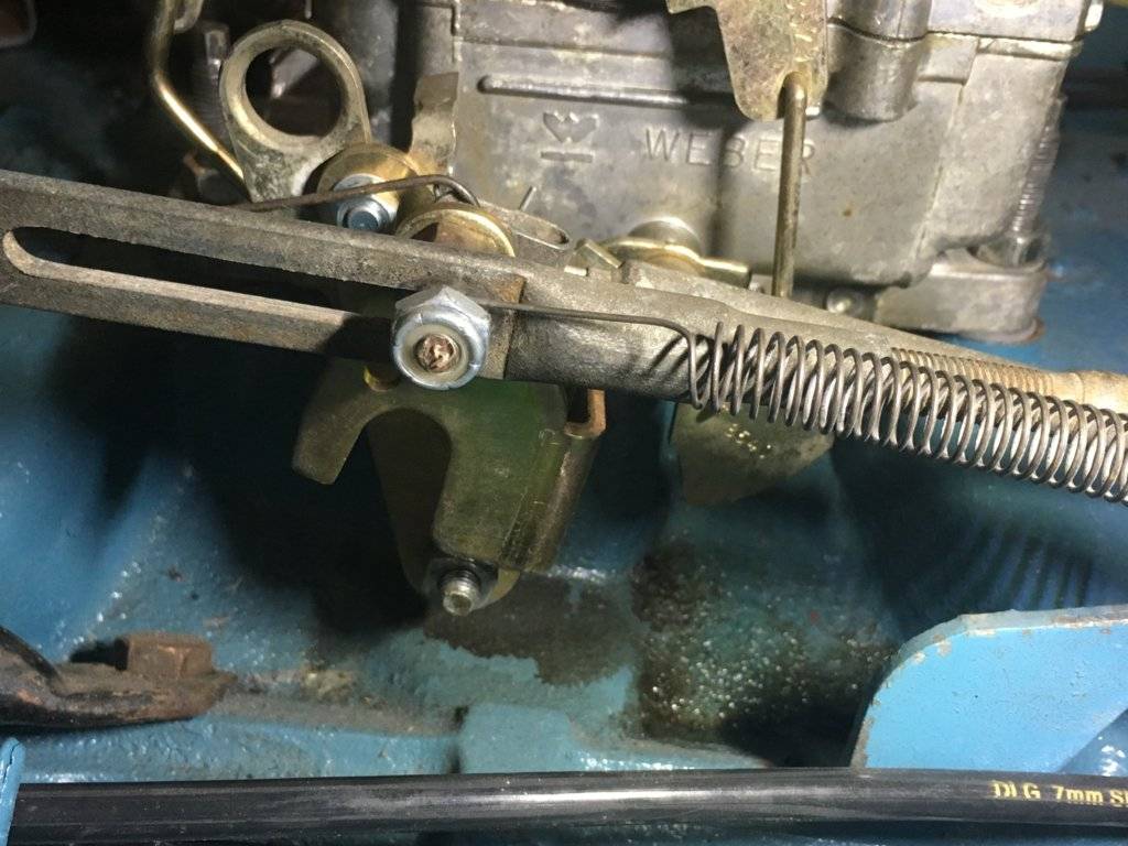

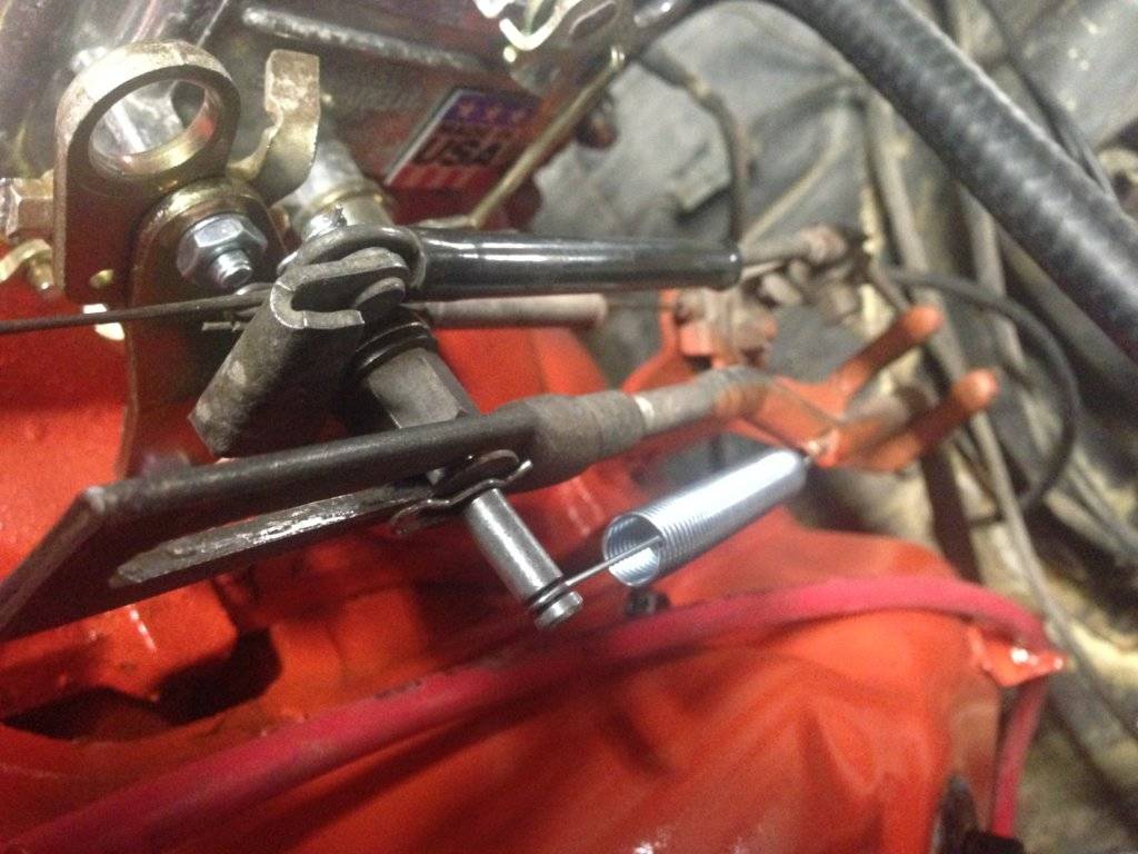

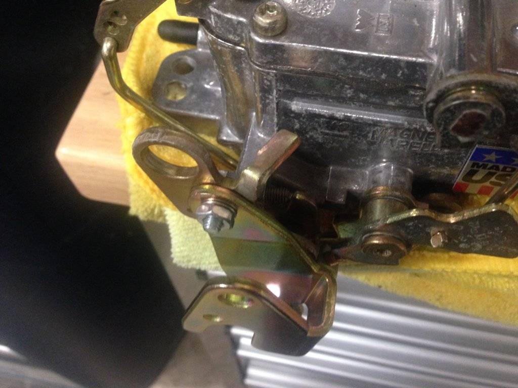

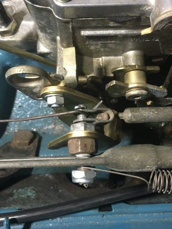

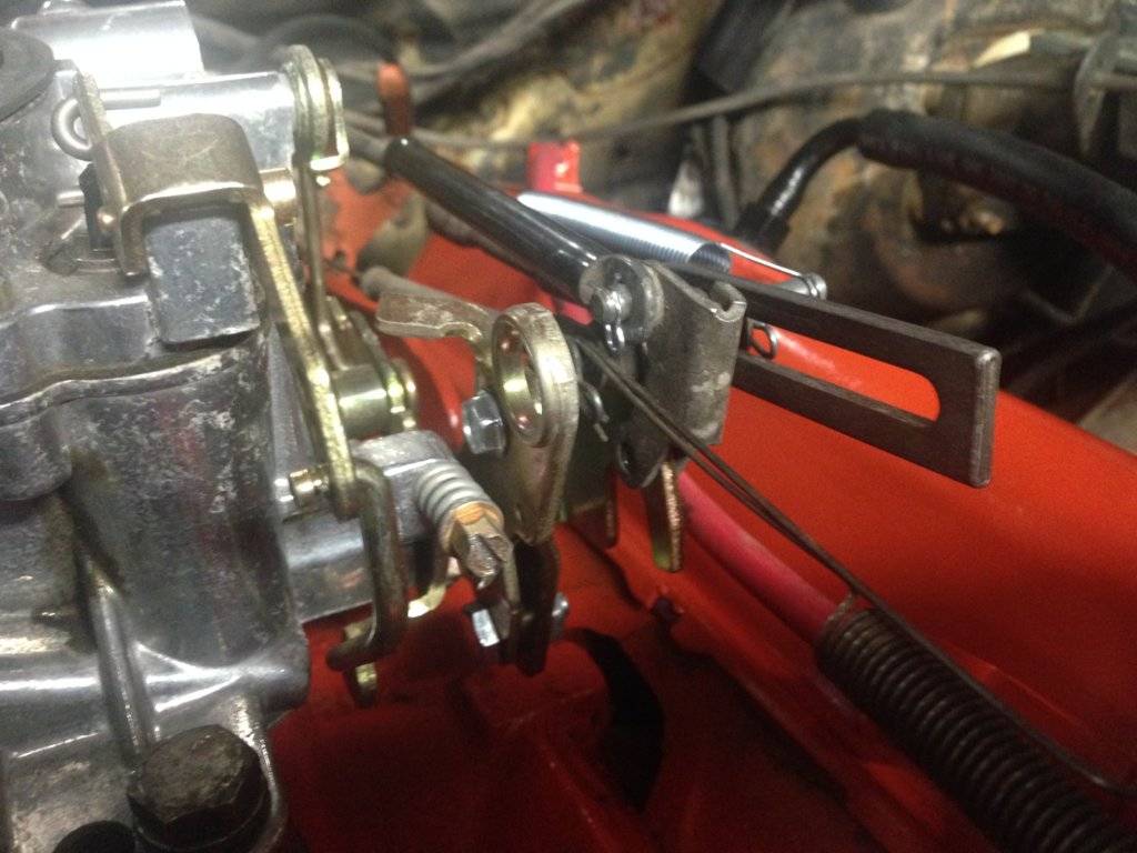

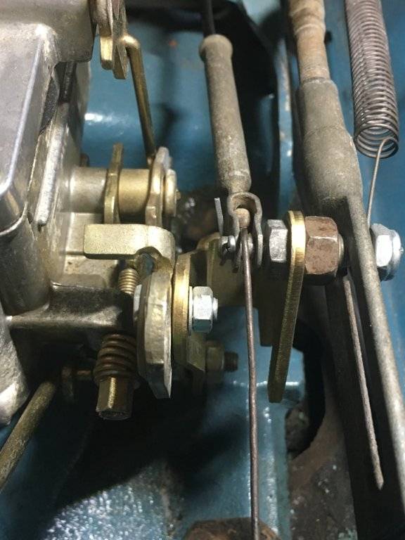

the first 4 pics is my old carb and the last one is with the new one......so you suggest, that everything should work with kickdown and so on?

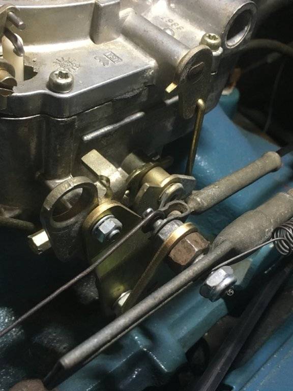

Here are some pictures of mine with cruise control. Yours should work but I suggest that you find the factory linkage pin ( I’m not sure of the correct name of it) that everything hooks on to instead of using a small bolt. It just doesn’t seem correct to me. The threads and the shortness of the bolt may cause binding with the linkage . I’m using the same style of carb and adapter as you and have had no problems with it. I hope this helps, good luck.
You've got the correct adapter bracket to make the Chevy linkage into Chrysler linkage. All you really need is the throttle stud to go with it. Plus the Lost Motion LInk for the cruise control, if you have that. Those throttle studs were common on all Chrysler V-8s up until (probably 1980s?) Might be good salvage yard items?
