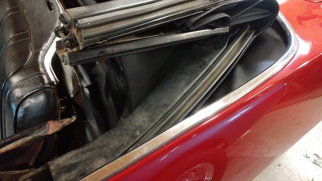

Pic

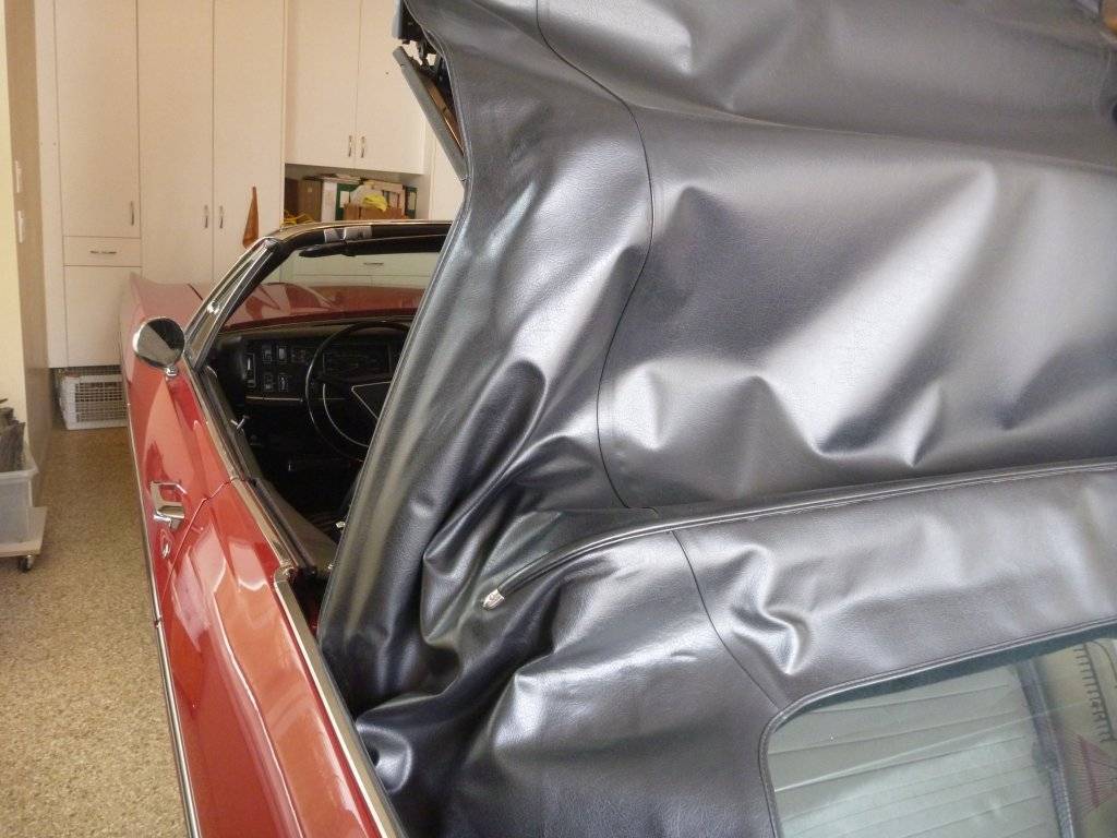

Your top defiantly is not folding correctly. Everything looks right when in the up position. Does it latch to the header OK ....? The arms should drop down into the well at the sides. Did you try to cycle the top before having the cover installed ....? If it worked then there is an issue with the installation.
I'm thinking your initial assessment is a good one.

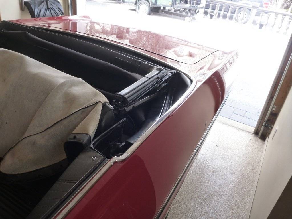

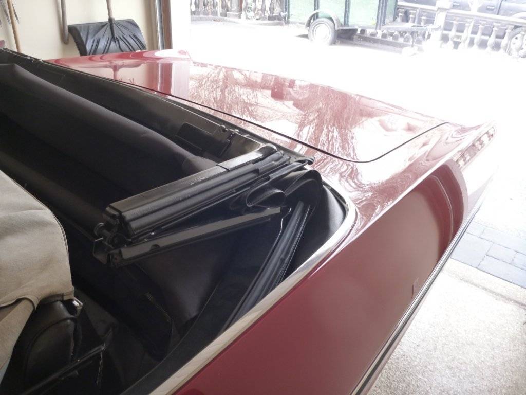

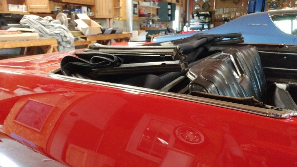

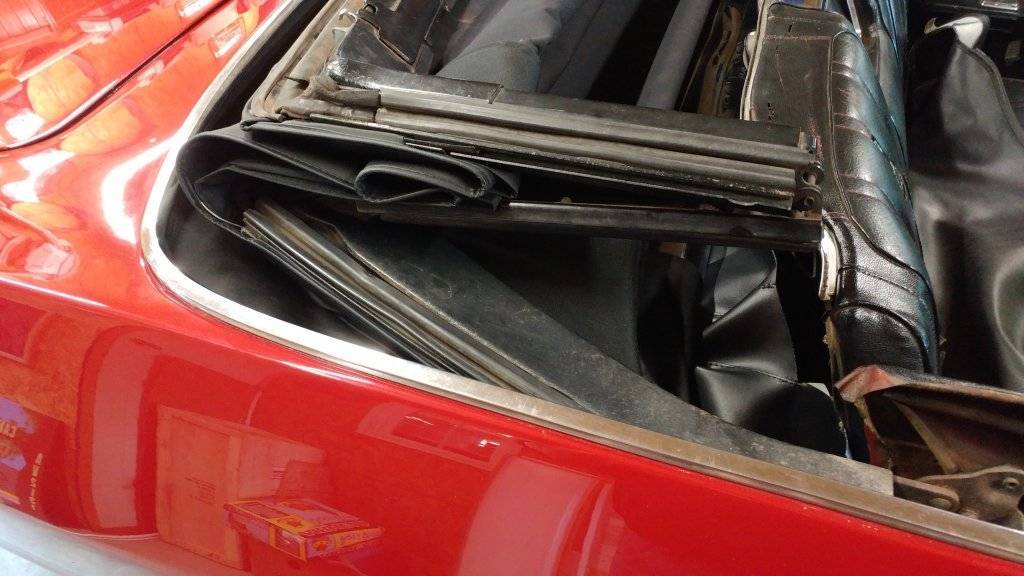

My '70 vert should be near if not identical to your '69 so I cycled my top and took some pictures. The top is probably a little stiff since it hasn't moved since last October.
Here is the top with the roof latches released.

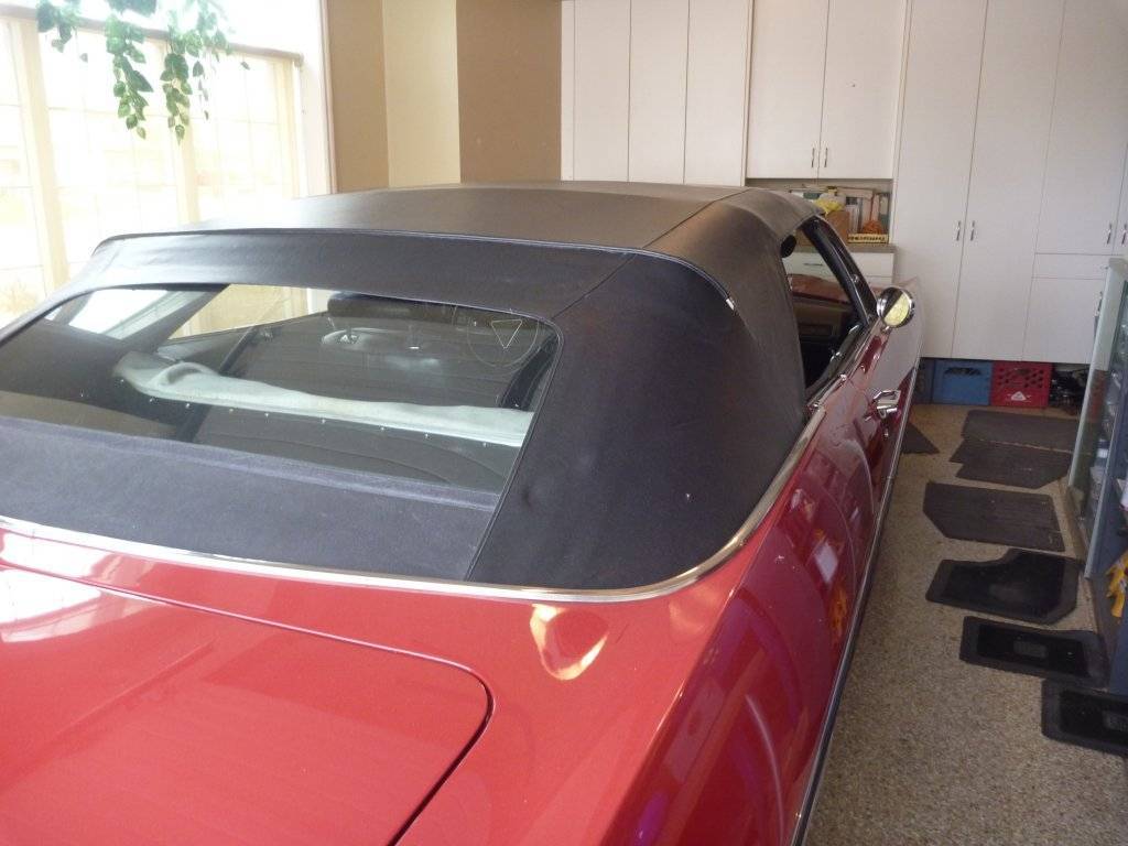

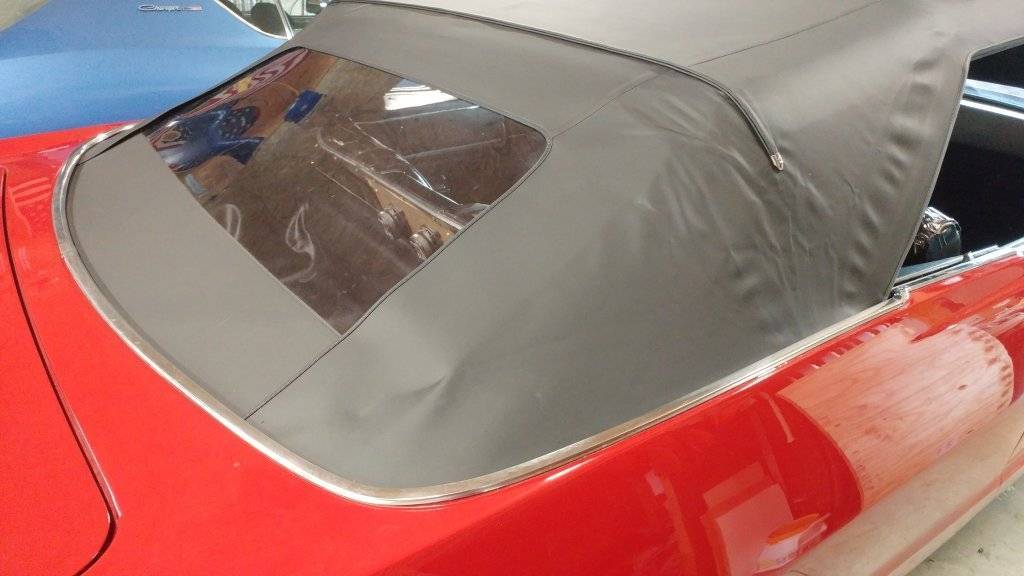

I have a glass window, but it shouldn't make any difference. I used the top dash switch to raise the top to the vertical balance point so you can see how the folds start forming.

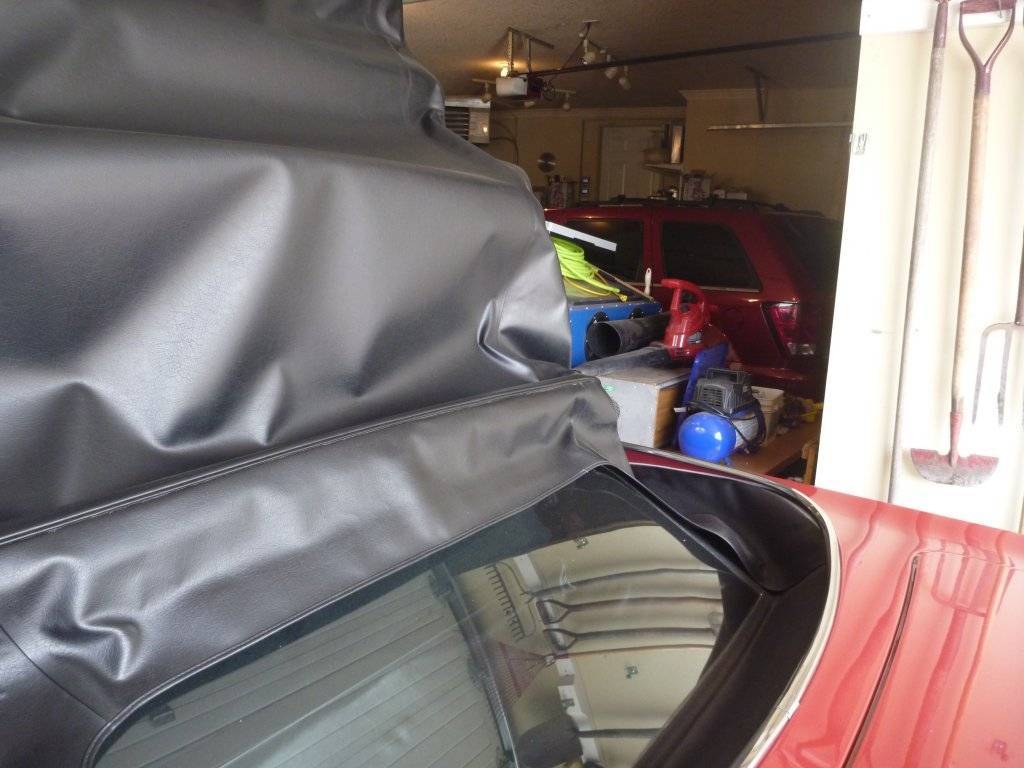

Note the top folds shown above look pretty crappy, but it all works out in the end. I just jogged the dash down switch to get the top just past the balance point and then let gravity do it's thing. The top came to rest sticking up about 5 or 6 inches as the next photo shows. Remember, your top may not fall as far or that fast because it doesn't have the weight of a glass window to haul it down.

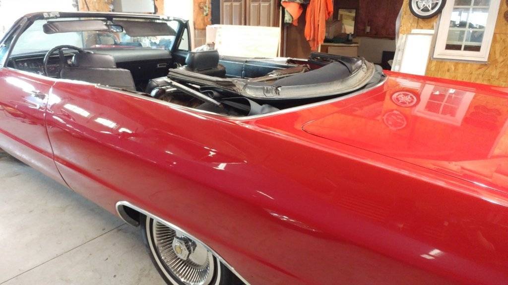

Normally I run the power pump long enough to "suck" it down, but for this demo I just left it for few minutes and gravity slowly finished the job. All the way down looks like the following.
Hopefully some of this helps.
