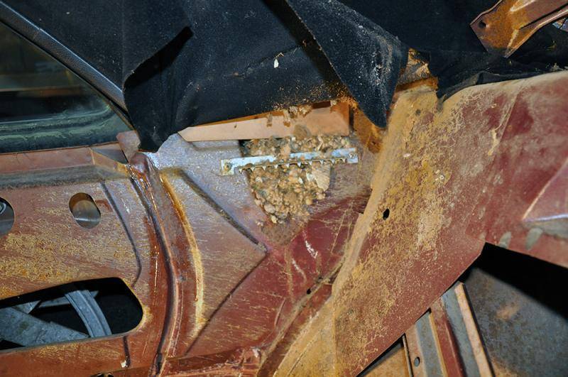

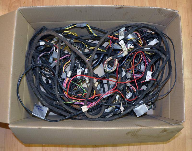

Ya, back to topic. I had not much time to work on the car lately... But did a few things.

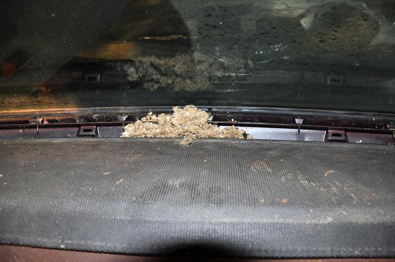

While taking the package tray apart, I found more nests... of course...

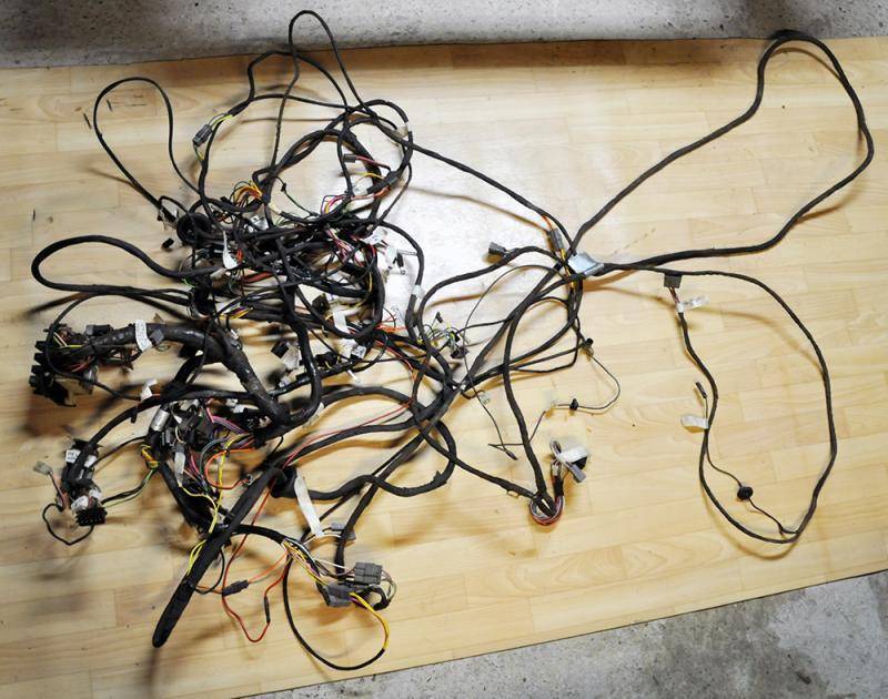

And one BIG nest on top of the headliner. Before taking this off, I decided to remove everything inside the car first, so I pulled the entire wiring harness first.

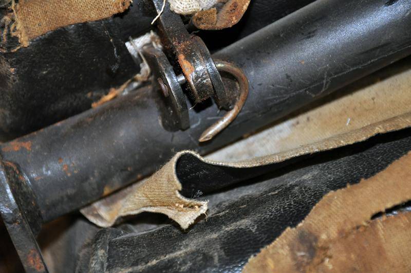

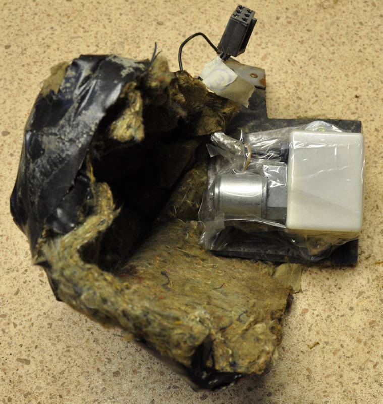

One of the sequential turning signal parts look like new inside its cocoon.

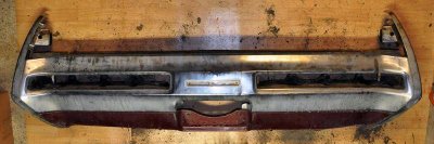

While I was removing the the wiring, I pulled the rear bumper also.

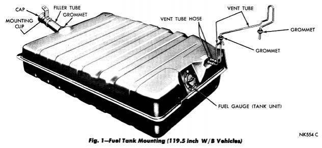

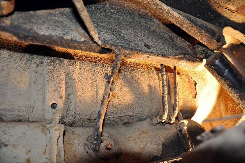

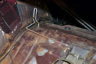

What's the purpose of going into the interior with the gas tank vent and out again just next to it?

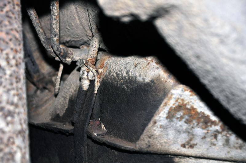

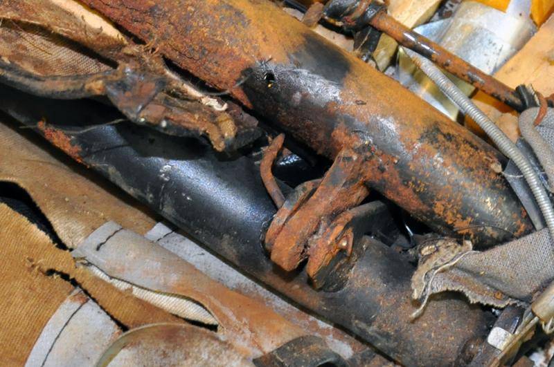

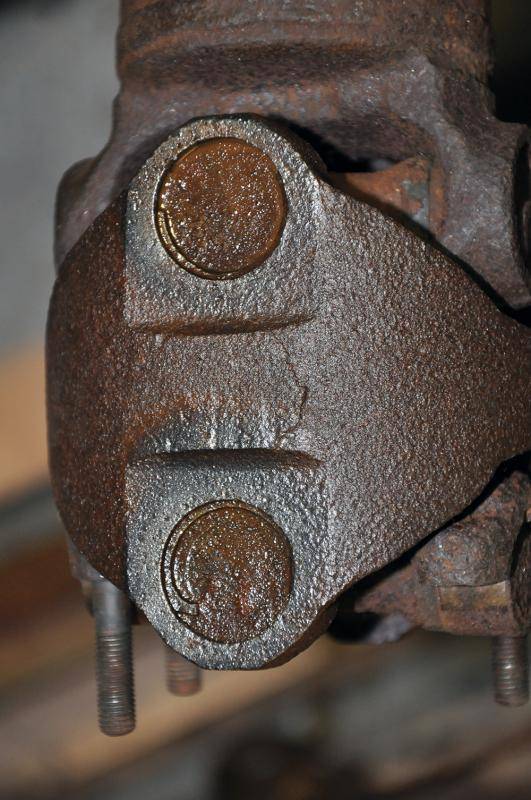

Does anyone have a blilliant tip to remove broken u-joint retainers?

I imagine it was to achieve sufficient height above the tank to promote scavaging of the gases and efficient venting of the fumes

To get the retainers out, first take a hammer and punch and try to knock the bearing cap into the yoke. You won't be able to move it very much, just enough to take the tension off the retainer. That should make it easier to get out.
If that doesn't work, turn it over and try the other side. Sometimes you have to bang on both sides to get things to loosen up enough.
Hm ,but next to it is another vent tube, shorter, that stays under the car. Doesn't make sence to me?!
Soak it in Metal Rescue or vinegar. When the rust is off and small pick should take out the rest. or a BFH.
I'll try to punch it with a BFH after media blasting the rust off! Good ideas. Thanks! I hope this will work

No charcoal canister. 1969 didn't have that stuff.
IIRC, two vents are used so one doesn't start a siphon and pull gas out of the tank.

Na, no charcoal canister. It's not connected to something. The siphon thing makes sense, but doesn't explain the odd construcion throught the interior. But I can life with "they did odd things back then" ;)

I tried to punch the u-joints in a little bit after derusting them, but they won't move at all... Damn rust!

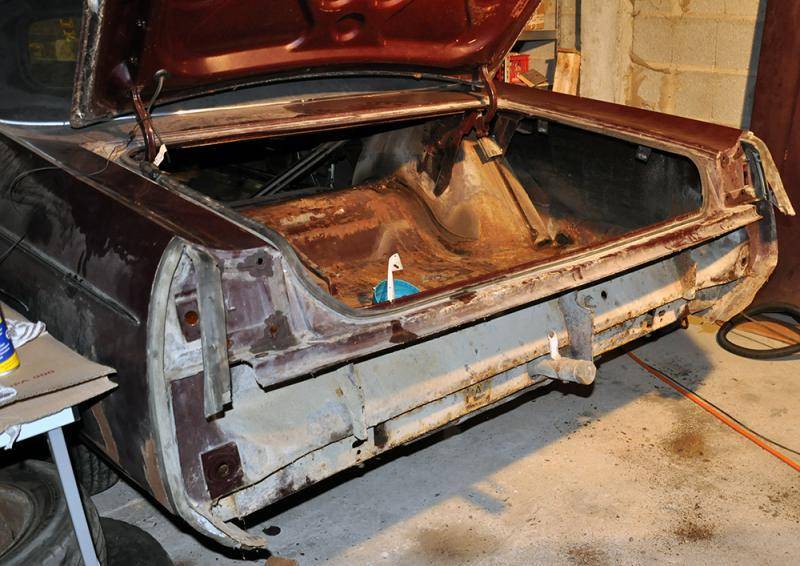

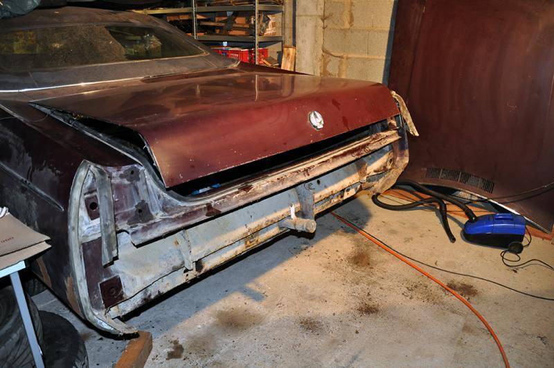

Here comes a little update. Not much time lately, but here and there an hour...

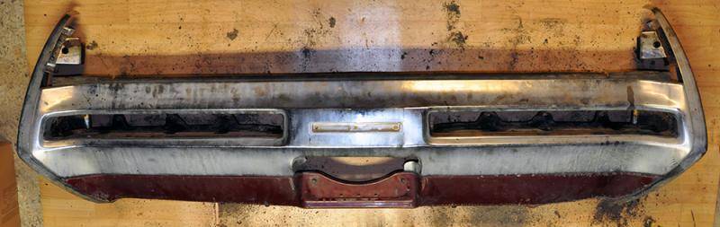

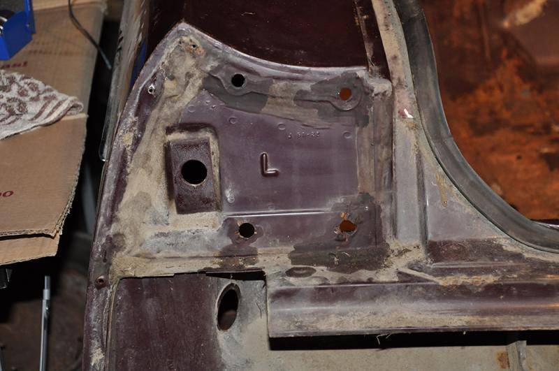

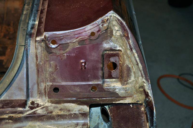

Removed the rear bumper.
And if you've forgot which side of your car is which, they were so kind to label it.
The whole right side of the car from front to back is much more rusty compared with the left side..

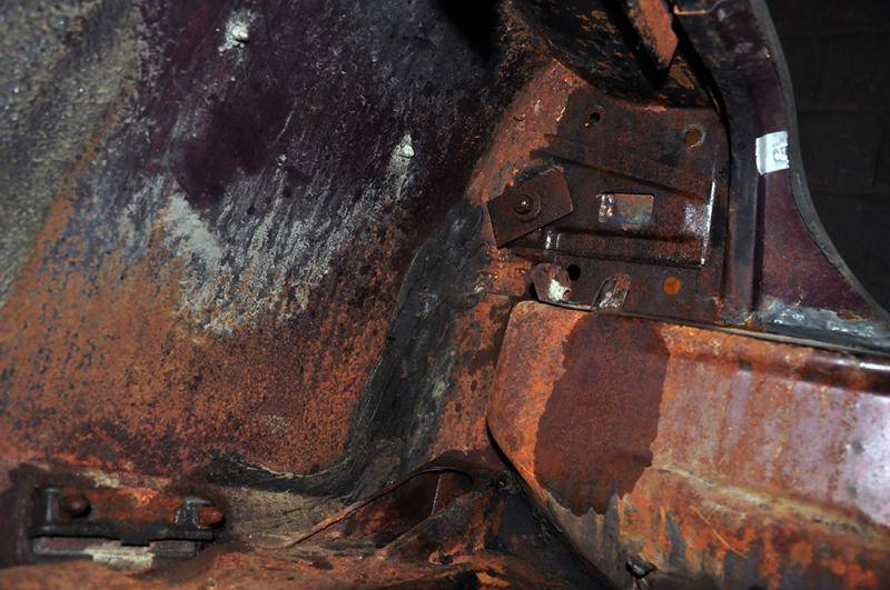

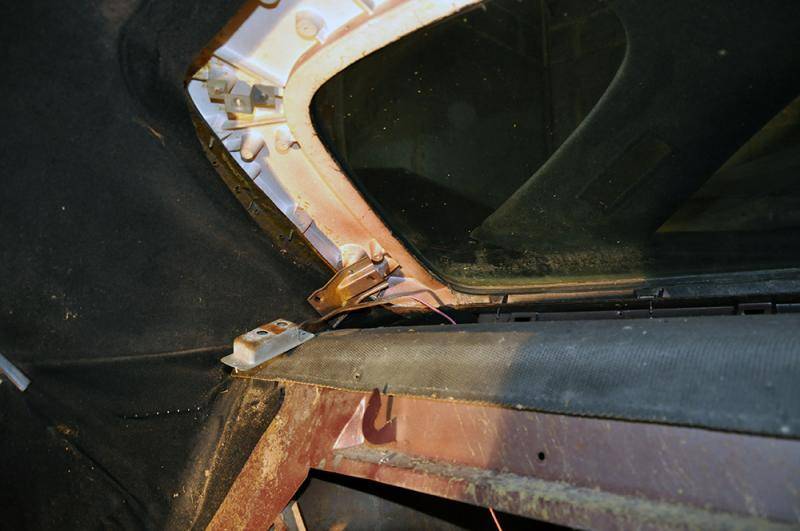

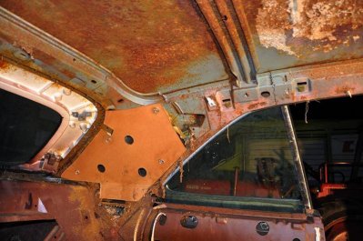

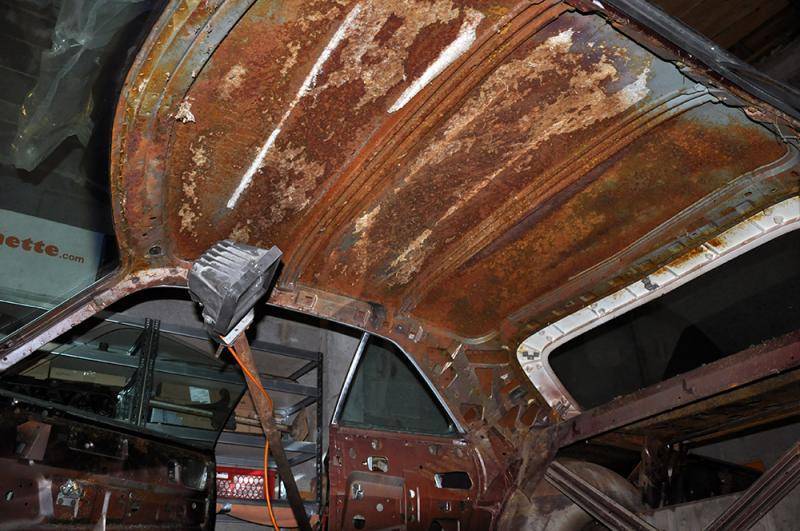

And I removed the headliner. Nasty stuff... One big rodent resort....
But the roof is fine, "just" surface rust.

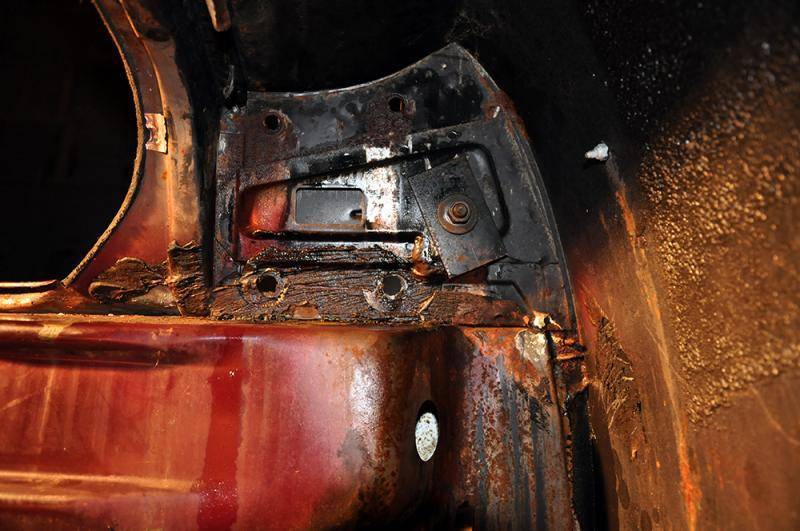

I failed on these screws... But preserved from the undercoating, they are too good to cut them off...

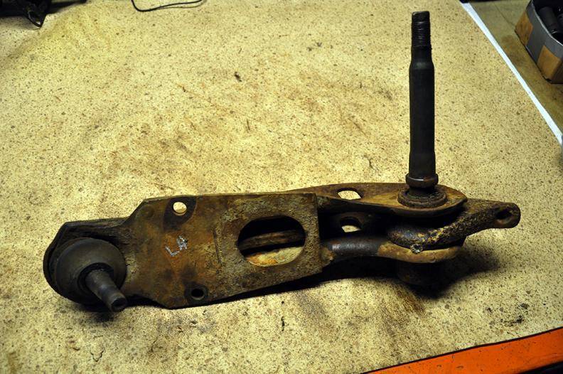

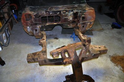

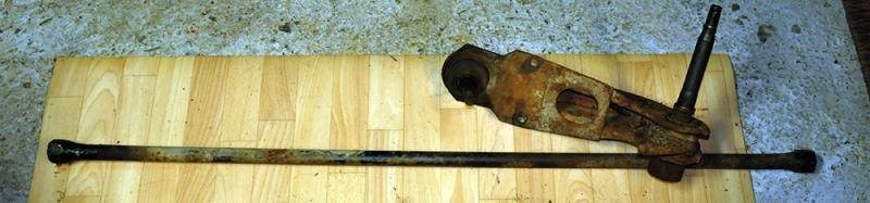

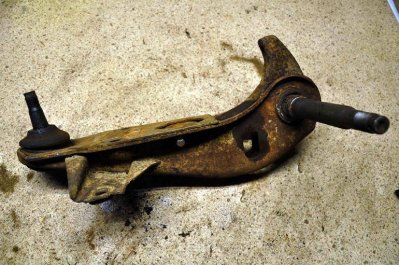

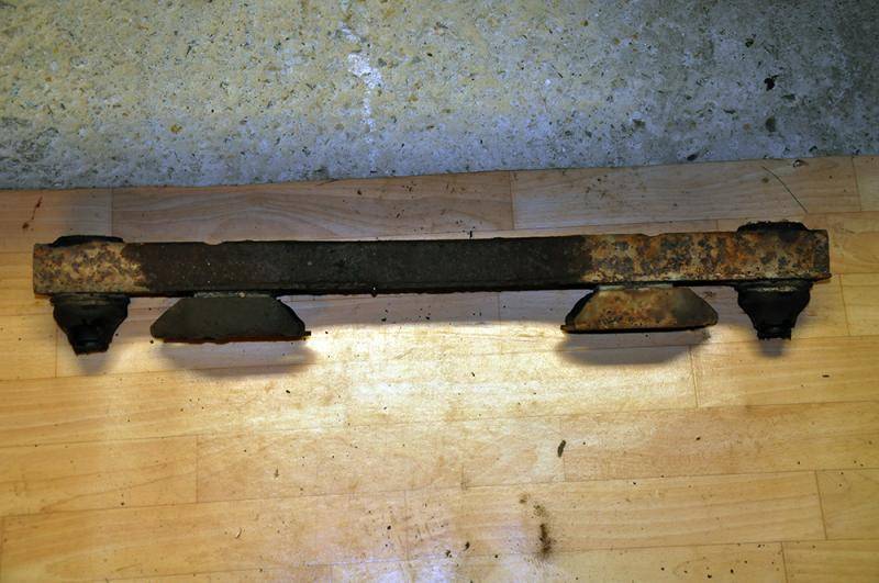

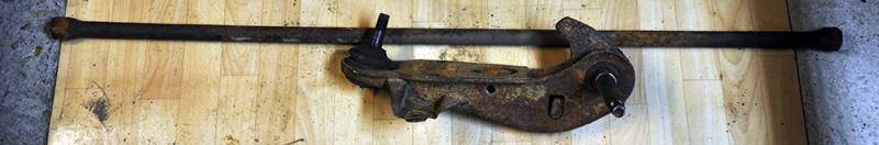

And today, I removed the torsion bars and the k-member. I've read a lot about problems removing the torsion bars lately, but mine came out pretty easy by hand!
The LCAs are different from the regular C ones, obviously. They are already enforced, but still have a little play... Could be more difficult to tighten them up...
