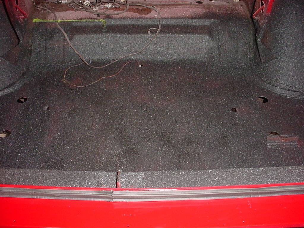

The trunk should have a black with gray "spatter" paint finish. Duple-color has the correct paint available in spray cans. It took about 7 cans to finish mine.
Thanks. I just checked the fsm and it does state the luggage compartment takes a three tone spatter paint. My hold down is in the same location so that's good too. If someone has an original decal maybe you can verify what my decal shows. Mine shows three possibilities with a wagon a sedan and a convertible. The convertible is shown on the left side of the trunk. Same spot except opposite side of the trunk as is in our vehicles.

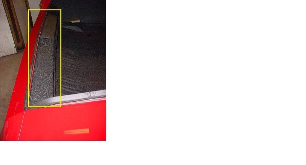

Here's my question..... Shouldn't the area in the yellow box be body color?
Really? I can't say I've seen a C not painted body color there. Now I've gotta pay closer attention
The reason I used the spatter paint there is because it was that way originally when I redid the car. This sort of thing doesn't surprise me. My 300 did not have the blacked out core support or rocker pinch flanges either.
Not a bad idea since that area gets scratched up badly while loading the trunk
Dead bodies don't have sharp edges?? If they are scratcing the trunk maybe the plastic bags aren't thick enough:lol:
It may have just come down to who was spraying the trunk at the time a particular car was coming down the line. For instance, a guy that I used to work with that worked at the local G.M. plant back in the 60's told me that he painted firewalls, and that the guy that relieved him for breaks would just sit down and fall asleep. Of course it was just some G.M.s, so who cares, it's not like it was any good cars.
I'm sure the firewalls got painted at some point before they left the factory.
I am thinking these trunks got painted in the "style" of the painted. That's IF the plant painted the splatter paint. My trunk had spatter paint in the entire trunk with body paint on the area spoken about earlier across the trunk opening before it dips down.
I will have to check the plant mine was made in just for giggles.
Think about this from a production standpoint... the reason the upper area isn't spatter painted is because you'd be blowing spatter paint all over the fresh body paint if you came that close to the trunk opening.
Unless you taped it off. Which they didn't. It was cheaper to just install carpet on the "nicer" cars like Imps and NY's vs. the labor and bottleneck of masking every car. So the work instructions likely told the operator to stay well clear of the opening.
Another odd thing IMO is the body color trunk latch hook. I thought mine was body color because the car was repainted many years ago. Now I notice they all seem to have been painted.
I have another question, if I wish to repaint the tail light bezel on the bottom section is the Argent silver a match? Looks like it would be. Mine is worn through in a few spots from people wiping it.
I would agree that the area would not have been masked, but protected from overspray by the use of a mask/shield devise held in place while spraying. Probably a low pressure application also.
Perhaps the same principle was used while spraying the blackout core support which seems to have been sprayed from the bottom up.

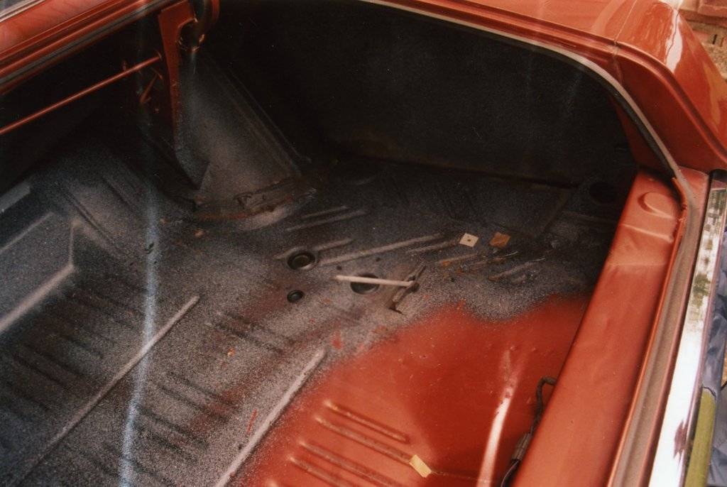

Here is a picture of my 300. Although the trunk floor has been replaced in this shot, the subject area is still in its original finish.
Body color can be seen under the spatter in the wear areas.
