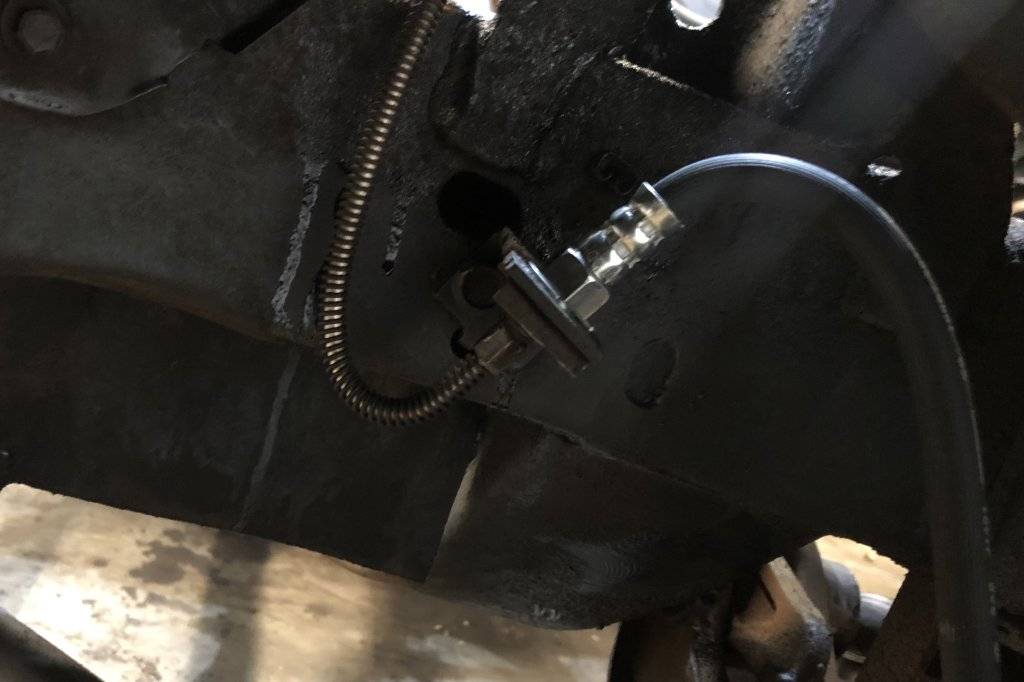

Front brakes are done! I was even able to save the spring things from the original lines and put them on the new stuff. I also used the original line nuts or whatever they are called.

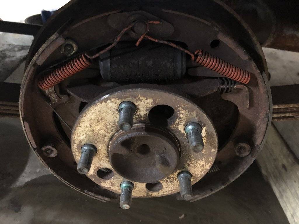

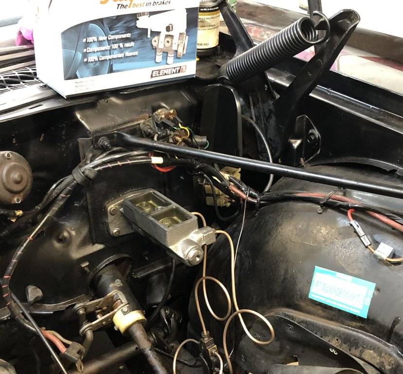

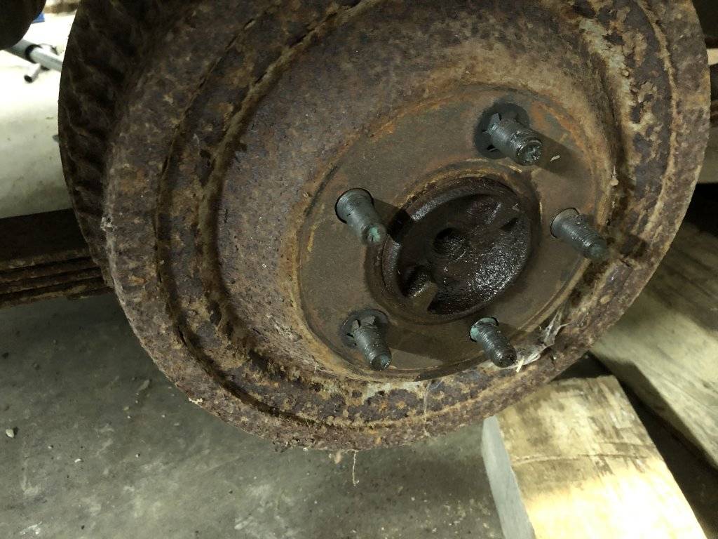

And here’s what it looks like behind the drums. Unbelievably the bleeders broke loose and I was able to get the rear brakes to at least seem functional. Nonetheless, experience has taught me that they are bound to fail at the worst time. So, all new stuff is on the way!

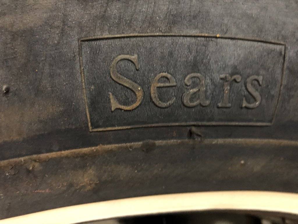

And now a word from our sponsor,, Sears.
Even the wheel weights bear the Sears name. Gone are the days when you bought goods and services and the place where you bought them proudly displayed their name on the product as a reminder who to contact if you had an issue. And by “contact” I don’t mean call a national hotline to get put on hold forever, or E-mail. I mean physically show up face to face and get things fixed! Also shown is my trusty Sears timing light I’ll be using on this car when the time comes.

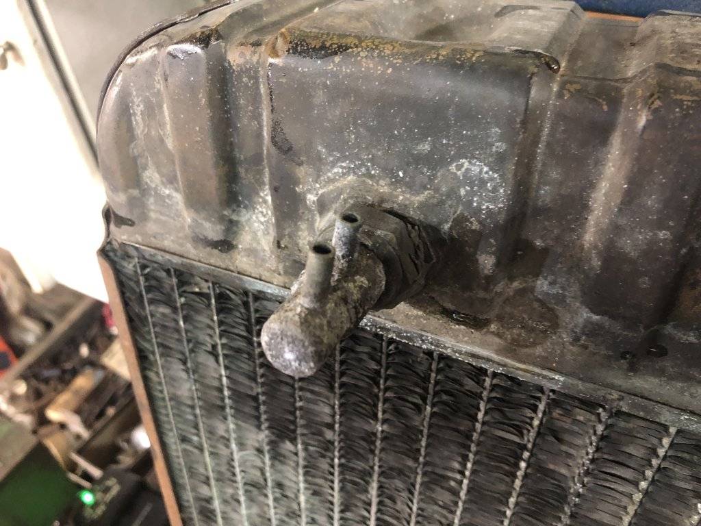

I believe this radiator is not original to the car. It has provisions for transmission cooling, this thermostatic control (which may be correct??) and, what looks like an “OK” written in paint marker junkyard style. Also a flex hose was on the top. Did the car overheat at some time? Is that what caused the engines premature demise? We may never know.

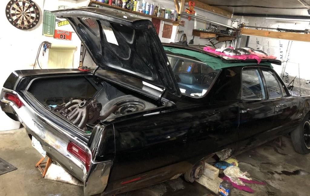

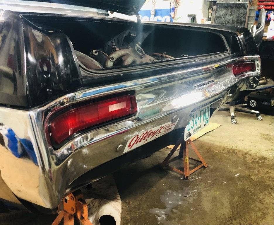

While I wait for rear brake components, I do some cleaning and take some glamour shots that make the car look better than it actually is!

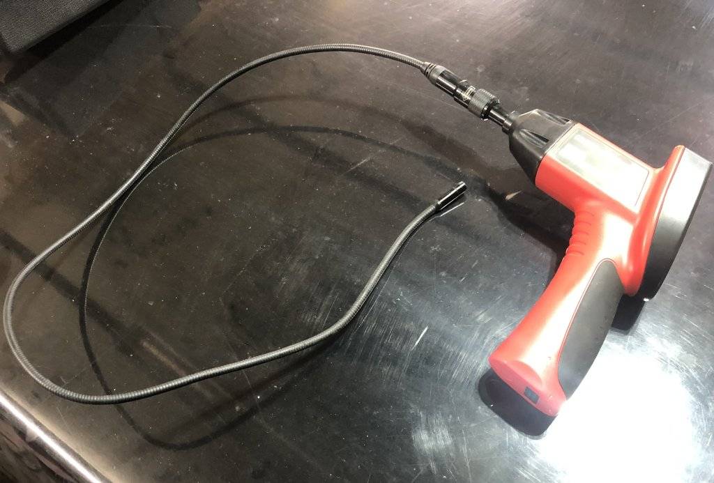

A more modern tool that I use quite often is this remote viewing camera.
You can look into spark plug holes, drain plugs, or wherever you want to get a look at something that would require disassembly to get a better look. This time I used it to inspect the condition of the inside of the gas tank.
It was not pretty.
Borescope is a pretty cool tool, we had a A/C Delco model at the shop. The owner / my boss traded it off on a new Snap-on unit.

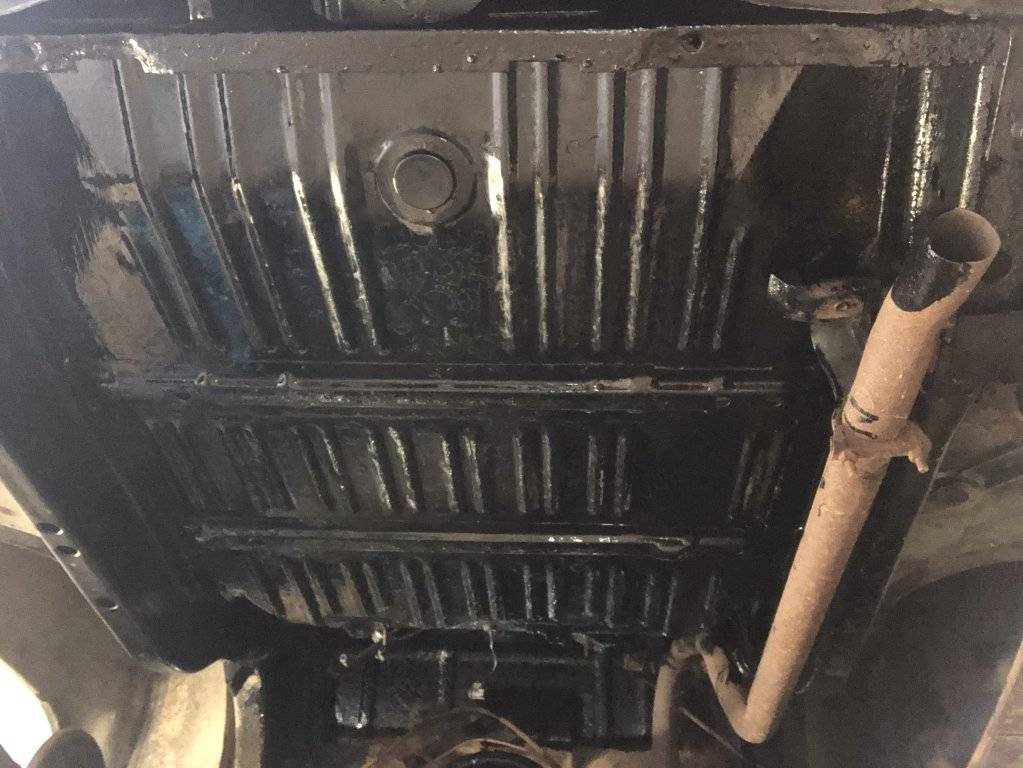

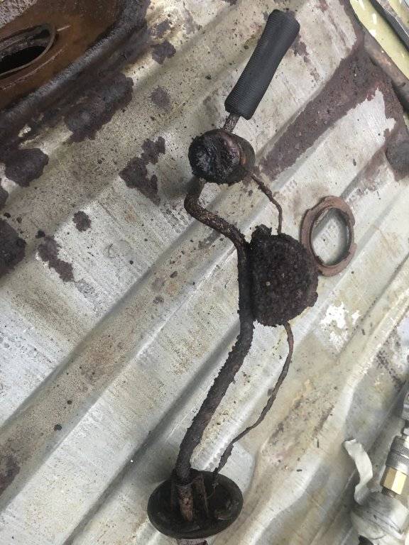

This evenings festivities included removing the gas tank and taking the sending unit out of it. I’ll take it to a shop in town tomorrow and see if it’s salvageable. It had maybe 5 gallons of nasty gas in it and plenty of other crud. Trunk pan looks good under there though!
The gas tank is beyond hope so a new one is on the way. While I’m waiting I cleaned up the area above and around the tank with wire brushes, sand paper, etc and treated it to a good rust neutralizer and a coat of paint. Went ahead and ordered some KYB shocks while I was at it!
