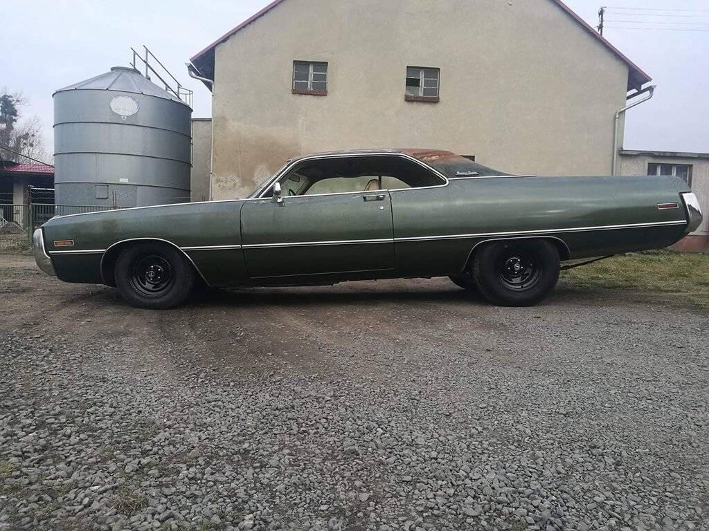

A pic before i bought the car, after it was shipped to poland. Some dumbass tried to make a redneck racer

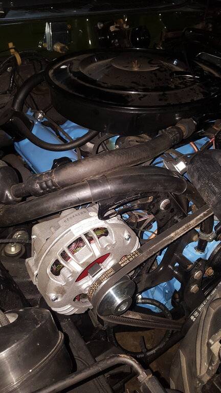

A small winter update :)
Currently fitting a new alternator & voltage reg. On the previous one the voltage dropped to discharge when engine got hot.

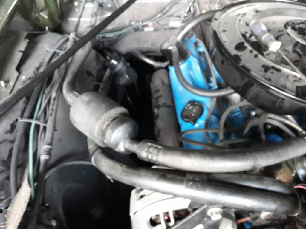

Also getting ready for summer with a locally rebuilt ac compressor, and the whole system checked through. Hopefully get some nordic ice like the sticker says on the unit ;)

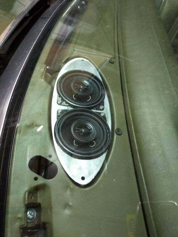

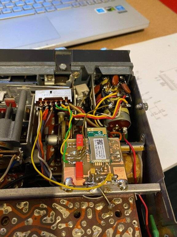

Its almost spring, finally. Recently had a speaker bracket manufactored for 2 speakers. Now i have 2 up front and 2 rear. The stock stereo radio plays REALLY nice. It has also been upgraded by a friend of mine to bluetooth. When u shift it to AM it switches on the bt module.
Also had a coolant heater valve added for the heating, the stock one was removed in the US by previous owner. This one is off a VW car ;) but works magic. Now im having the AC system flushed for the remanufactored compressor. Keep rollin' , almost there ;)

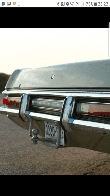

Well i bought it and should have it here by the end of may. I might need to drill some holes in the rear bumper. Not the prettiest thing around, but hey what to do as long as it does the job... ;)
I believe it'll look similar to this (72 Monterey)

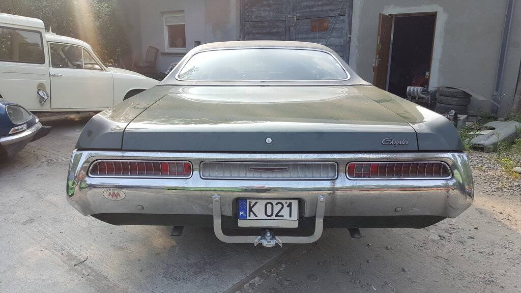

Also had the hitch installed recently, looks kinda like a farm hilbilly thing but should manage a bike rack. It's a class 1 type, 2000lbs gross and 150lbs tongue wieght. Needed some modification to install.
