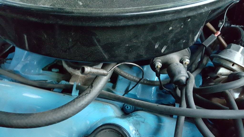

Hey, anyone know what this is for? Not plugged in anywhere, and not sure what is is...
Otherwise, cruisin full time.

Hard to say but I will guess a wire for either the ac compressor or electric thermostatic choke??
Put a test light to it to see if it is live with key on??

Starting in 1970, the cars built with the California emission package had an electrical connection to the vacuum advance on the distributor, this was to limit the amount of advance under certain conditions, mostly when the engine was cold. That is probably what the connection is for. If the vehicle did not have the CA package, the connection was not used.
Dave
