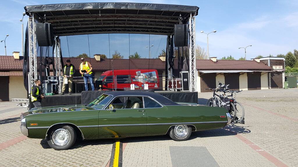

Nearing the end of the cruising season, went to a local car show (was on my way to do some biking in the woods hence the bikes hanging off the back ;). Quite a big show, plenty of people. Was leaving and a guy came chasing to tell me i won a distinction award, came back and got a small cash prize and some goodies. Had to give a small speach on the stage. The other winners were :
1st Jaguar E-type V12 1972
2nd Polish "Warsaw" M20 1953
3rd Fiat 130 Coupe Pininfarina 1973
