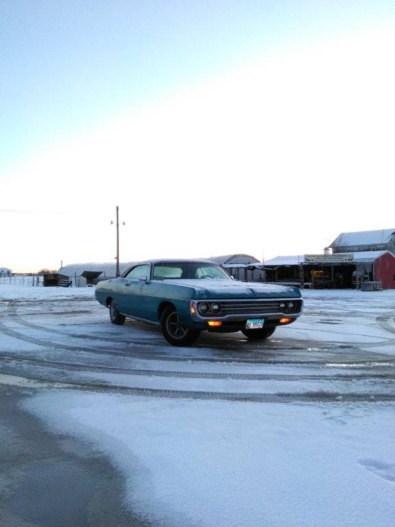

Dave... Don't kill me...its getting a sponge bath this afternoon when spring gets here...It's been awhile since I can remember a snowstorm like this so far into April, I guess we've been spoiled the past few.
I couldn't help but pull over and stop and get a snow covered pic at sunrise in Wisconsin. I hope this is the only picture like this I ever take of this car.

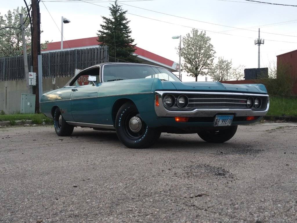

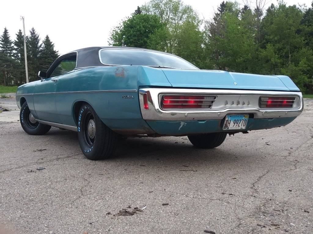

She got her new shoes on. Retiring the Cordoba wheels. Ive used them on everything I've owned since 2010.
255/70 out back and 235/70 up front. I would like to use the 73 New Yorker leaf springs to get rid of these flat ones on the car. Id like new ones, but would rather spend that money on the Brougham and use what I have on hand for the time being. Tonight's update.
