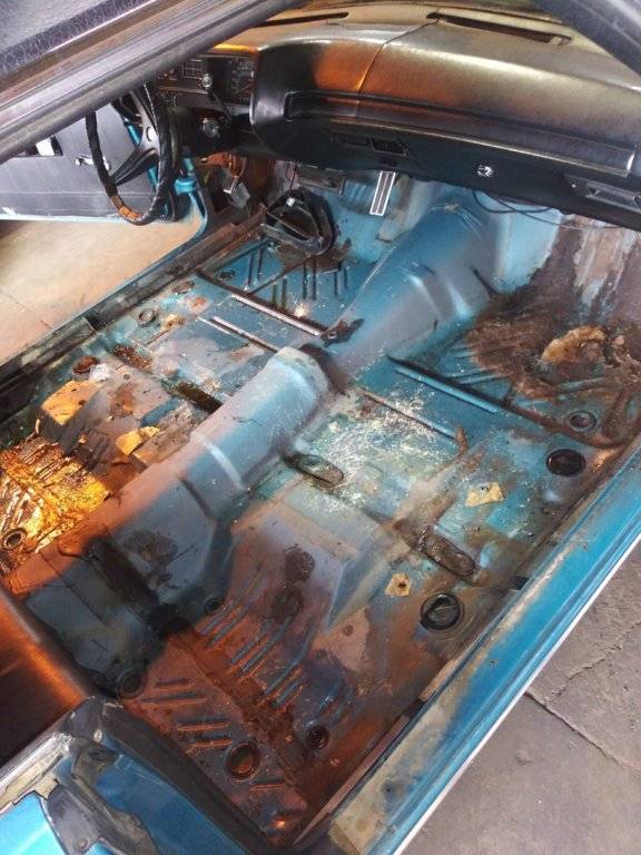

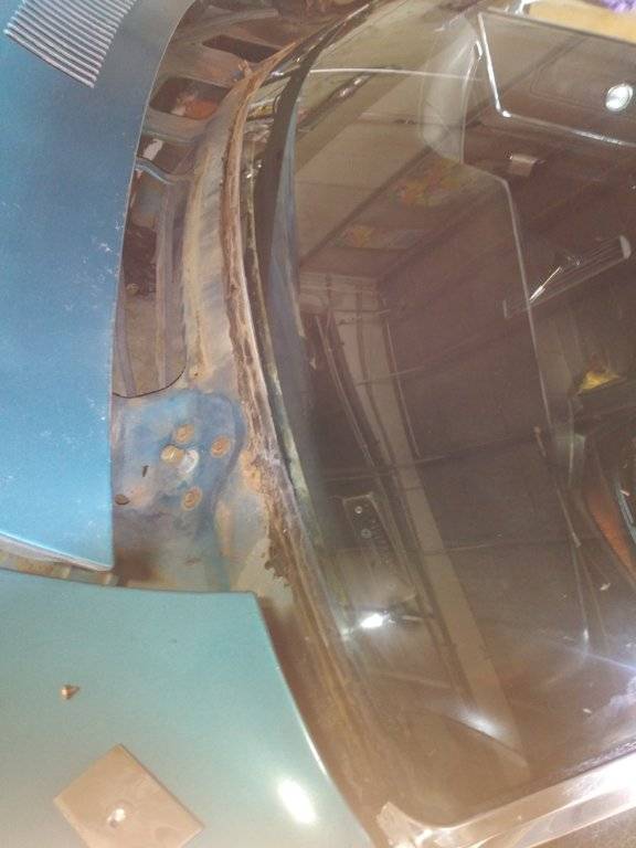

Had a bit of a panic attack earlier. My carpet was soaked. Got caught in a downpour Monday afternoon and noticed my floors were soaked... Carpet is now out. I needed to replace it anyway. I havent narrowed down my leak. The cowl drains were plugged up pretty good. Cleaned em out and will do a water test tomorrow. Found broadcast sheet #2 as well.

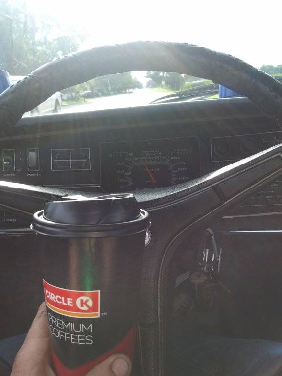

Changed the Speedo cable out and the 140 is still bouncing all over. Very upsetting after fishing the cable out and back in.

Cables are a good place to start but it is almost always the speedometer.
A friend of mine put in two NOS speedos of the roller type that was popular in the 50s-early 60s within a year, they both died pretty fast due to old lubrication. As with NOS master cylinders for exaple if you want to be absolutely safe you'd have to overhaul them, but with a speedo you Need the Hands and skills of a watchmaker.
These are pretty durable and simplistic in operation. I've taken several apart never to have one bounce or go bad because of the unit itself
I' d lubricate the cable and possible the mechanism but I never had too.
Is the cable set right? Both ends? It's ran at a smooth easy route?
It is routed exactly as it should be next to the prop valve sneeking right behind the booster. Clipped into the floor pan and over to the trans. It spins freely. I had it apart and lubricated it. I'll pull the cluster.
Speedo issue solved!
I took the cluster apart tonight to inspect the operation of the Speedo head itself. Using my old Speedo cable and my drill. I spun it counter clockwise on my bench to see if it was still bouncy. Sure enough it was. Not the cable. I looked at it further and noticed nothing visibly wrong with it. So being the risk taker I tend to be vs paying a professional, I grabbed my brake clean and shot a quick blast near the magnets and moving parts. Followed with a little shot of WD40 and after that a few drops of 5/30 from an empty jug I found laying in the corner. Back to the drill. I got it spinning still bouncing but noticably getting better. After spinning at various and getting steady readings at a consistant RPM I felt confident it was fixed. I re installed and took it for a ride and it seems to function good as new!
It had been off the road, in a Virginia police car in a yard exposed to the elements since 78 and I was silly to think it would be a good working unit. But upon my initial visual inspection, I didnt see anything out of the ordinary. Lesson learned. Bench test everything before installing and giving myself a headache.

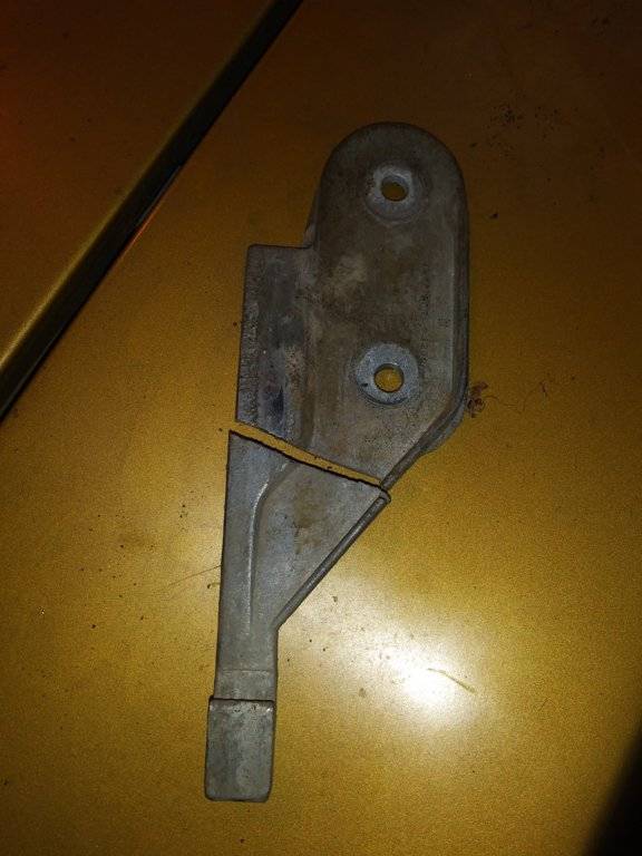

Got the ignition lock and door locks matched up. New Yorker pays the Dodges once more. It'll be nice to be able to lock the car now. Also while I was in the doors I looked into adjusting the windows and as I expected a few parts of the track and other parts were in the bottom of the doors. I fixed what I seen was wrong and lubed up the latches and moving parts and put it back together. However I did have to replace the "up stop" for the passenger window. Need to find a non broken one for the drivers side. What makes that part break so easily?
