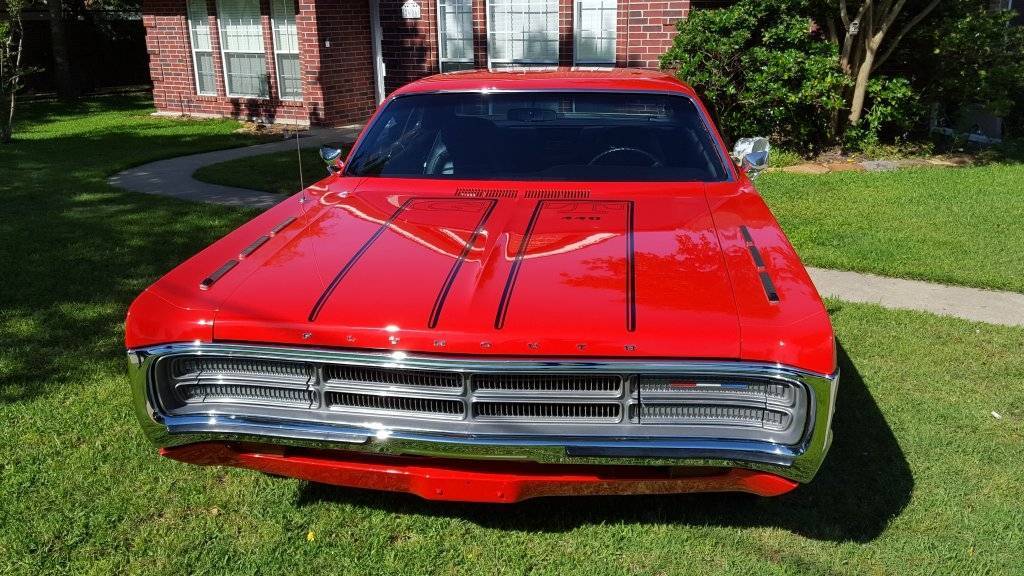

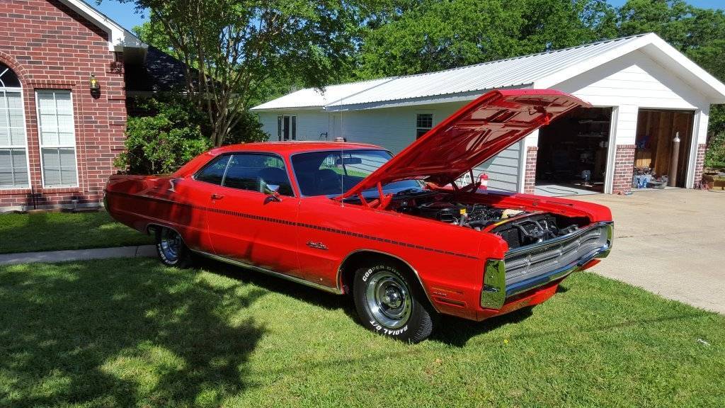

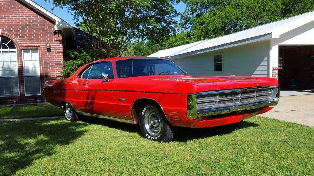

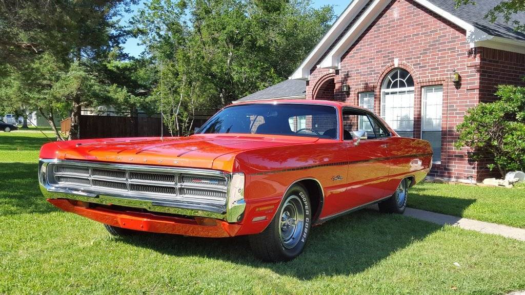

Second fender like that lve seen and is 69...the fenders on the 71 GT from a 69 dodge?
Just looking at a couple things on the gt re the screws on the lower chrome rockers to hold them on and the sport fury badge....would really like to see a before pic if possible
Not even close, the 69 dodge fender doesn't have a scallop in the metal just above where the side marker goes on a Plymouth. The larger black mark on the dodge front fender appears to be double sided tape and is where the side moldings on this model go.
The cornering lamps were on the 71, the screws in the rocker panel moldings were there before the restoration started and appeared to be stamped in the moldings and not just a drilled hole so we didn't mess with them. Also what's wrong with the sport fury badge?

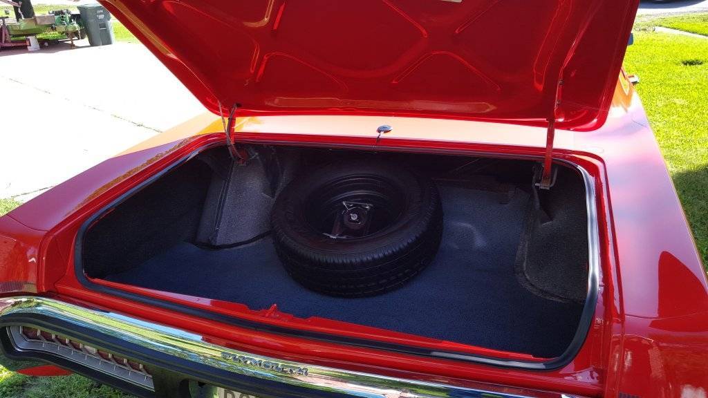

Was that sport fury badge originaly on car?
Yes and Wollfen has the same on his 71 gt
appoligies was referring to trunk badge

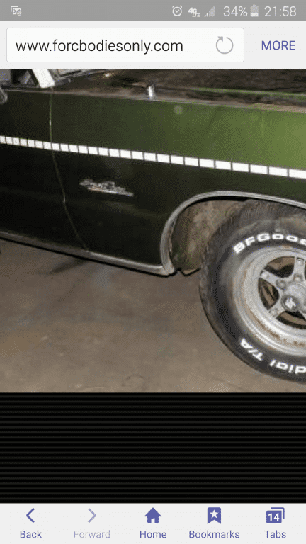

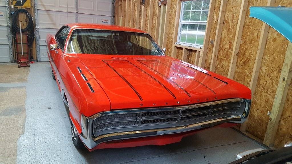

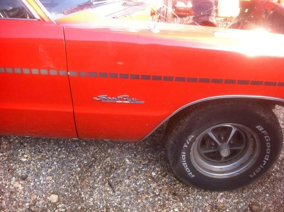

And a before picture of car before restoration
Our history on the car from the previous owner showed the car was involved in an accident in the late 70's where it was parked in a barn until it got a very amateur restoration in the mid 90's. We assume that it was during this restoration that the trunk lid was replaced with a unit from a basic sport fury. The gt emblem was long gone. If someone has an extra laying around we are still looking for one

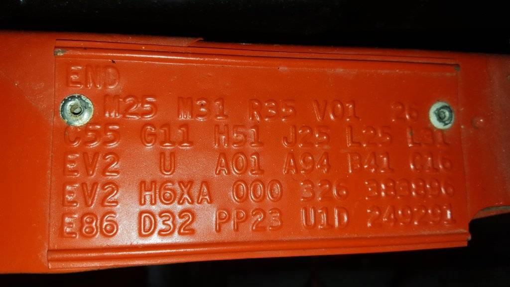

There wouldn't happen to be a V in the VIN or the fender tag? What is the SPD of the cars? Could you post a fender tag shot? We need to know more about the SPD's so we can track batch build lots.
I remember the SFGT in EV2 when it was on ebay. It was just about 60 or 80 miles north of Houston.
The owner wanted a lot of money in the beginning (like 45k $) and slowly came down to 12k.
Black bucket seat interieur.
wrong road wheels.
Wasn't running anymore while on ebay.
Has some rust bubbling up

Yes this is the same one, it's been a complete restoration. He came way off the 12k
