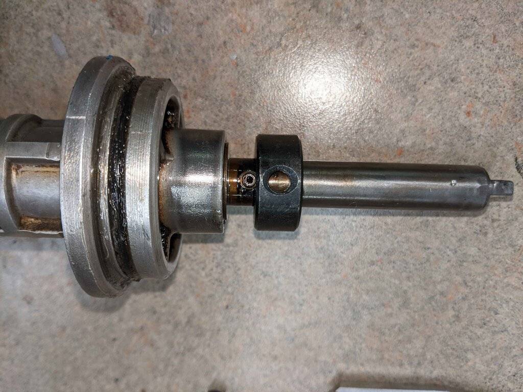

Hughes collar is worthless. Set screw opening is wider than 3/16 inch. Roll pin is 1/8 inch. Collar cannot be drilled for roll pin. Also the collar does not fit snugly on the distributor shaft. It's slightly wider than the shaft and goes up and down with slop, side to side motion. I would never install this on any distributor. Picture below is for comparison of factory roll pin and opening in Hughes shaft collar.
Ray, I'll p.m. you about a pre-drilled roll pin shaft collar.

Repllied. Note the holes are never 180 apart on the collars, no idea why Mopar never used a standard jig to drill them directly across.
The drill probably "walked" a little as it was pushed through. As long as it was pinned, nobody cared. Typical "piece work " type production.

I had some driled through 180 apart, what a mistake they all went in the trash. Typical mopar.

Putting Toolmaker hat on: I'd make the new ones with one hole. Get it in position and run a drill through the new collar and shaft, drilling the new hole on the other side of the collar. :Hat off

I tried that doing this all the time problem is the hoes are usually close then the upper bearing is usually never exact also. Way easier for me to do them for each distributor, pretty easy. I dont like to put to many shims on the bottom can interfeere with the oiling on the 72 and up ones.
