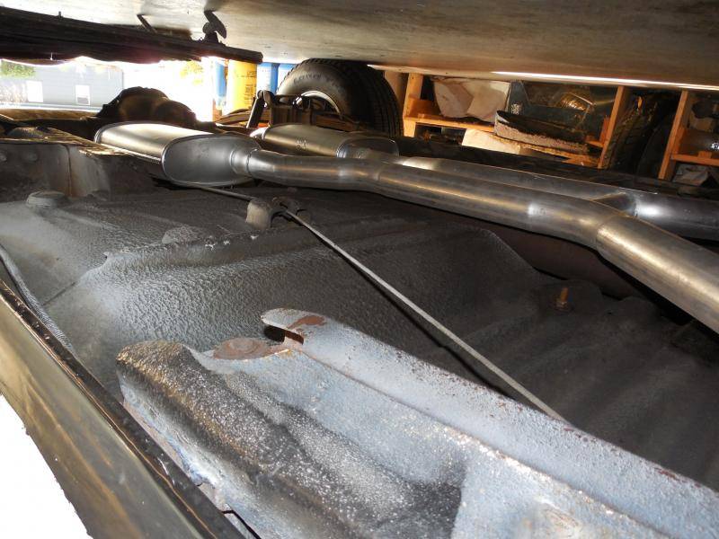

I think the cam sucks. There is not enough vacuum to run the air every stop and go it turns off. The timing marks don't line up so to time it I don't have a clue where it is. I've tried more than a few times to get it where it I think it should be but no luck yet. I was thinking of putting in something like a RV cam in it. The starter has plenty of air space around it but it does not like any heat what so ever. The exhaust is very nice.
Looks like I'm married to it. I think dropping the air and putting a 671 on it at least it will move when you drop the hammer.
UGH. The system is welded as one pc. front to back! :BangHead:
