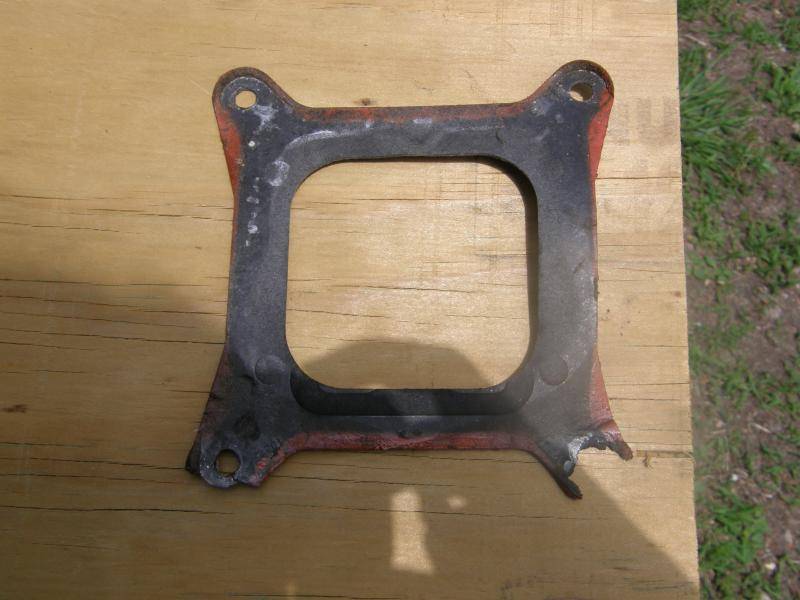

Taking some more of the previous owner out of Elenore. He had gasket sealer on the missing part. The 1/2 spacer fits with no problems and it can only help my hot starting problem. :eek:ccasion14: Now to put new valve cover gaskets for some reason he cranked the bolts down.

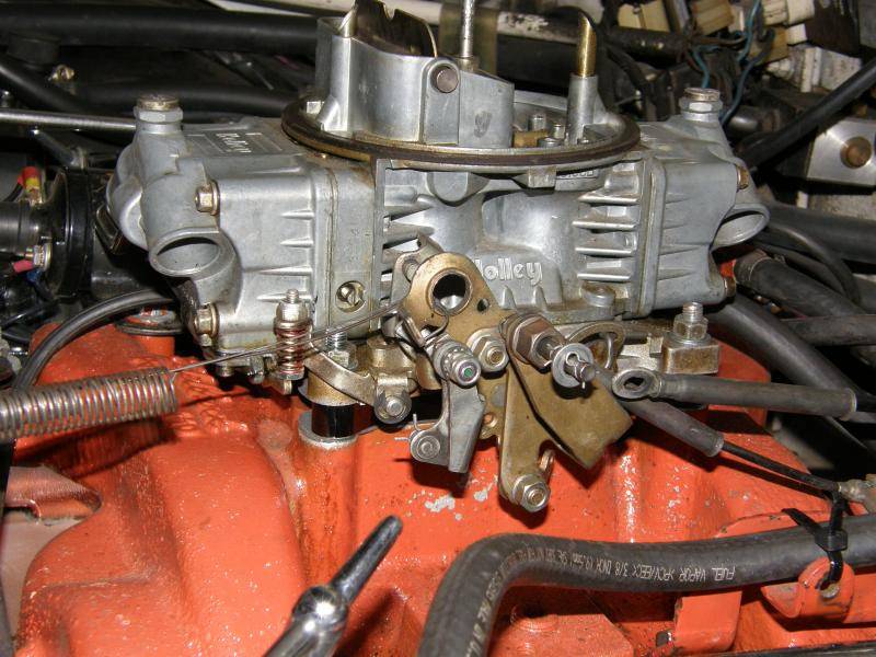

Carter are my carbs of choice, I have TQs and AFB presently
Holley...there's your problem...
I did not put it on it came with the car. I'm not a big fan of vacuum secondary Holley's some work some never do. I have a 750 edelbrock sitting here to try someday.

I put on the Holley. I like them. I had it very dialed in perfectly.

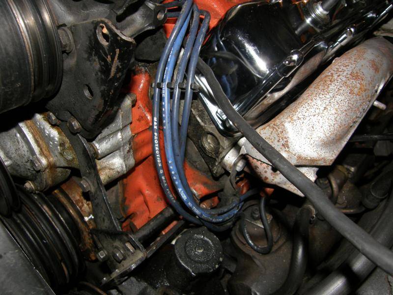

Notice the ARP bolts for the valve covers. And the coil location.
I didn't think so. I noticed earlier pulleys and brackets that would have come on 66-68 big blocks. Your engine would have come with a Saginaw power steering pump. Not the federal one thats on there. Maybe he plucked your engine for his charger and bolted in one from a clapped out Winnebago!!

Well I can tell you there are no score marks on the heads. So that tells me he pulled them off a put some piece of crap ones on it. He also changed out the fuel pump to the wrong one as it points toward the hose. The oil pan, block, intake, carb, and ignition are yours.
