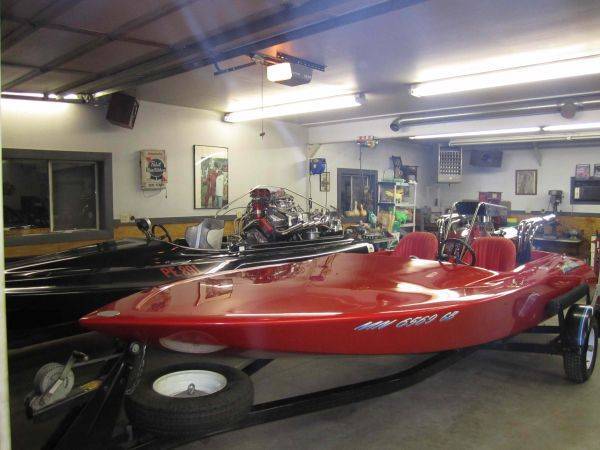

My buddy bought the red boat and is in the process of putting a blown and injected BB chev in it. I hope get a ride in it by fall.
