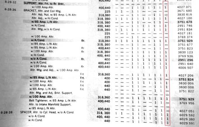

I wanted to be able to use all the pulleys and brackets from the 400 or I would of had to get them off a 440 donor. They dont interchange from B to RB engines. It looks like I will have to go with an alternative setup anyways.

No, All the brackets are different from B to RB. Nothing interchanges.
Good to know about that alternator bracket. Thought they were the same.
