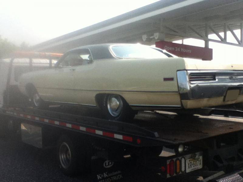

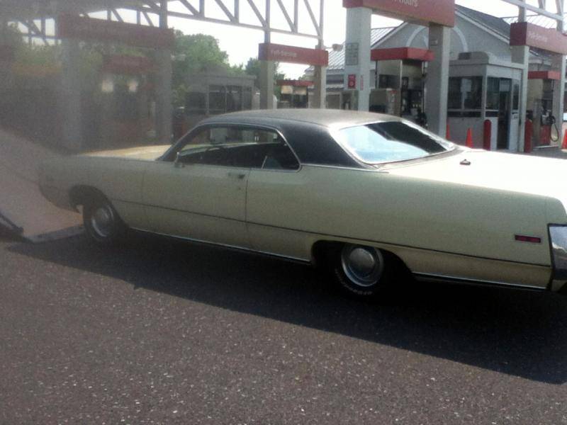

2ND time in three years on the back of a tow truck.
Today we didn't make it back under our own power. Its the ignition system, but what part of it I still can't determine. One minute its fine, the next it will not start for anything...just like that, no warning.....apparently the starter is not seeing full voltage (to fully engage). It is an absolutely random thing. Strangely, when a no start event occurs, I notice it is always accompanied by a slight "click" sound which seems to originate somewhere within the dashboard...which does not occur otherwise. The battery, batt cables, starter, starter relay, NSS....the ignition switch, and key cylinder in the steering column have all been confirmed working properly and/or replaced. Sooo what else is left ? I do not believe this is voltage drop or resistance issue as this happens randomly and without warning, cold or hot no rhyme or reason that I can discover thus far.

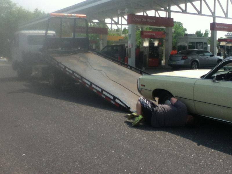

Hey Bob. The starter has been tested outside of the car and works beautifully. Yesterday morning while running around town on errands it was turning over without any effort..barely twist the key, which always puts a smile on my face. Yesterday afternoon while I was stuck I tried just about everything in the book I could think of that has worked in the past, including jumping the starter relay terminals. I also had bent up a piece of thick wire that would allow me to jump the terminals right on the starter itself. Nothing..just the solenoid "click". NSS is working properly..when the car will start that is. Some item or device in the "start" circuit is intermittently malfunctioning. I had no problems with the car up and until yesterday afternoon in front of the damn gas pumps.
