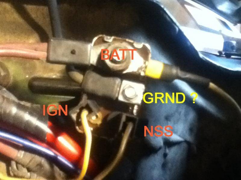

My 2 cents, the clicking is probably always there but not heard because starter turns over drowning it out, most likely a relay to kill power to hvac system/blower motor allowing all the battery to go to starter. I would take BJS advice and ground starter relay direct as your nss might be not grounding when hot or infiltrated with trans fluid, do the reverse lights work all the time every time? this is the next thing I would go after, good luck.

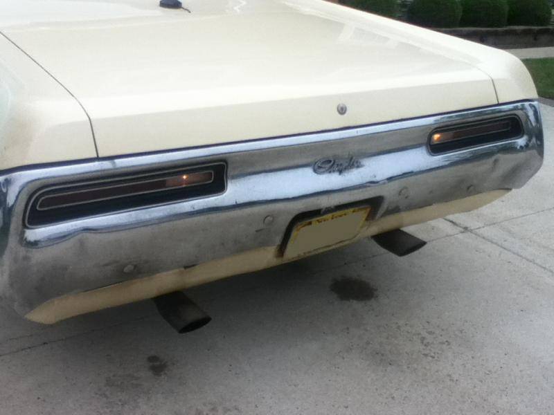

ALSO....this is pic in driveway. Running with car in park and emerg. brake engaged. This telling me something's going on with the NSS or what? First pick is with parking lights on. Second no lights on.

Yes something is wrong with the NSS. This may be what is causing the trouble. Did you try and ground the G terminal of the relay yet and see if the issue goes away?

I believe (not 100% sure) that the nss grounds through the threads when it screws into the trans so I would loosen it up and retighten it to see if that helps any. You could be loosing the ground when it gets warm or the switch its self (looks more to be the case right now) could just be going bad.
I just so happen to have a brand spanking new NSS out in the parts bin. Back to the relay for a sec......is that a ground connection?
