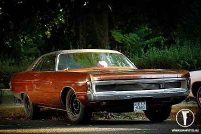

It got an ovoverhaul, about 1500 Miles ago and it still needs adjustments... Ignition for example. And ön higher rev it start to shake. And the other question is in the thermostat topic. I dunno after how many Miles the engine is ready to Go.DSC_0054.jpg
Sounds like timing or Vacuum advance is too far advanced or if a aftermarket carburetor is used may be running lean.
Once the cam is broken in for about 20 min at 2000-2500 rpm the engine is mostly broken it.
