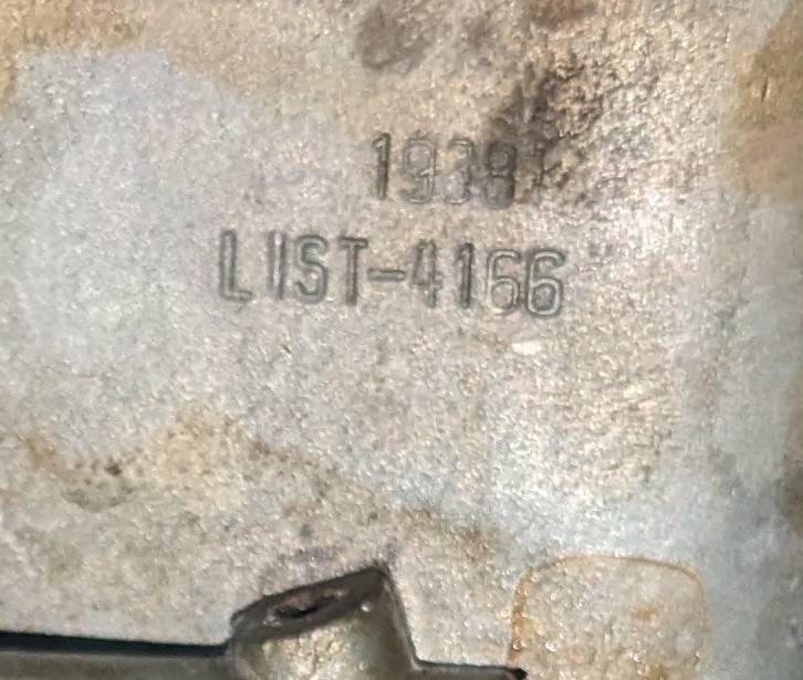

I've read a bunch of threads, I'm looking for specific guidance. Thanks!

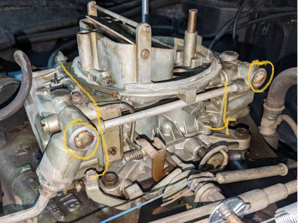

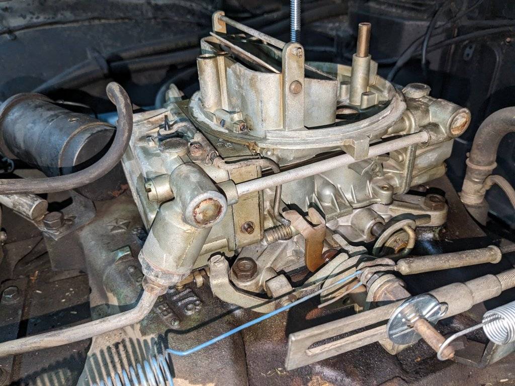

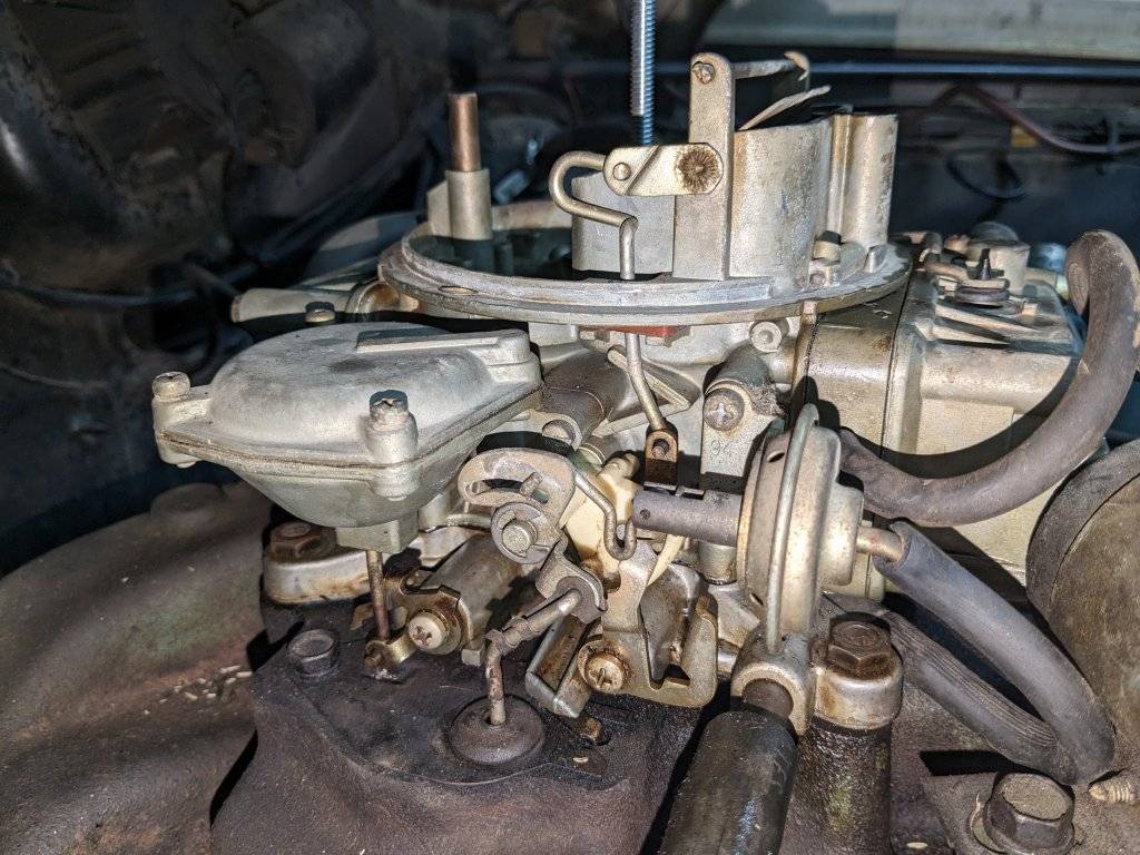

My stock Holley 4166 on my 69 300 (440, not TNT) survivor is leaking like crazy. So far I'm reading that that's to be expected and not to bother rebuilding. Is there a carb that will drop in and still use all of the mechanical choke linkage and similar looking fuel intake? Jegs has an 1850 that looks like it would work but is $$$. I have no interest in an electric choke. Suggestions? I'd like to keep all of the linkage as is.

WHERE is it leaking from? Unless the throttle shaft is really sloppy and will not return to idle consistently, THEN replace it with either a newer Holley of an Edelbrock carb. NONE of them will be as inexpensive as they were 10 years ago.
Get a quality kit from Holley, the thick Holley base gasket as the OEM used, and rebuild it.
Granted, when the cars were new, the Holleys had a bad reputation of "leaking" and needing rebuilds every year or so, but from my own experiences, that is not the case any more. The only issue with the Holleys is that when the accel pump diaphram starts to seep, it seeps directly onto the intake manifold (in plain sight, usually, which also causes a gasoline smell under the hood). That issue has a fix of sorts in a "blue" accel pump diaphram. Supposed to be more resistant to ethanol fuels.

Rebuilding is really pretty simple. Bushing the throttle shafts is more complicated but probably not needed . And I cant think of a reason it would leak besides a gasket or fuel fitting . Both are easily replaced.
Those holleys are multiple leaks waiting to happen.
in the circles there is an o ring under that metal,disc, and there is fuel pressure there so it sprays out a fine stream. That disc is peened into place. It can be removed and epoxied back in place. Not reliable, when will it leak again?
The float bowl gaskets are under fuel level at all times, plus the 4 lower float bowl screws. And the accelerator pump diaphragm also.
Those Holley’s are unreliable compared to an AVS and I replace them for reliability. A factory Holley can work, but it’s not worth the effort in my garage. I like to go on road trips so the drama of a holley isn’t necessary.
So he can rebuild it for correctness now and wait another 50 years for it to leak again.

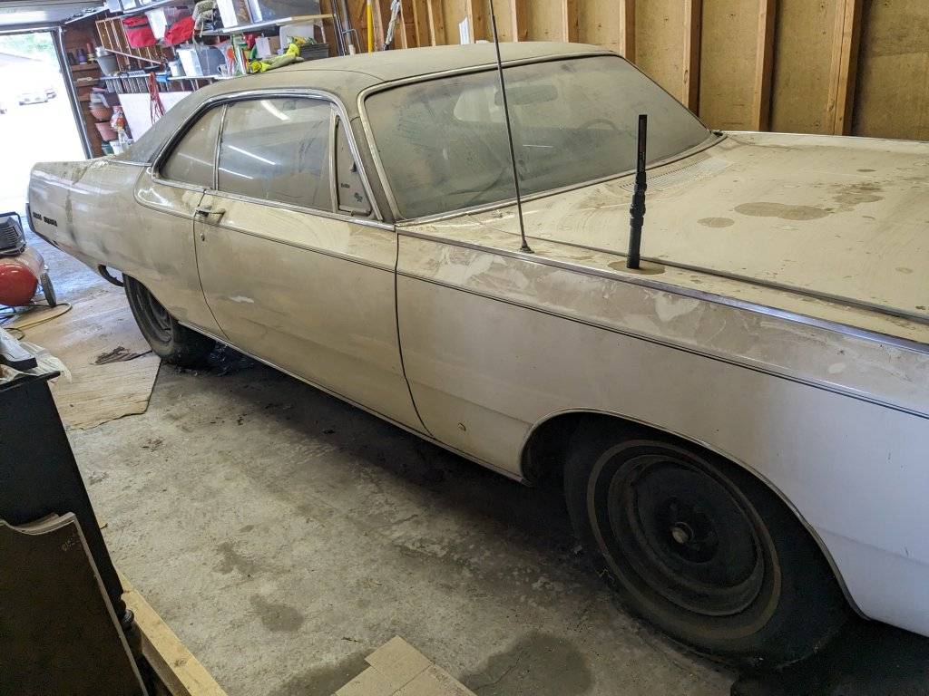

So I ended up rebuilding the carb myself and it worked out great. After a few small adjustments the car starts up easy, idles great and accelerates without hesitation. I'm pleasantly surprised and yes, it was plain to see that at least one person had been in that carb in the past (screws had marks, etc).
As far as history, I bought a 67 Charger (same situation, sat in a garage for @30 years) from the owner of this car a couple of years ago. I mostly play with Euro cars these days and was interested in having a V8 car again. I had worked with this guy and he mentioned that he had a couple in his garage and said he'd sell one if I was interested. This 69 was the one I did not buy. Anyhow, he ended up passing away and willed me some tools and the 300 "if I was interested". Funny story, his wife said that he had gone to the dealership to buy a few parts and when he came back he had also purchased this car lol. I guess he couldn't leave it there. It was parked while he was debugging the brakes and never moved again.
When I got the car home I replaced the fuel tank, alternator and the coil, put some fresh tires on it and rebuilt the carb and sent the booster to Karp's. It has a little rust but but generally speaking is in really nice shape. I may sell it this coming year, but it's easy to work on so far and I'm having so much fun driving it around that selling it isn't a priority. Maybe I'll put it on the market later this year.
Here are a few pics
You must be in southern Minnesota. We didnt have any Palm trees in the Twin Cities. Lol
