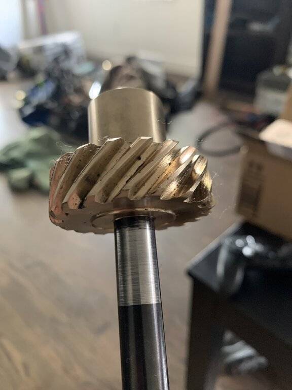

Well that distributor whack was the culprit when the clip came off. Intermediate shaft is worn out and bottom of the distributor gear. Put the cap 180 out and it moved to number 4 cylinder. Tower bushing and shaft and gear on the way.

Now who has a good trick removing that. Thread it and use a slide hammer?
