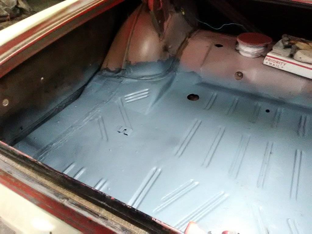

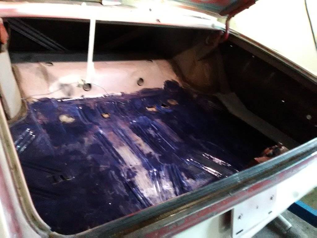

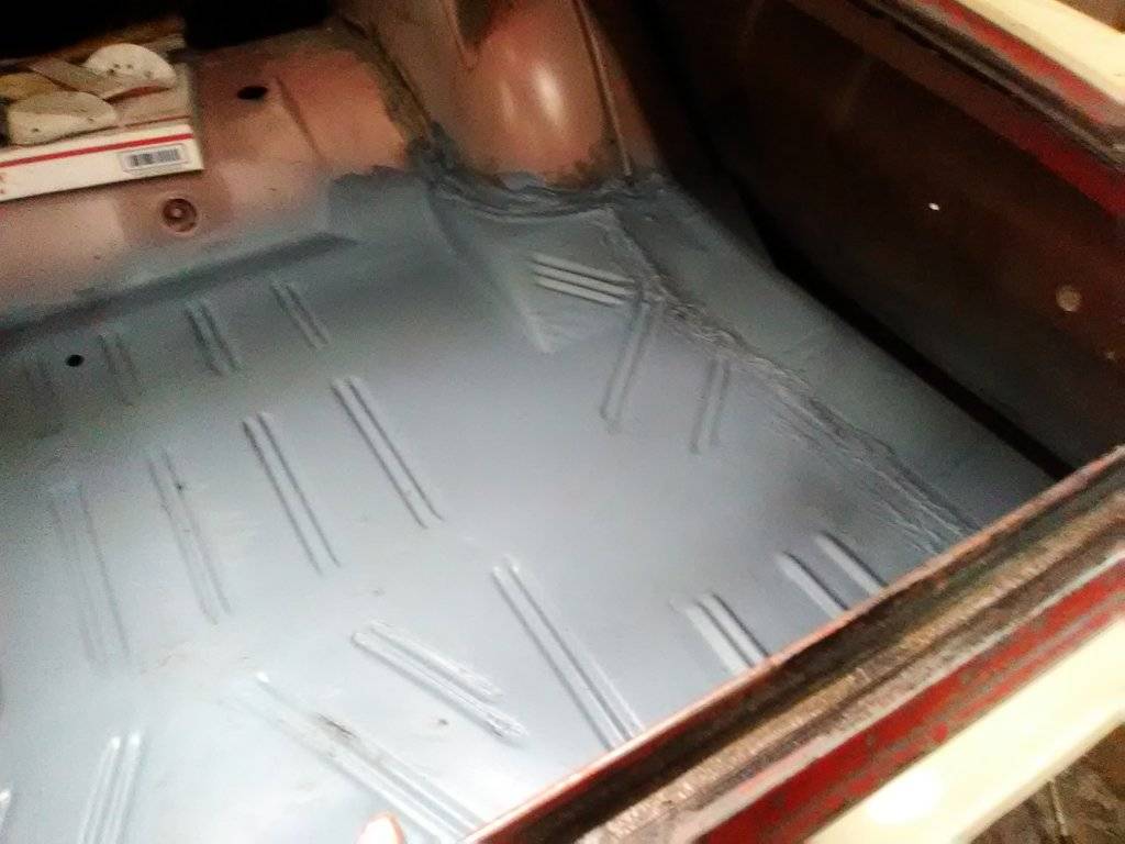

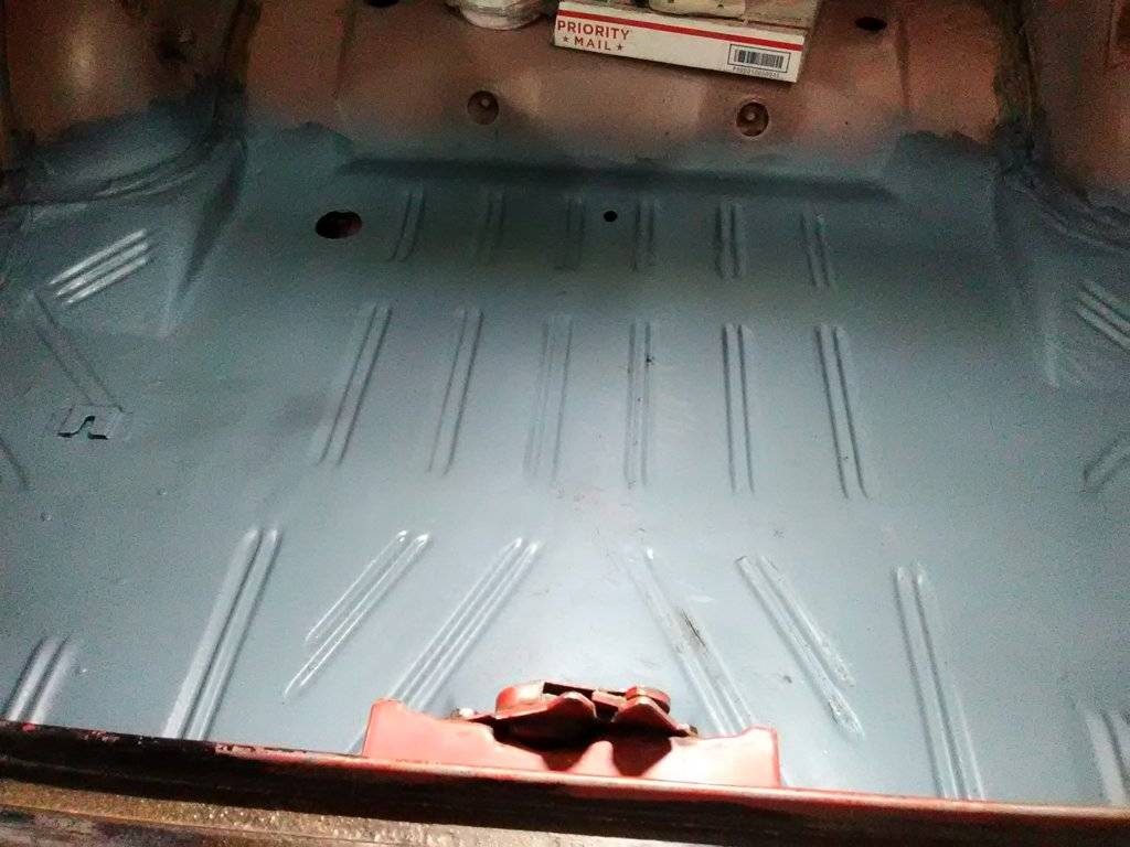

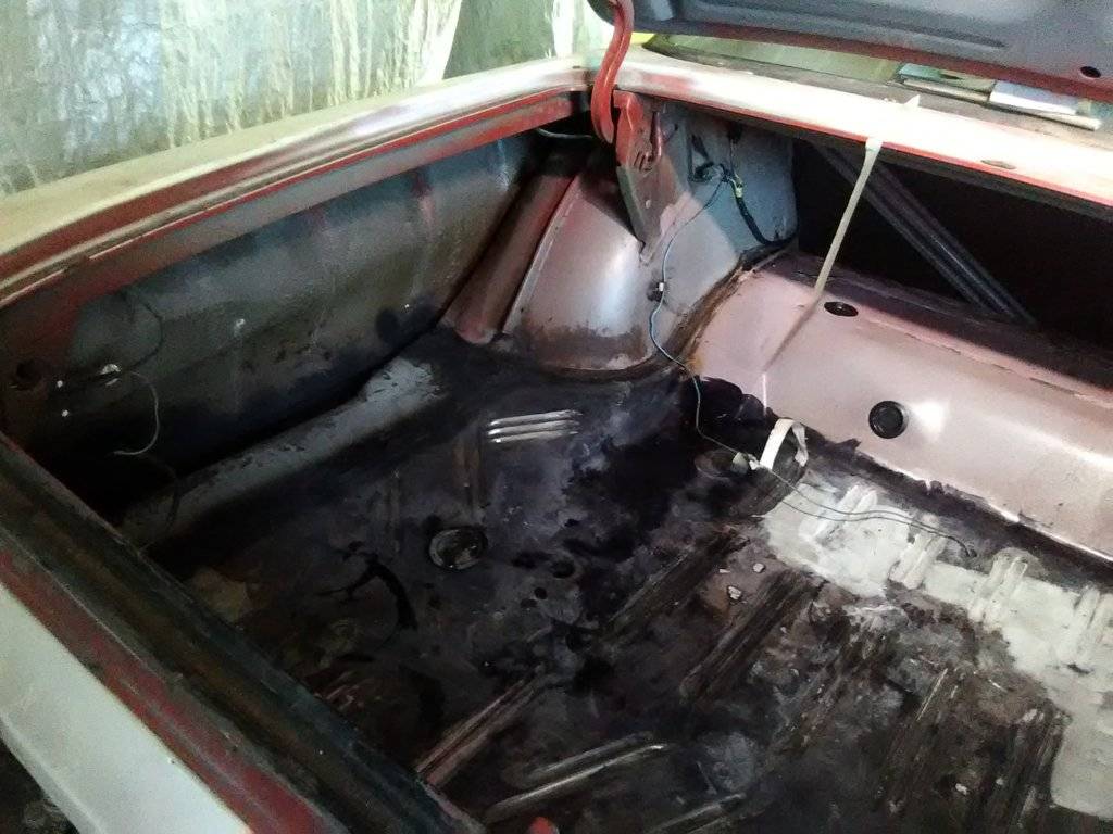

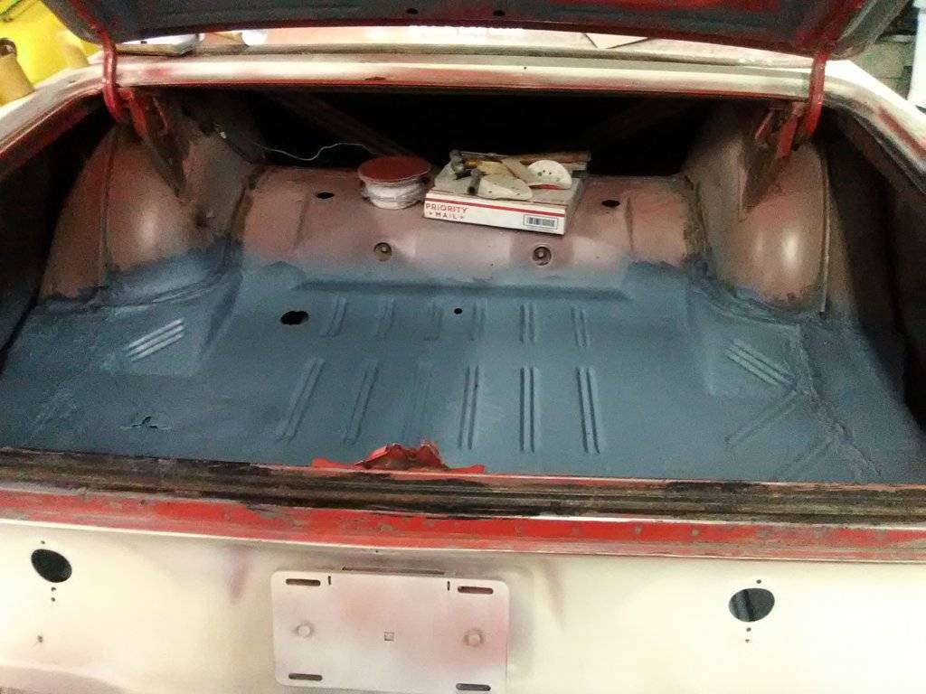

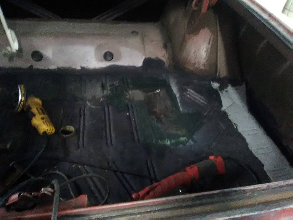

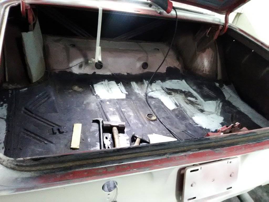

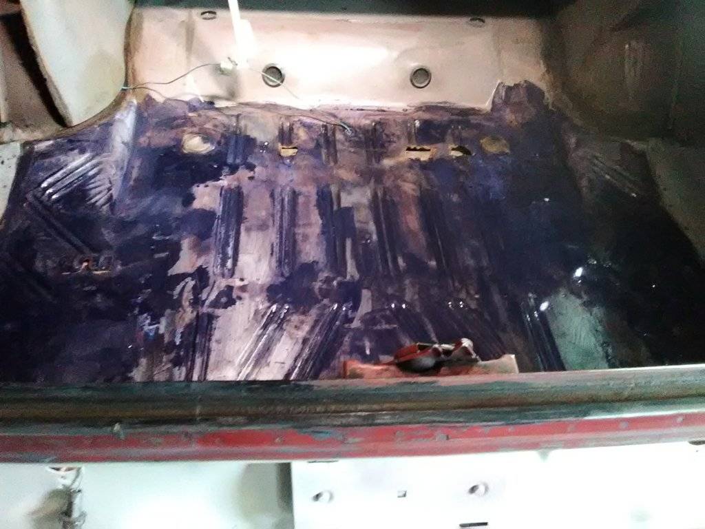

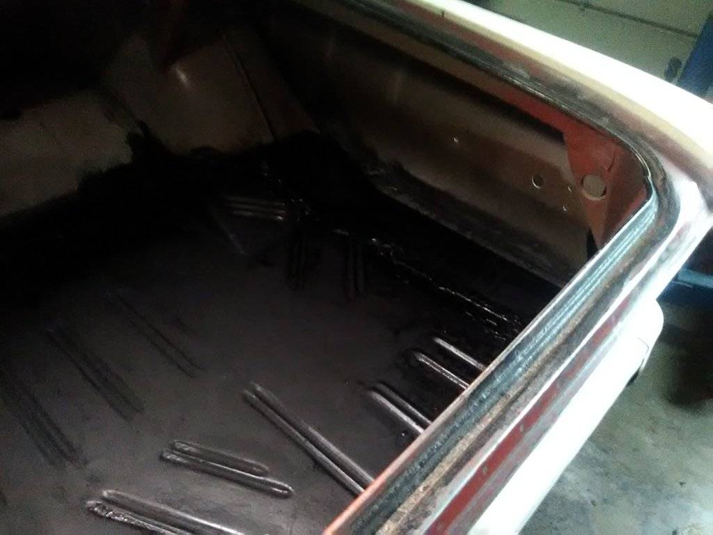

I got to apply another coat of rust converter on these and I will take a photo of that when it gets done but its late and I am not going down in the garage. OK I am back. The trunk floor was prepared for rust converter and I added 2 coats to were I needed to but I did 3 coats instead

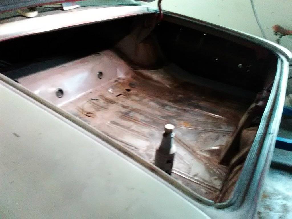

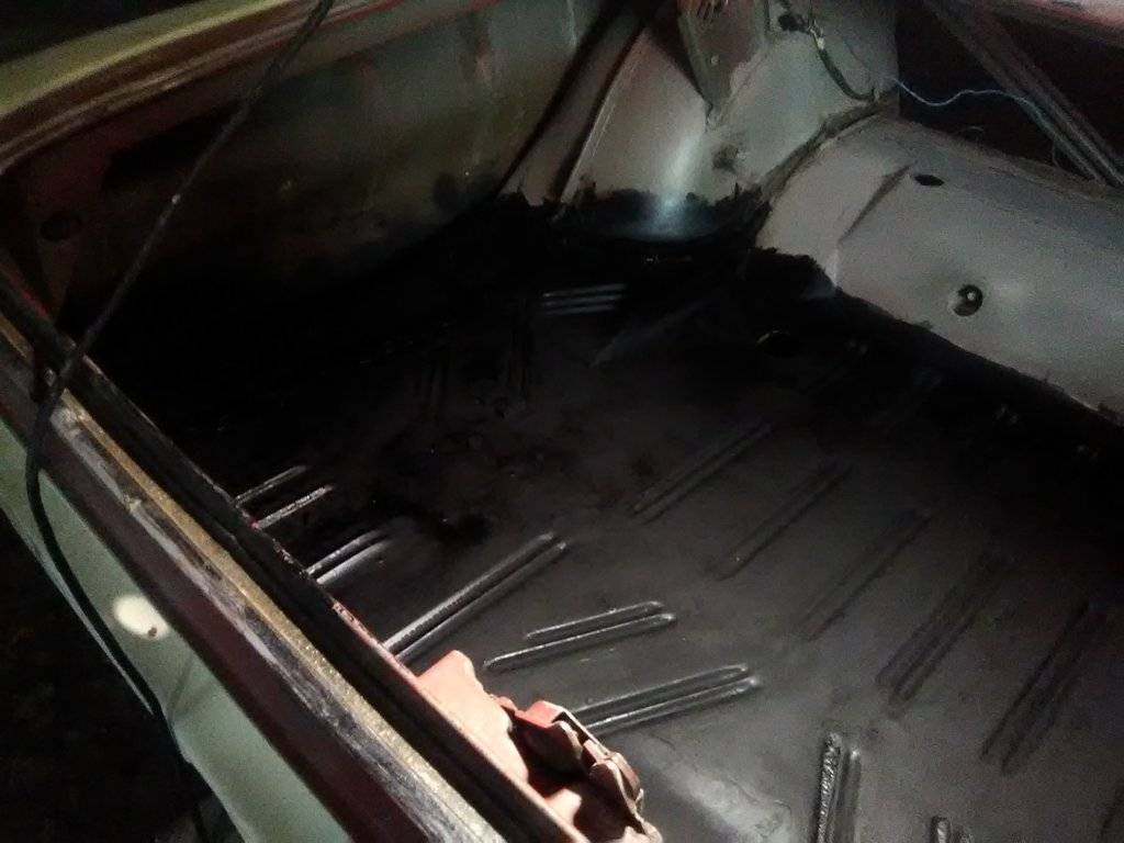

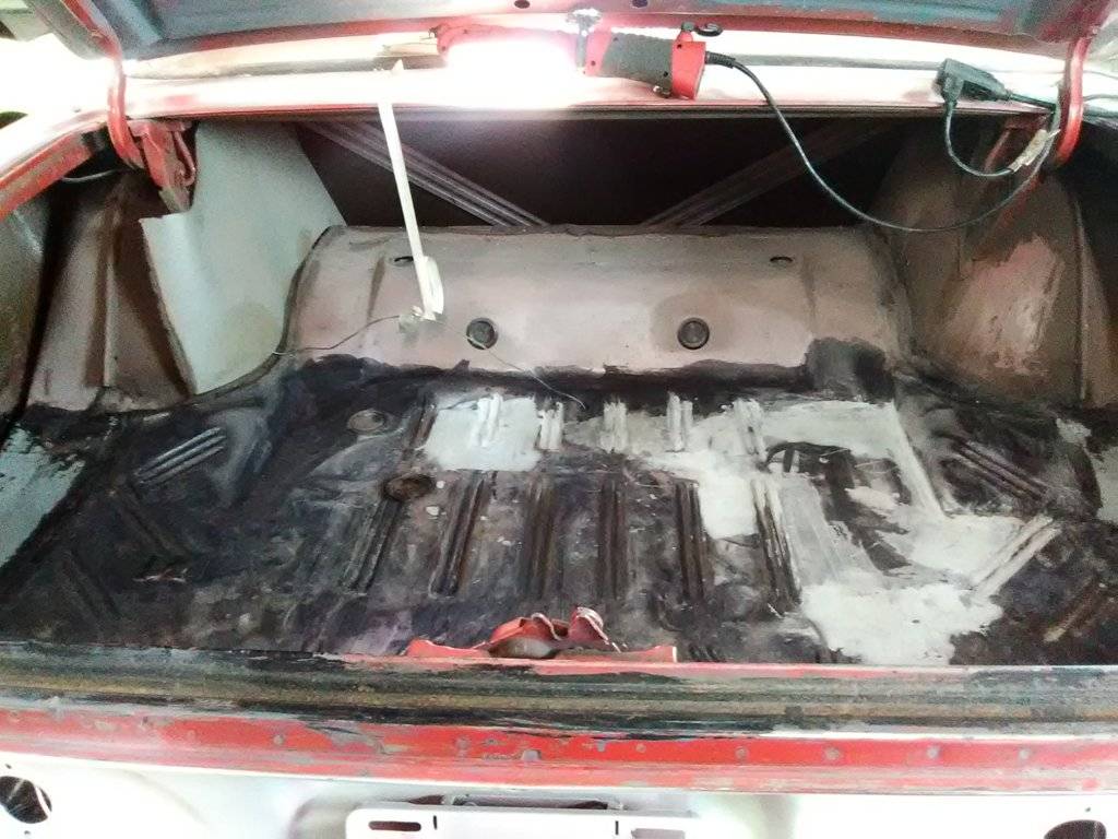

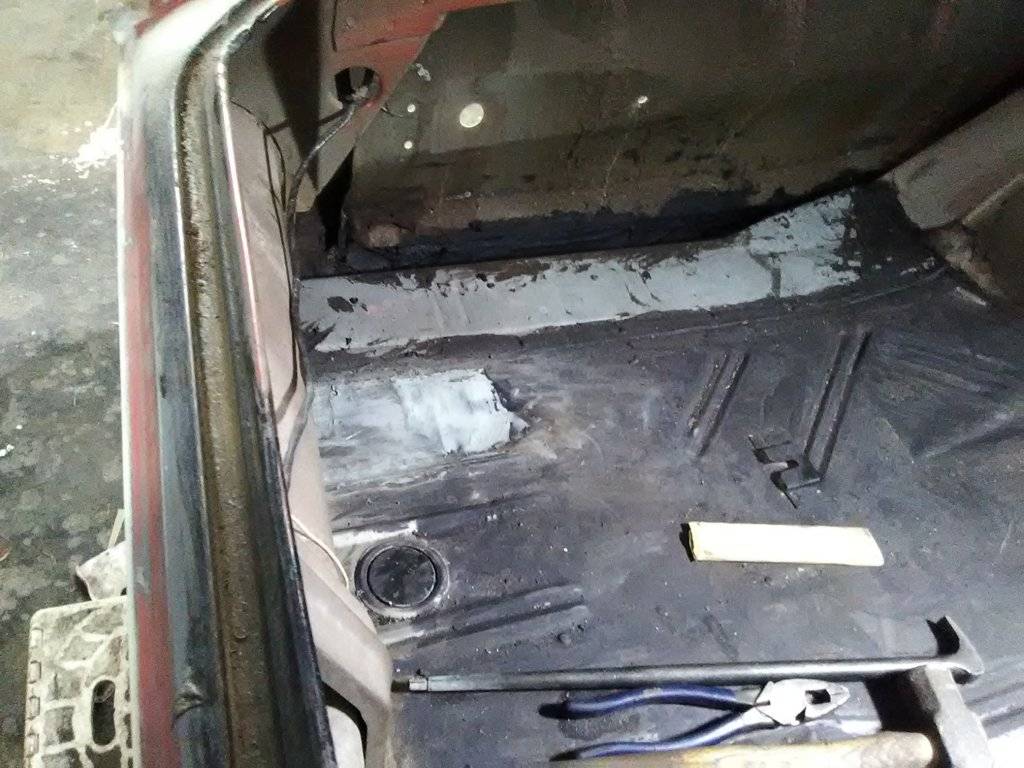

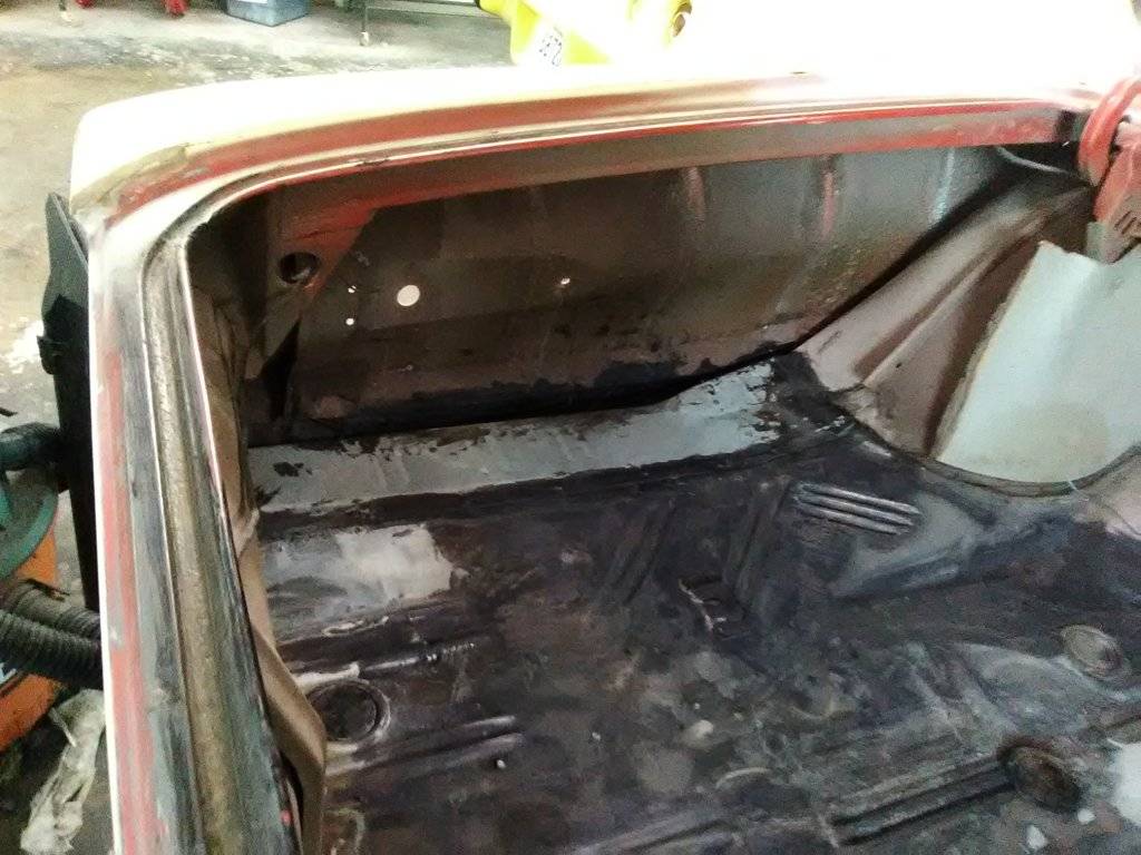

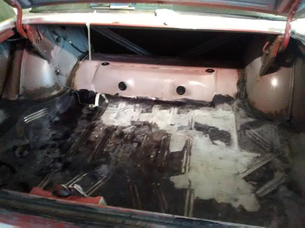

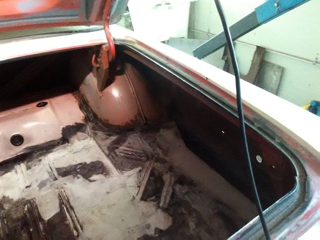

The cancer part of the trunk was cut out . New metal was welded on and the glass bondo applied . It was sanded and regular bondo was added on and now its sitting over night and will be sanded again

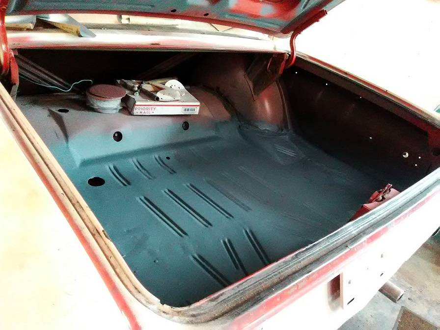

I am over the crud but I still take 1000 mg of Vitamin C and multi vitamin every day. I was informed the car will be ready for paint by spring time and back on the road . The 1st show might be TN valley mopars which will be June 16th
