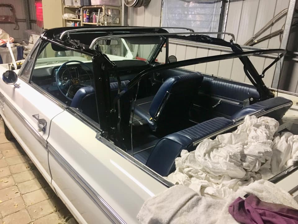

After being apart for 30 years I have started assembling my convertible top frame. Does anyone have some detailed pics of how the the top material attaches to the tub area. I believe I am missing some items.

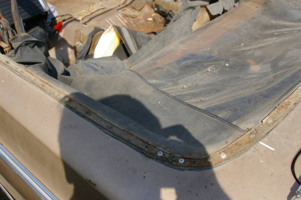

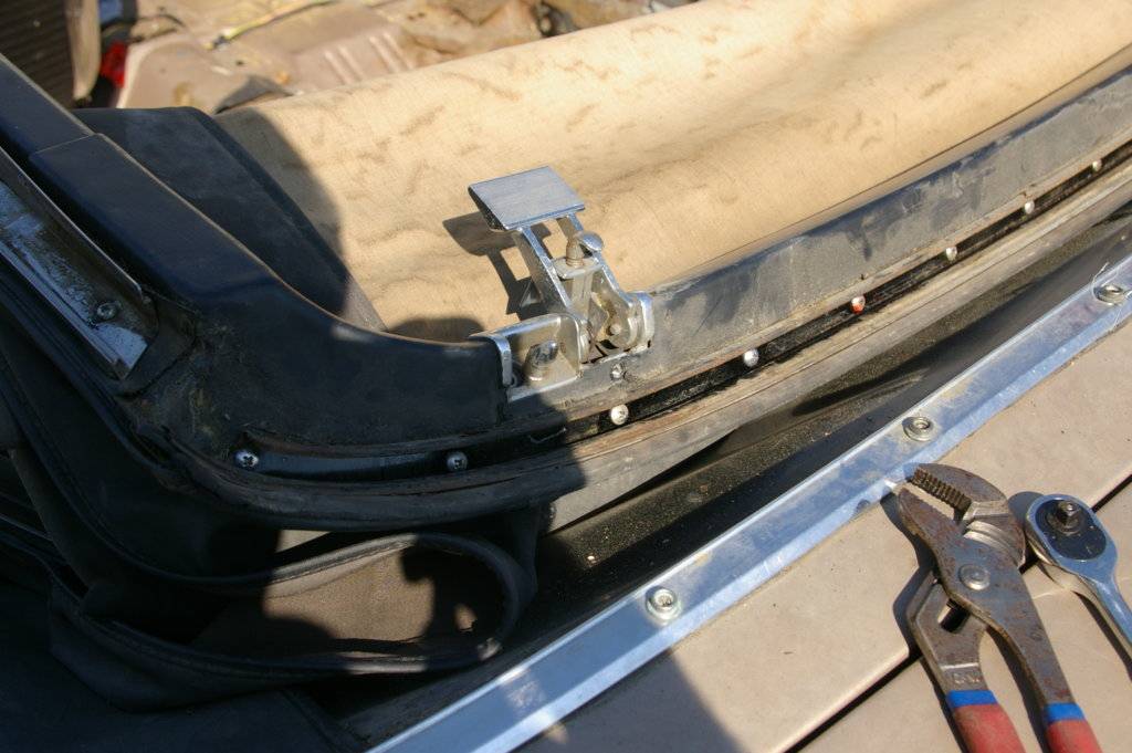

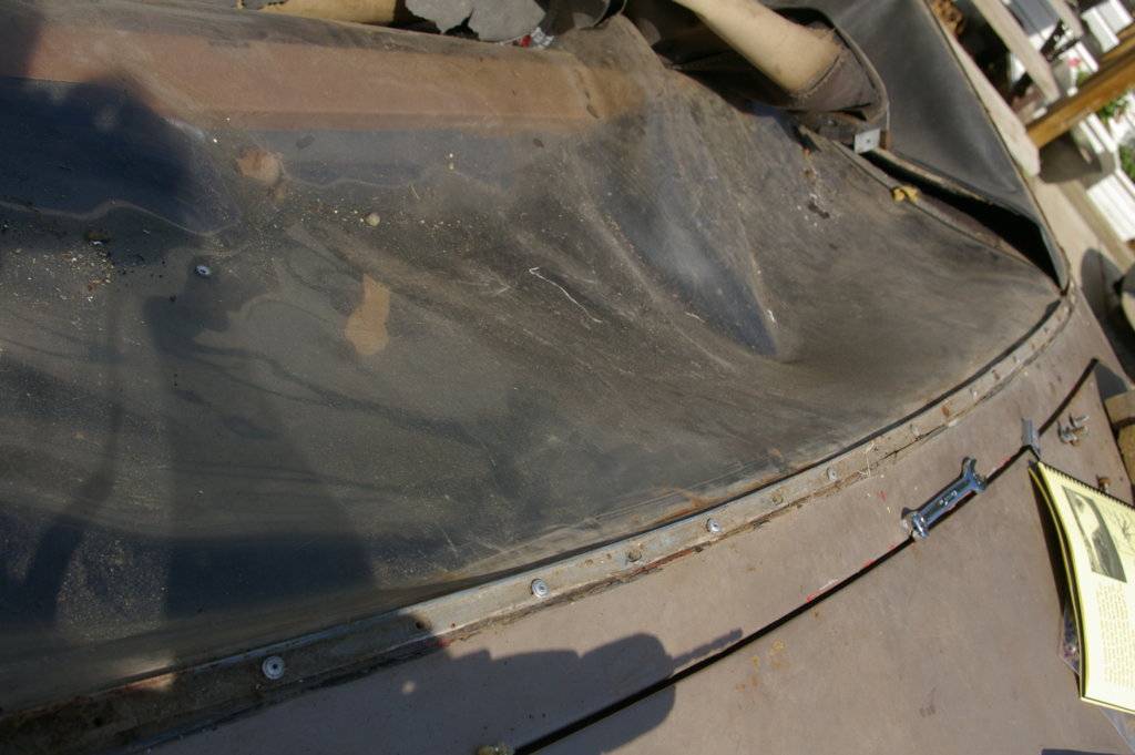

If you take the chrome off you will see how it attaches. I believe there is a retainer strip under the chrome. I’ll look for some pics later.
I’ve just screwed the chrome on. I thought there might be something that screws underneath but I don’t believe I have those bits
Found the pics. There are metal strips located underneath the chrome that retains the fabric. You will also find a similar stop along the front Edge of the top that comes into contact with the windshield.
Thank you. I managed to find the longer pieces but I’m short the corner pieces. I’ll have to try and chase a set up. Thank you for your help I really appreciate it.

It’s certainly a nice time of the year here but in s couple of months it gets too hot to be out with the top down . Skin cancer capital of the world here. I have a few spare straight sections so might do some modifications
