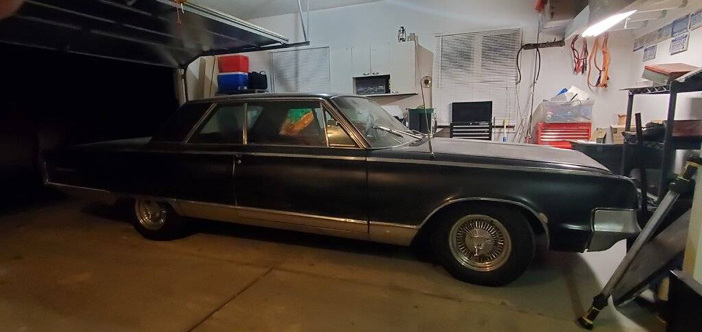

She drove to her new home...barely, ha!!!

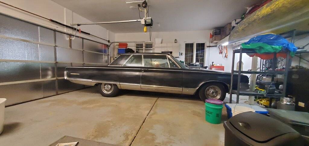

Can you out put it on coasters and park it sideways? Your garage is WAYY bigger than mine, lucky!

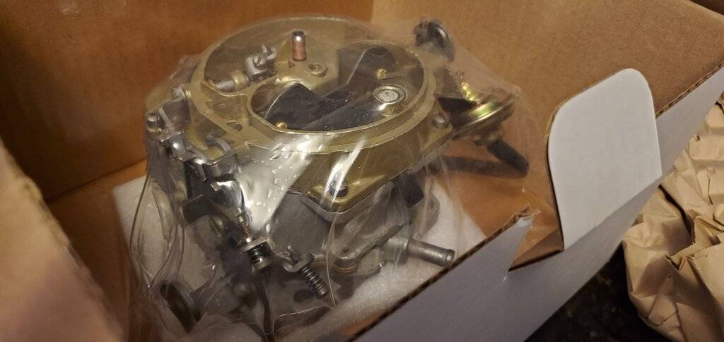

Replaced the carb, runs like a top. Improved
Breaks also, with the adequate vaccuum.

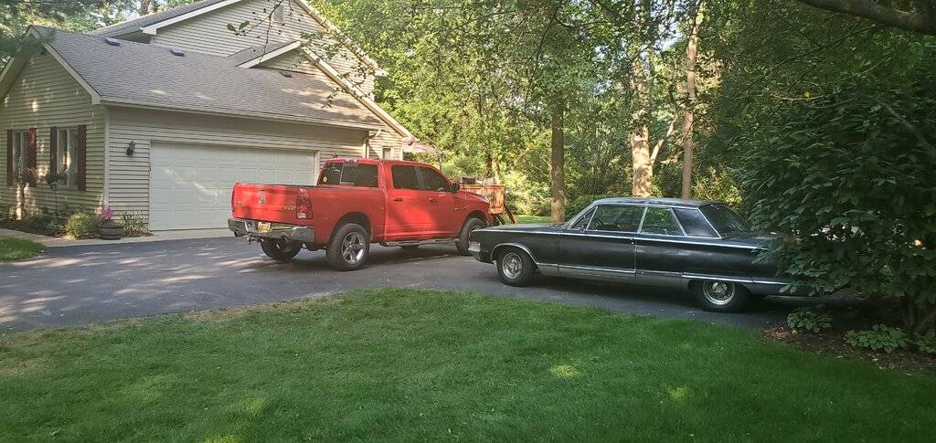

My father in law gave me first shot at his 20 year restoration with an offer I couldn't turn down, can't keep both- so sold the new yorker. I thought the brakes were good, but on his way home, he said he had a hard time stopping again...feel bad for the kid...
Here's the new yorkers replacement-
