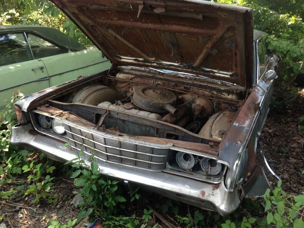

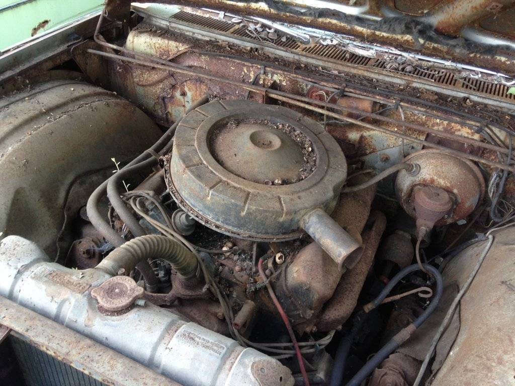

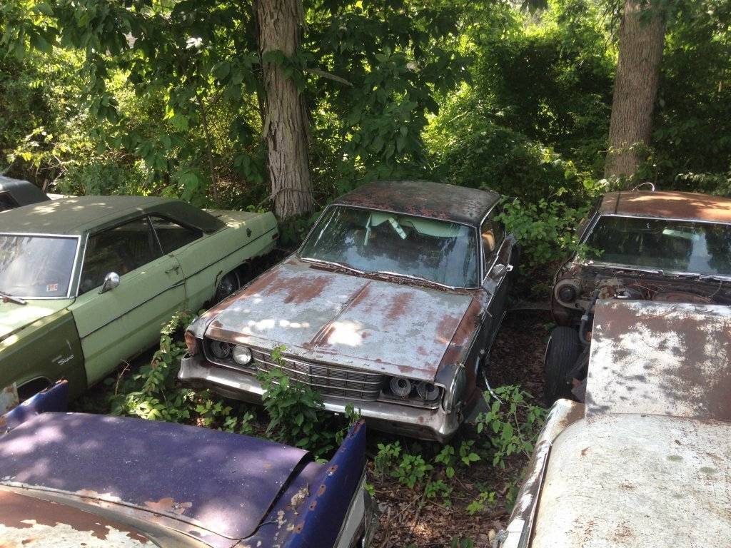

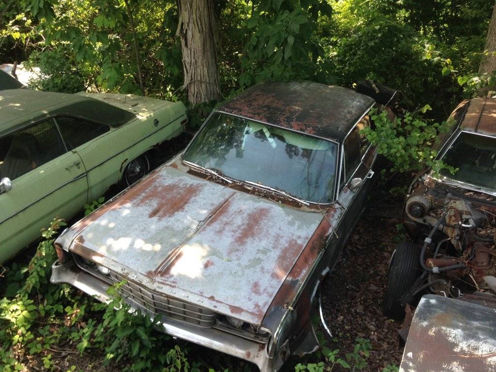

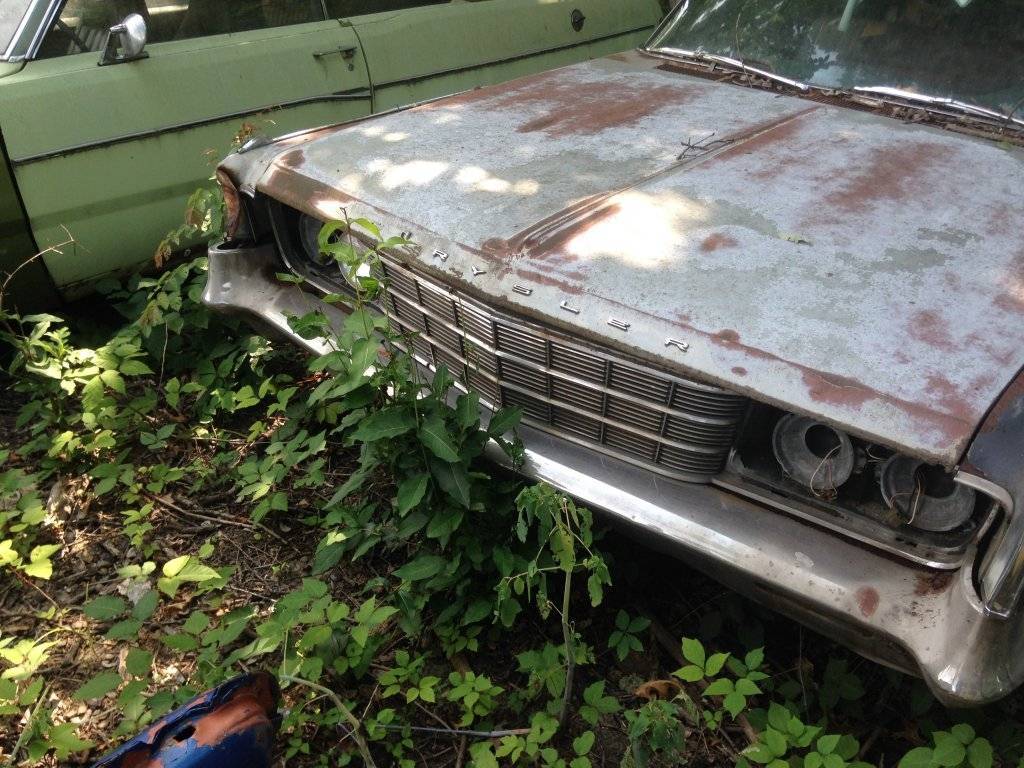

Visited a yard today, in PA. Went there to look at their '65 New Yorker.
Just thought I'd share a few pics.
What other Mopars were there? I know somebody here will tune in on that A body... I'm a Formal guy... and even though I suck at it, there are some who only want the fender tag information.
Nice find (the yard) and sorry the New Yorker was so rough...
You should go back and pull the beltline molding and harvest the clips. No one reproduces them and that car is a prime donor.
You must be 9 feet tall!
Standing on the roof of the car in front of it. It is a 3 acre lot, run by third generation. Did not notice many other Mopars. Les's Auto Salvage, Honey Brook. I want to go back maybe in early Fall and do some harvesting. I didn't take a picture of the fender tag but looked at it . The color was Persian White with red interior. Bench seats. Bumpers both dented, car had been hit in the rear. Some good moldings left on the car, yes.

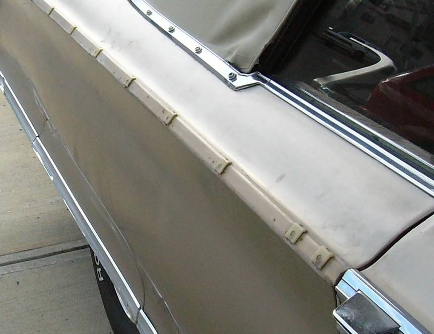

Those clips look like these. They have to be removed from the topside. The small dowel in the middle needs to be removed and then the clip can be pried out gently so you don't break off any of the fingers that hold it in place.
You should get plastic pry bars from Harbor Freight or an Auto Parts store to remove the molding. The very front of the fender molding and the very rear of the quarter molding are held on by clips that look similar but are threaded. These can be accessed through the engine bay and trunk and will have to be removed before the molding will come off. You should salvage the threaded clips too as they are also not reproduced. Don't worry about salvaging the dowels as those can be sourced from Mr. G's in Texas.
