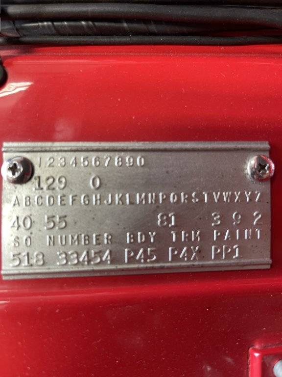

Why is the tag silver? Shouldn't it be body color? Is it a reproduction?
Those screws holding the fender tag in place are not factory, at least based on later Plymouth cars. They should be rivets. I agree that fender tag was painted silver separately.A lot of people have them off the car when it's being painted and then either don't have a paint code to get more paint mixed to paint the tag, or just don't care if it's body colour so just paint it bare metal grey and put it on the car. As long as the tag is present I personally don't care what colour it is...;)
