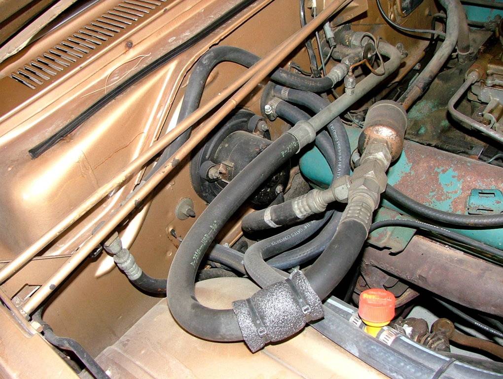

    I have the roof mounted rear a/c unit in my wagon, it is a complex installation. In addition to what Xenon mentions above you should get the underhood high and low pressure lines. Since the rear system lines connect to them with tees it would be helpful if only as templates for new lines.

    This would be a major undertaking to install. If someone still has access to R-12, it might be worth doing as part of a complete restoration, but otherwise it would just be a PIA. These units will eat compressors often on R-134a because the compressor oil does not circulate well enough to keep the compressor lubricated. This is an even bigger problem on dual evaporator systems. It could probably be made to work doing the Sanden conversion, but that would be a lot of work just to have rear seat air.
