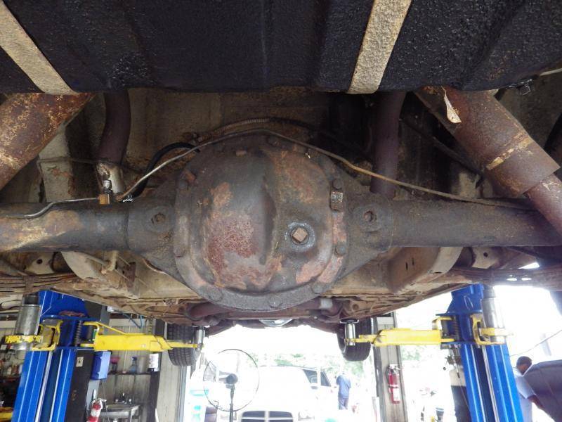

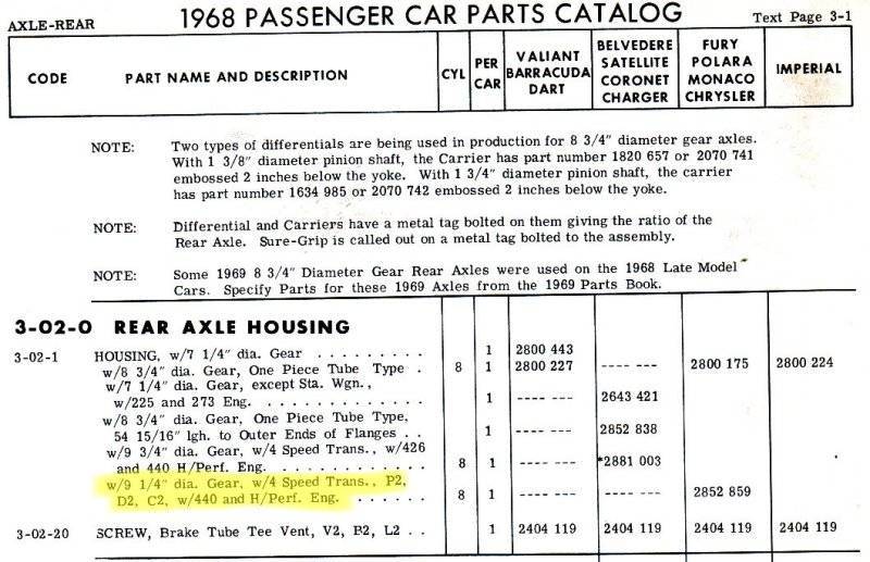

Can anyone tell me what rear end came in a 68 440/4 speed c body? I was thinking 8 3/4 but wasn't sure.
There were no C body Dana 60's but there was a 9 1/4 but I was thinking those came to use later?
No Dana lol
To be sure they came with a 8 3/4 if it's a 440 4spd/auto.
Cool and rare car if it's a factory set up.
Dana 53.
For Sale - 1968 Sport Fury L Code 4 Speed Dana
Can't say I've ever heard of Dana "53" axle. Much less as factory installed option in a C body. I was thinking Dana 60 as an option in '68 behind a 440 4spd which Im still saying no..
But interesting if that is truely an original part..never say never!
Yeah, and if you read the post everyone is saying they think it's a 383 car. But I'd like to know just for the sake of knowing. But the standard factory rear
I saw one in a new Yorker with the 440 and a four speed. But You could order one as well. It could be bought with other features, such as Towing packages, etc.
