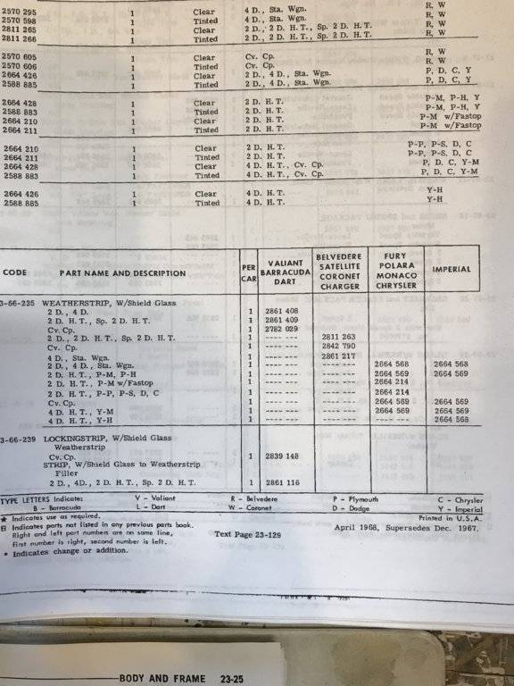

In search of a windshield gasket for a 68 300 2dr hardtop im being told theres a difference between the 2dr and 4dr version and help would greatly be appreciated i have checked ebay there going for around a crazy price of $200 a totally ridiculous price
The 300, Polara, Monaco are only Fastop at least in 67 & 68. The Fury can be both. Seems to be a pretty broad coverage, but Jim from DMT has usually been pretty accurate.
68. W/sheild glass Weather strip 2644214
2 dr ht p-m w/ fastop,
2 dr ht- p-p, p-s, D,C (your car)
2 dr Fury ( non fastop), convertible,4 dr and Imperial are different p/n’s.
Not sure the exact difference. An e-mail to DMT could clear it up.
Let us know the results
