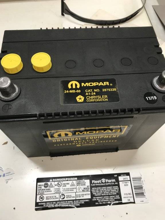

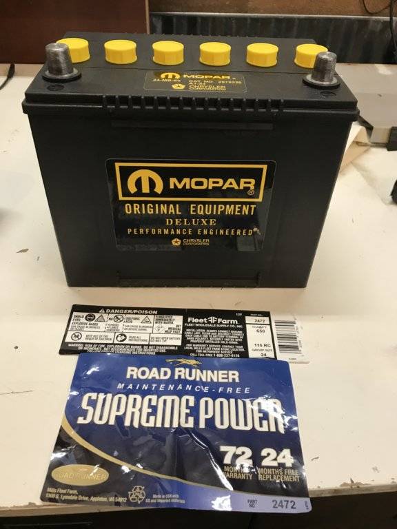

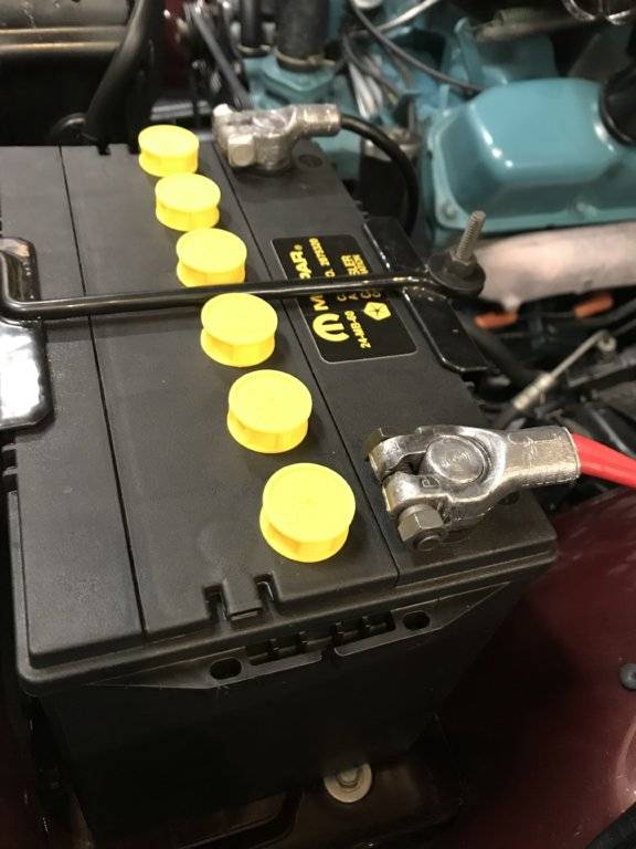

    12 year old battery bit the dust. It sat idle many years during the restoration.
    I found a yellow battery topper kit on e-bay. It actually came from Europe. (Maybe something to do with licensing?). Anyway found a flat top group 24 Fleet Farm battery 650 CCA for $94. All the 725 CCA batteries were about $160.
    I took off the stickers and put my kit on. Probably not 100% accurate, but looks better than a modern looking battery.

    Looks great, I just hope you get long life and don't need to warranty it.:rolleyes:

    Hey it’s engraved and I still have the tags. I would have to get another $25 kit though.

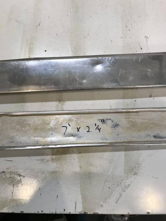

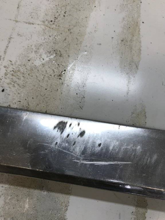

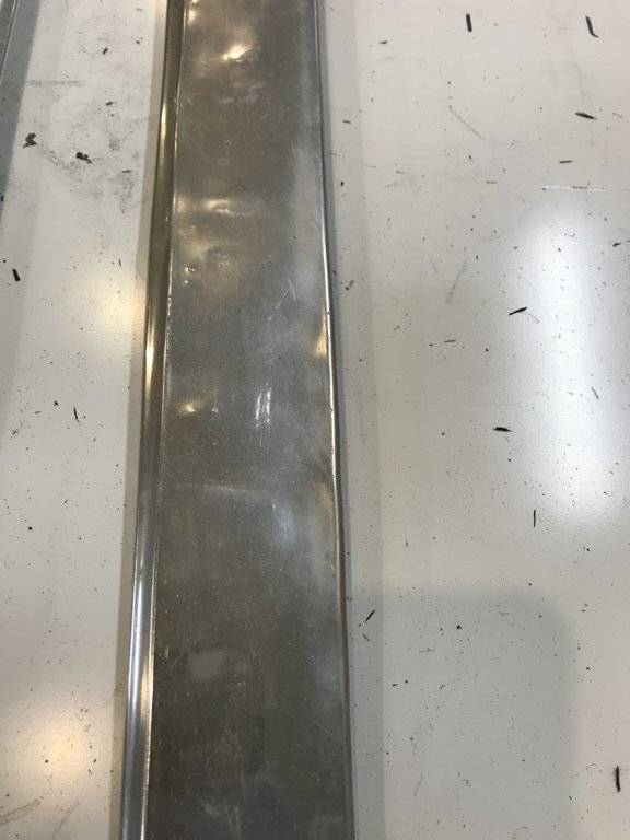

    It is probably about time to post my wanted list. At this time the crowning Cherry would be my body sill trim that goes under my door. NOS seems to be pretty elusive.
    I did find some a few years ago, but didn’t have the cash at that time as I was getting hit pretty hard with my painting bills.
    I do have my originals, no pitting, but dings and dents galore from growing up on a gravel road. Because they are so long and straight. Nobody wants to touch the straightening job.

    WOW!!! That would be extremely time consuming and would require some extreme patience. I won't say it can't be done, but wow.

    It’s such a long straight line and flat piece that it would be next to impossible get it to where you wouldn’t get ripples.

    No they are anodized aluminum and nobody really wants to touch them.
    I might strip them and start tapping on them I have nothing to loose. (But time) The good news is they are fairly thick, so can take some sanding.

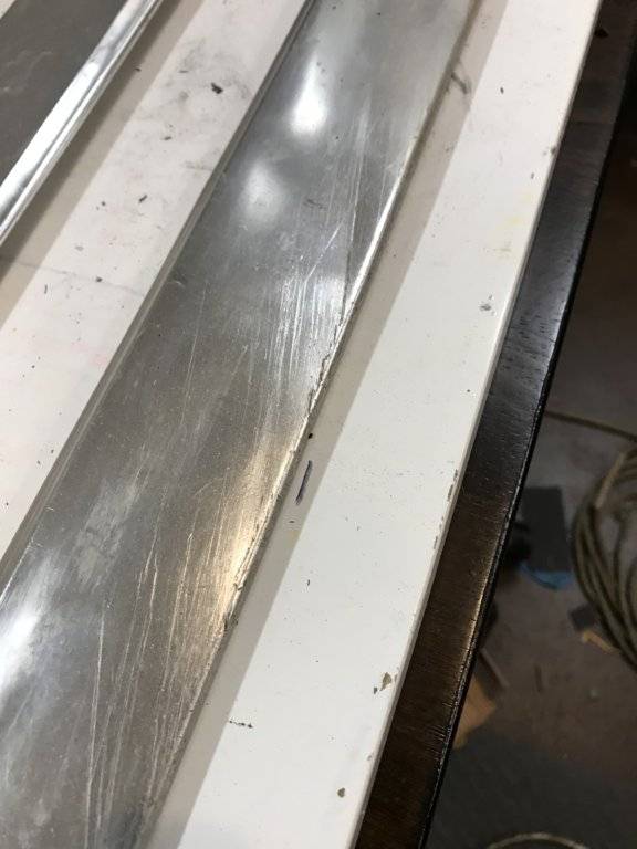

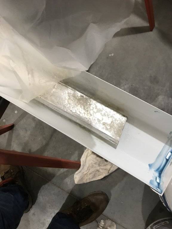

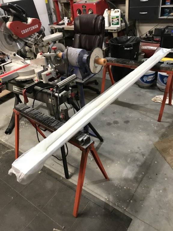

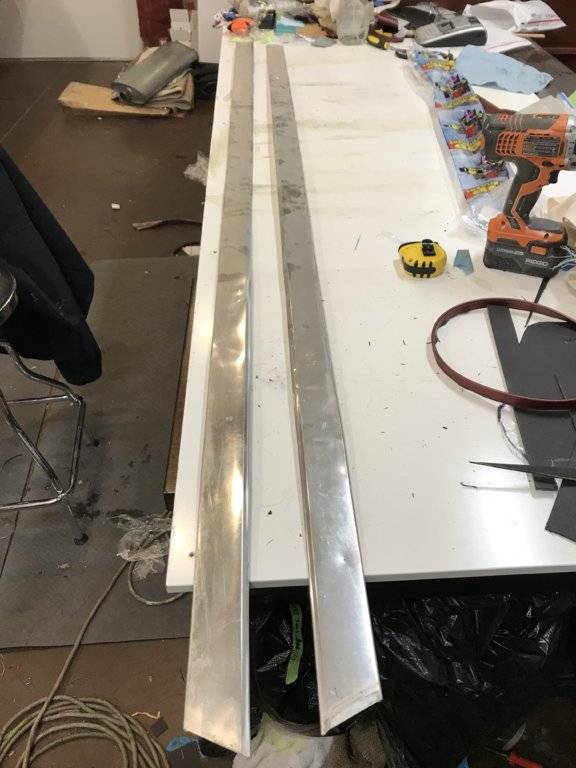

    E45BF1EA-945C-4D84-9016-EFD73792B883.jpeg 0116FF7A-8450-4834-A12D-D8100CE7DD6E.jpeg I am going for my sill trim (shown a couple posts above). I am on vacation until Jan 2nd so maybe can spend some quality time bumping the dents.
    I made a trough out of a large plastic rain gutter and sprayed it down with easy off oven cleaner to strip the anodizing. I need to make a back dolly to mount in my vise to hammer against. Maybe I will start a process thread and save this one for the results.
