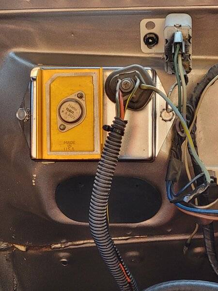

i was recently told by my mechanic that the reason for my vehicle stuttering at red lights and hard starts is the original ignition box i still have installed. he also pointed out where the ignition box appears to be melting down the inside of the engine bay! he suggested i get a 6A MSD digital ignition but i wanna get the C-body guys opinion????

MSD is probably overkill on a stock engine. Gunk running off the back of the unit is from the plastic resin breaking down over time, that stuff is used to seal the unit from outside contamination. AS long as the electronics are not exposed, that does not hurt anything. A bad ground to the unit will cause the symptoms that you describe. If you have a good ground, then I would replace the box with a factory style unit. Avoid any reproductions made in China, they a generral all crap.

The "original" ignition box was added as your car came with points when new. The melting is the potting material in the ECU box degrading from heat and age. This is basically a plastic resin type stuff that poured in there when it was built to help keep the internal components in place and not break from vibration. They tend to melt, but generally speaking that isn't a failure.
It's not a bad idea to replace it though, as it's making a mess. Keep it as a spare though.
Your hard starting/stalling problem could be a lot of things, but an add on expensive ignition box isn't going to do much besides drain your wallet and fatten the wallet of your so-called "mechanic".
My suggestion is to figure out why it's stalling. It's more likely a carb or some ignition issue. Bad ground to the ECU is common and easy to try. Also, find a new mechanic.

The potting compound "melting" is more of a cosmetic issue than not. DO make sure the ECU is grounded, even if it means an extra wire to ensure such.
