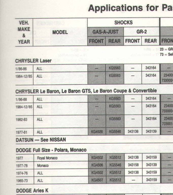

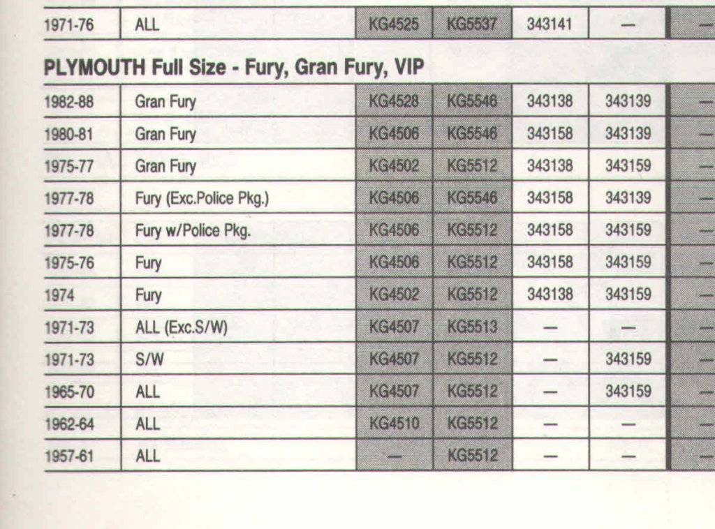

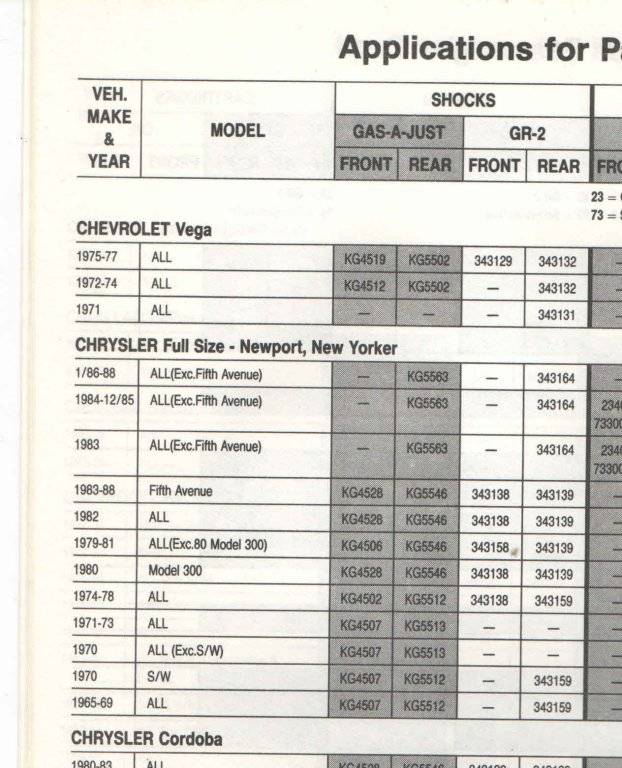

KYB Gas-a-Just Front & Rear Shock Absorbers Kit For Chrysler 300 1965-1969 Dodge Monaco 1965-1973 Plymouth Fury I Fury II Fury III https://a.co/d/dAAaS8N
I definitely agree with KYB. However, the Amazon seller in your link is wrong on one count. For 1971 through 1973, Plymouth full-size and Chrysler full size, the correct shock is significantly longer. It's out of production and KYB buyer needs to go with a D150 shock for the same period. 1988 KYB paper catalog below. Rear shocks are listed in the 2nd shaded column from the left.
Good to know!
No issues with applying it in a 69 or 70?

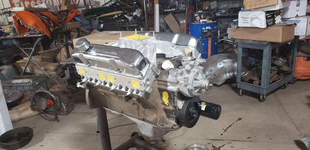

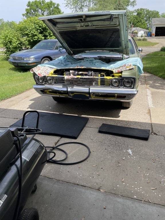

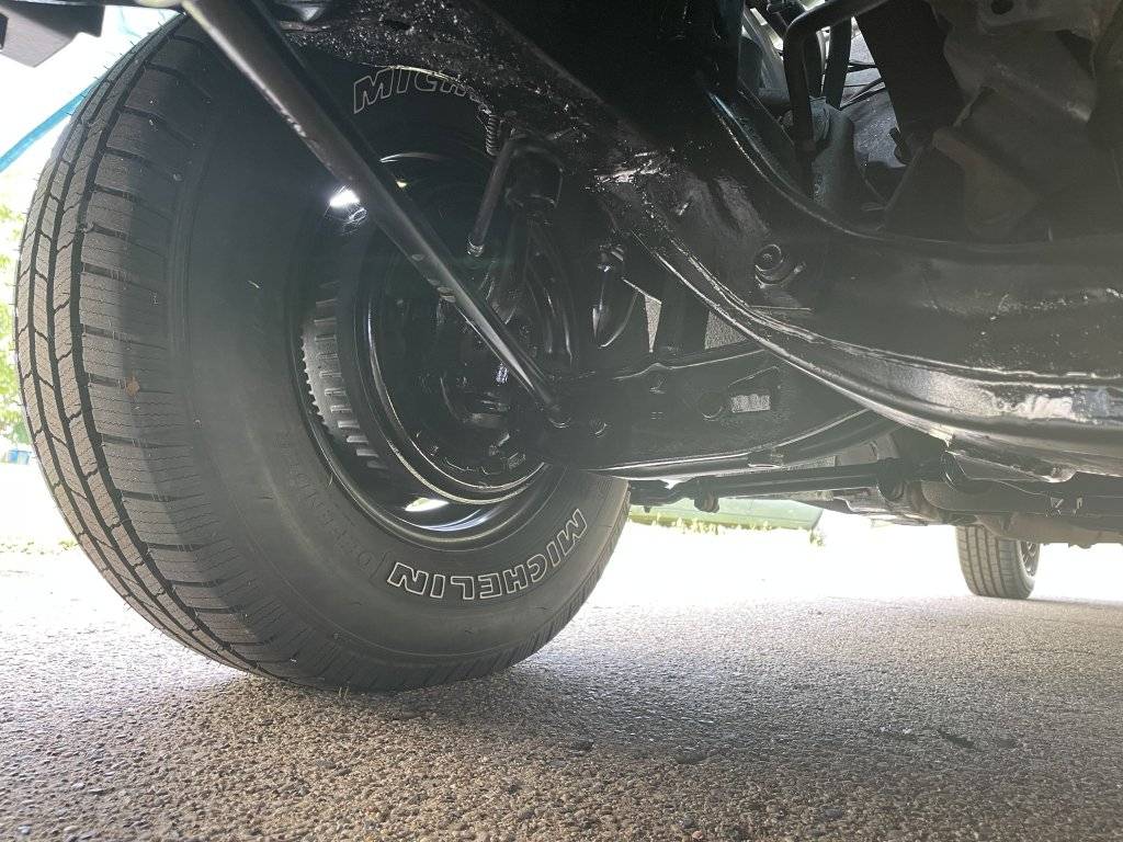

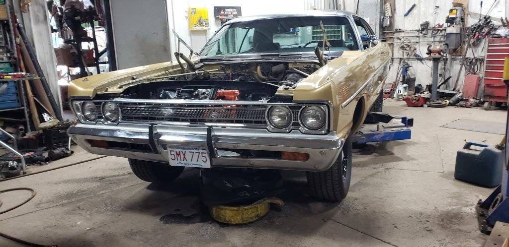

Here are a few pics 69mopar man. I am sorry I don't have a Gallery or Showcase spot as I could never get it to take my pics. The engine was just installed a week or so ago. It is a 440 stroker bored .030 and stroked to 505 cubes. It is in the process of being installed in the pics. It has 440 source Stealth aluminum heads which look stock when painted and hence the name ,they are ported, Holley single plane aluminum intake [for carb/hood clearance] ,as well as aluminum water pump and housing ,custom ground roller [hydraulic roller] cam by Dwayne Porter to work with HP cast iron manifolds. Bla bla bla and I wanted it to look as if it came from the factory. Big thanks to @FURYGT and @MEV for their inspiration as they really influenced me to go this route. {Look them up here on this forum] With highway gears [3.23] this thing pulls hard on pump piss now and I can putts around town in traffic with power brakes and not even come close to getting a warm/hot engine and cruise the highway with ease.
