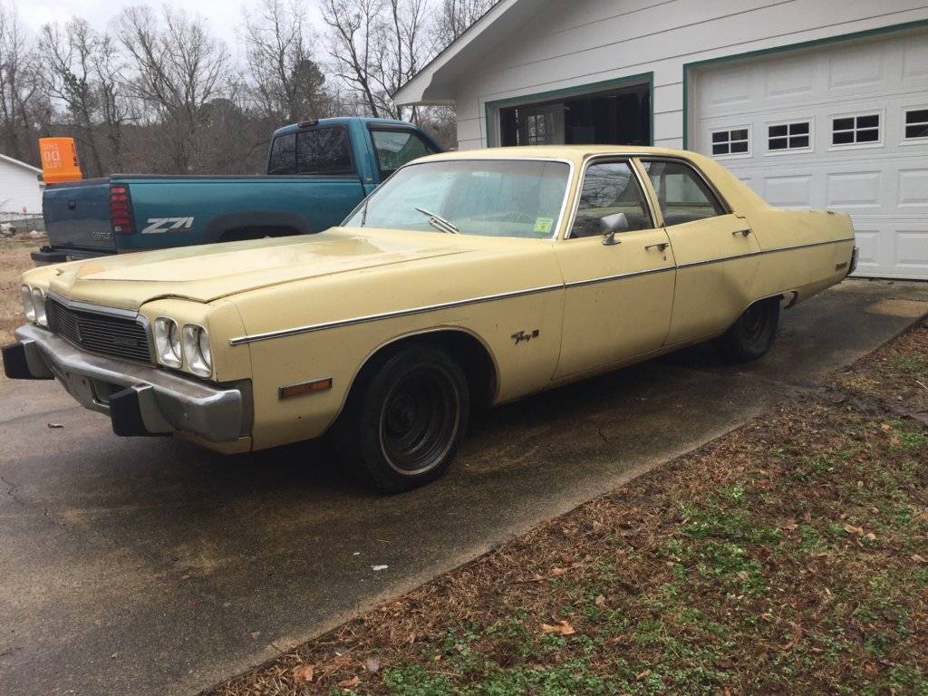

i made a deal on this 73 Fury. The guy bought it just to get the disc brakes off it. Which he text me yesterday that he has done. So I have a set of 74 Monaco spindles & rotors. I just want to fit these good enough to help loading the car on my trailer. I just want to get the castle nuts started good & the tie rods. Then winch on the trailer. So will that work I don’t want to damage that front valance or fenders by dragging it up

What makes you think it's a fine car ?
We are midwesterners, that car looks fine condition-wise. Estheticly it appears as though a cartoon bomb went off in the trunk...
Doesn't appear to have any major rust issues but that doesn't give you the true condition of this car.....

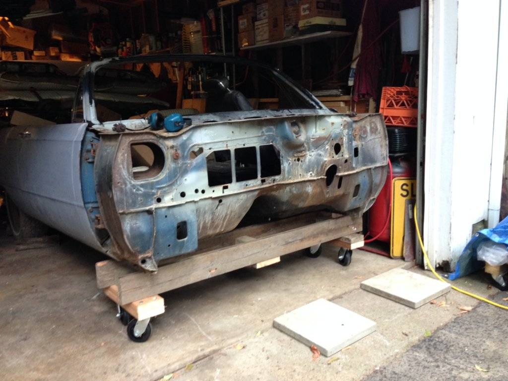

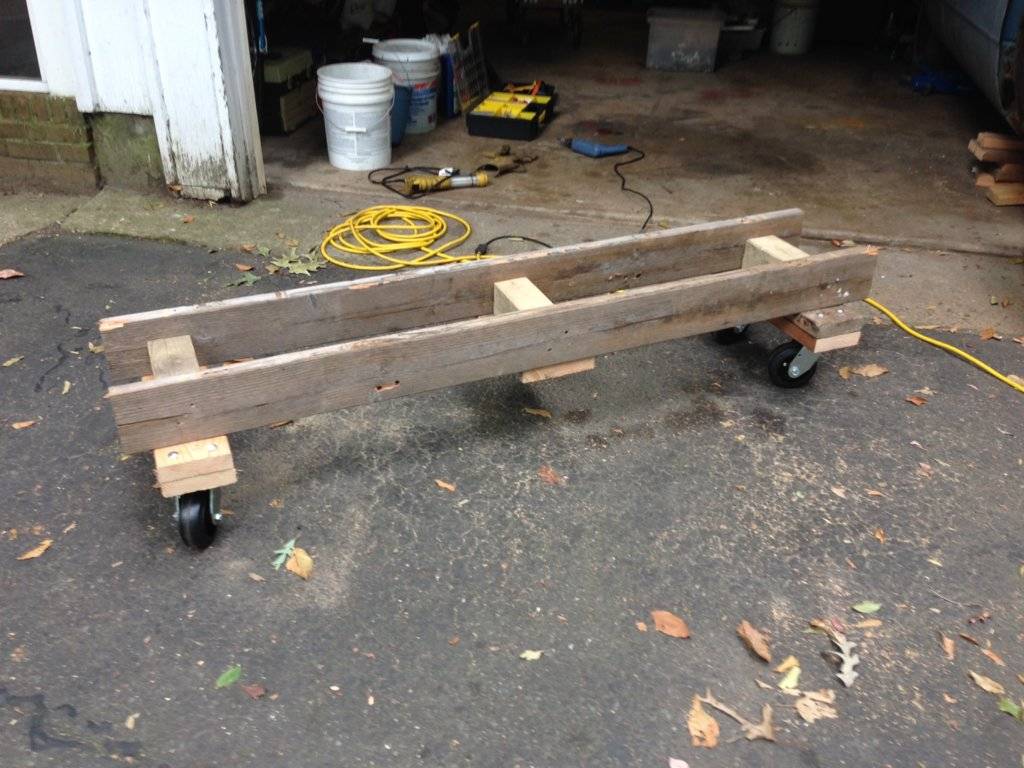

Have to agree with Carmine, everyone is in a mad rush to convert to disks, but if it’s not a daily driver what’s the point? Back to the OP, I seem to remember fundamental differences between the 73 and 74 that won’t let the lower ball on the spindle bolt up to the LCA unless some serious cutting and machining is done. Bob, can’t you just rig up some dollies for the wheels? This took me all of an hour to put together and if fits nicely under the rockers.

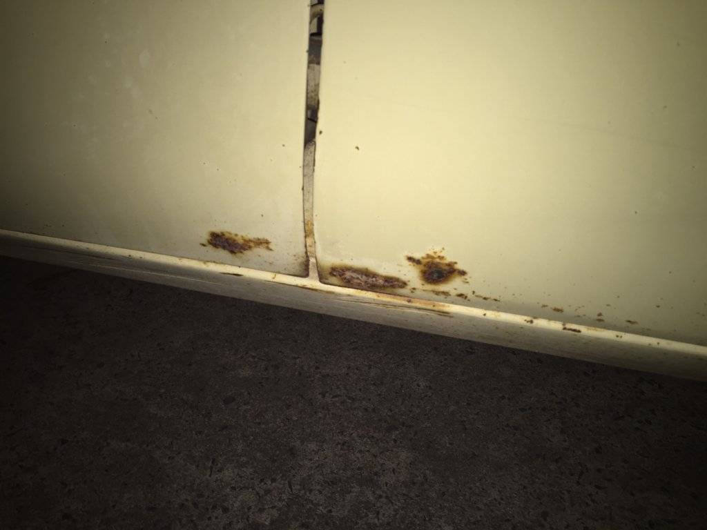

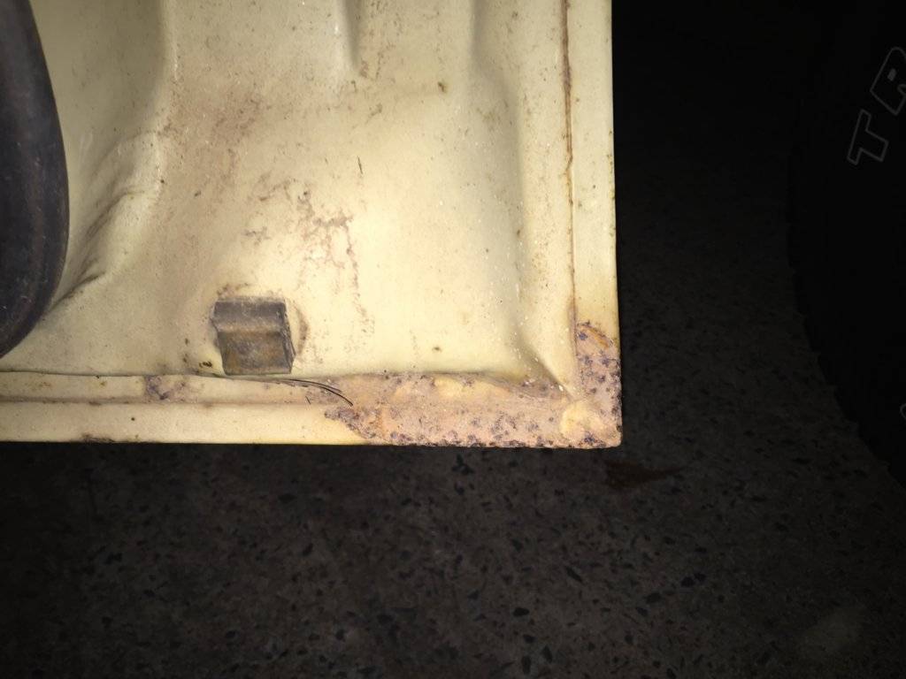

It's disappointing to see that they are rusty at the bottoms, since the driver side doors look perfect, but if the price is right, it won't be a big deal to fix them. Gary would have those welded up and primed in an hour, so I don't want to look like a sissy when it comes to a few little rust spots. They do look very straight, which is a big plus. I'll have to figure out a cost effective way to get them home. I'd probably have to book a load that goes though your area, heading to PA, and just put them back in the sleeper. I'd only have to work around them for one day and one night before returning home.
Thanks, Jeff
$75 bucks for the pair. Gary is going with me when I get the car. Give him a call he just might fix these for you. Then they can be shipped via Fastenal on a pallet.
