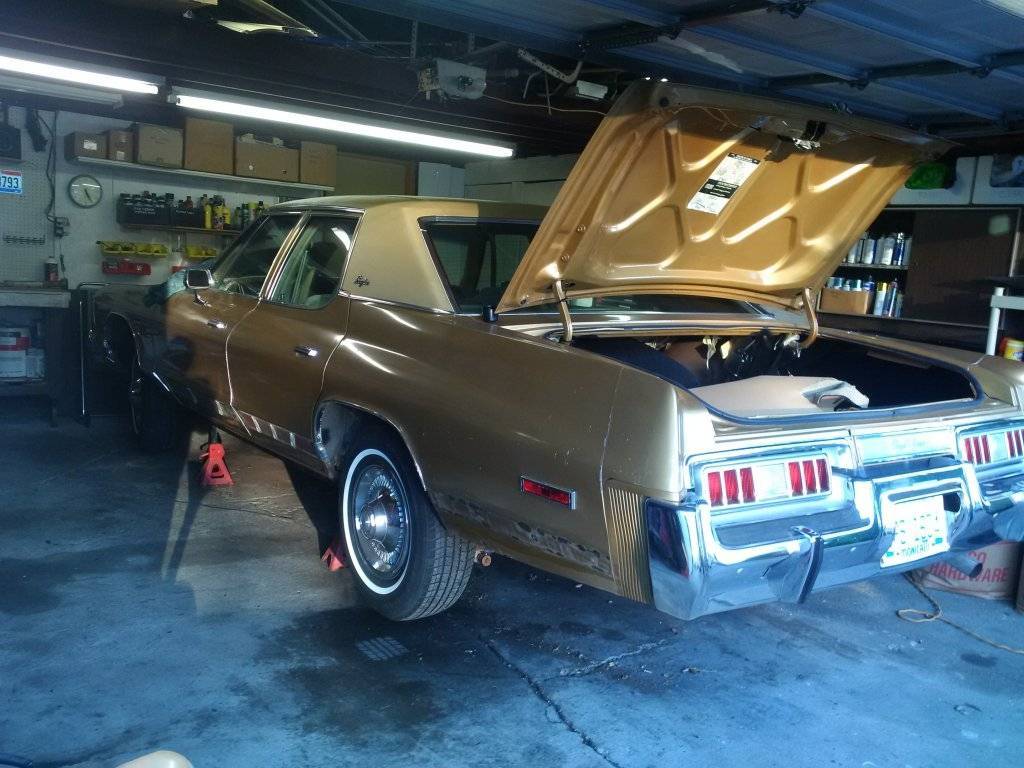

A couple have the bottom left, two have the top left and two are whole. The end caps bolt down so I just get by given this will not be subjected to regular daily use over the years.That bend makes them wagon only. Preserve the tangs you have left as best you can, because you have to re-use them.
In looking at it, it looks like you would undo the end caps, push up on the main panel ( compressing the tines on the bottom), rotate it back off the top of the clip and let it fall off down the door. I will try that on my other wagon.
